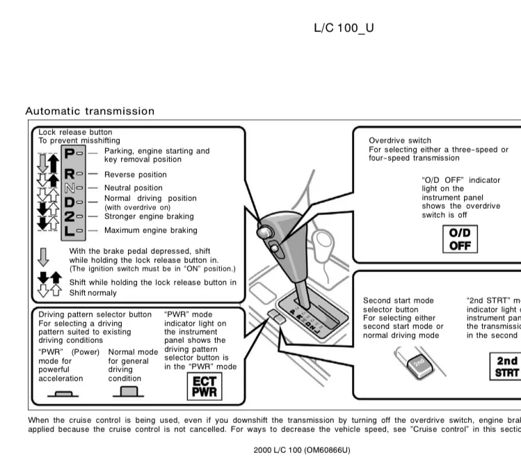

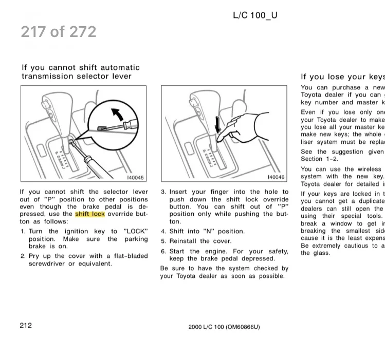

I would try to depress the shift lock override button. But you may need to remove the center console to make sure nothing came loose or moved out of adjustment underneath shifter area.
Unfortunately that button didn't change anything.
