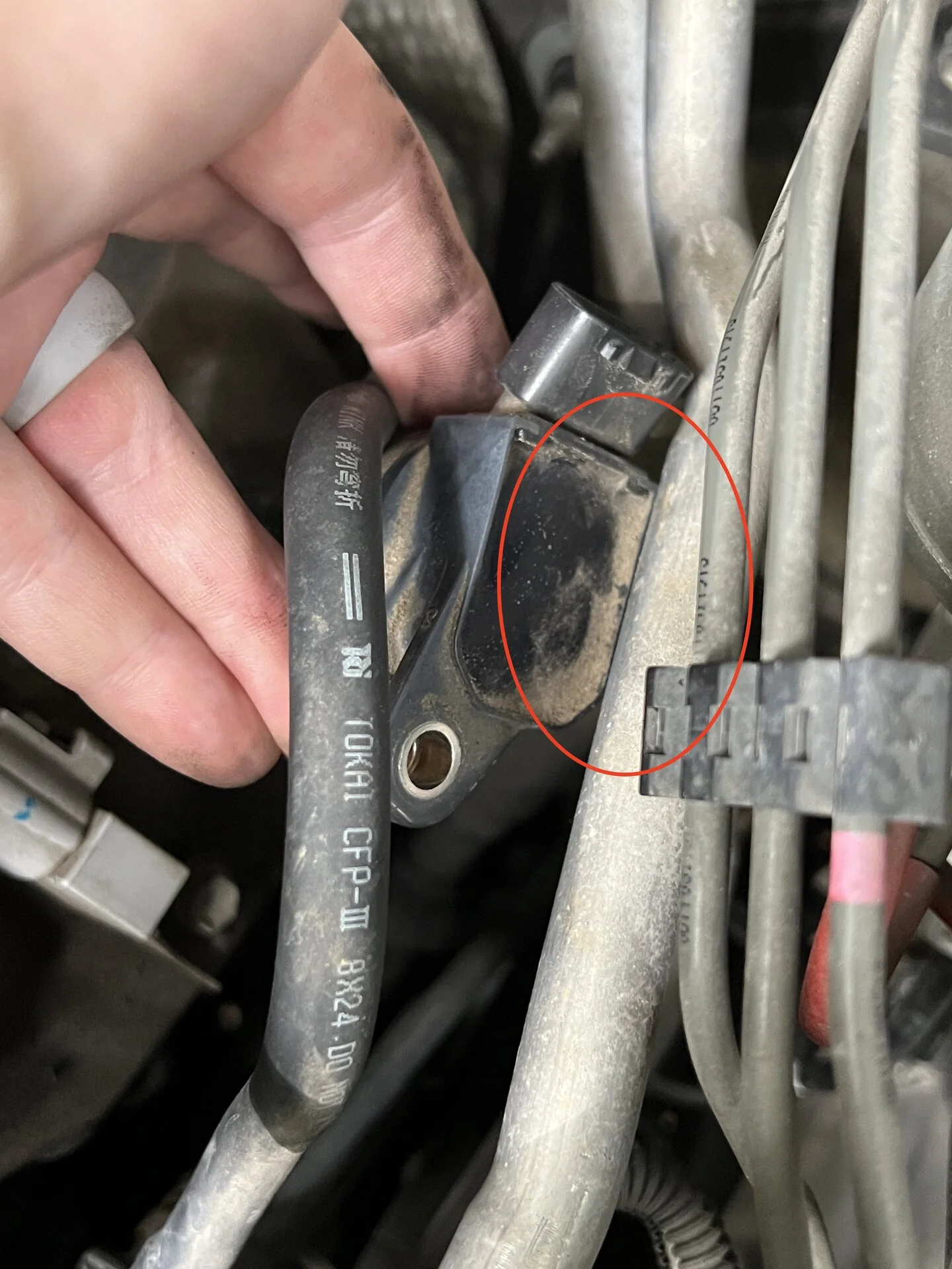

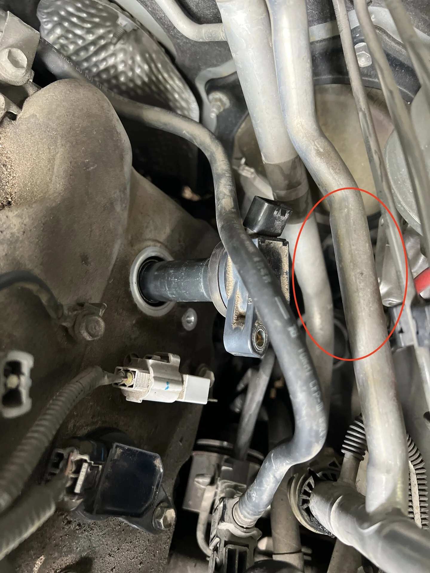

'09 LX. Changing spark plugs for the first time in my life (and probably a first for my LX as well).
I've read the write ups in the FAQ that address the tricky spots on the Passenger Side. However, I can't get the last Driver Side coil out due to some hard lines (cylinder #7 i believe - closest to firewall). I haven't seen this mentioned in any of the other threads. I'm a 2 banana mechanic at best, so I'm not naturally inclined to mess with hard lines without some visual references.
Hmm. I don’t remember that one being an issue? The #8 on the other side sure was though.
Maybe try aiming it down below the HL? Keep at it it’ll come out.
Also. I practiced on the easier to get at coils first, then moved on to the hard ones. To get a feel for their length, how much torque was needed to free the plugs, etc
After tackling #8 on the passenger side, I worked up the courage to push the hard lines down enough to extract the #7 ignition coil. Everything else was gravy.
I thought #8 would be more difficult. I did end up unplugging that massive electrical plug from the firewall. The amazing write ups here are invaluable.
