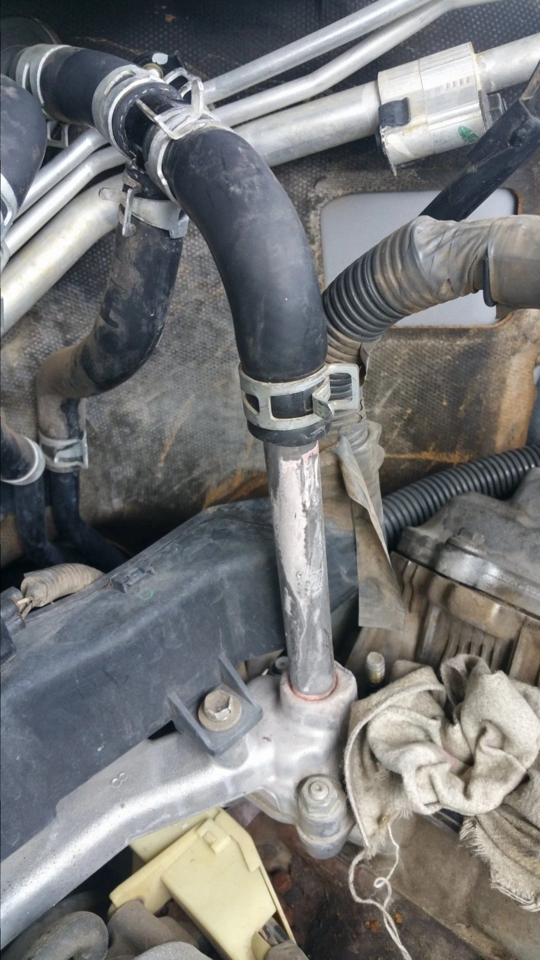

Otoh, I can wiggle this pipe so anything I can do to make sure it doesn't come out or leak?

Hopefully @2001LC can chime in on the coolant tube. I think he's messed around back there more than I have.
Pulling EFI fuse on 01 works for me.
Looks like you'll need a rear water bypass joint! The joint and two gasket ~$100. Your starter problem just may have saved your engine!

Note make sure to drain down coolant a bit, from block. So it doesn't run into open intake head ports when you pull the water by pass joint (rear).
Thanks for all the info, esp the waterbridge- gotta search for this. I guess the pipe is coming loose so only way is to replace the bridge with the pipe attached? Can i have a friend weld alum to this joint ?

The heater hose are good (distorted pics makes it look swolen) and thanks to the thread on the plastic T, I replaced them right before it falls apart in my hand.
