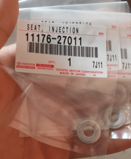

I think my mistake was to use 3 normal bronze washers as Seats Injector Nozzles, like these:
The original should be
I will do this tomorrow and post results.
I would say that is your main problem. The injectors must be a close fit or they let air in.
