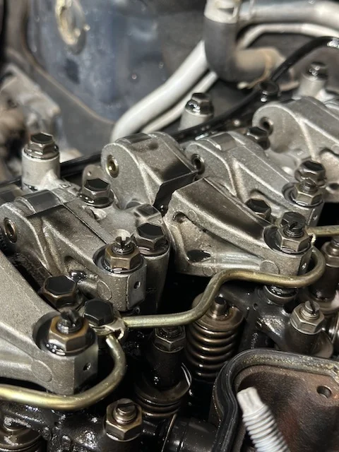

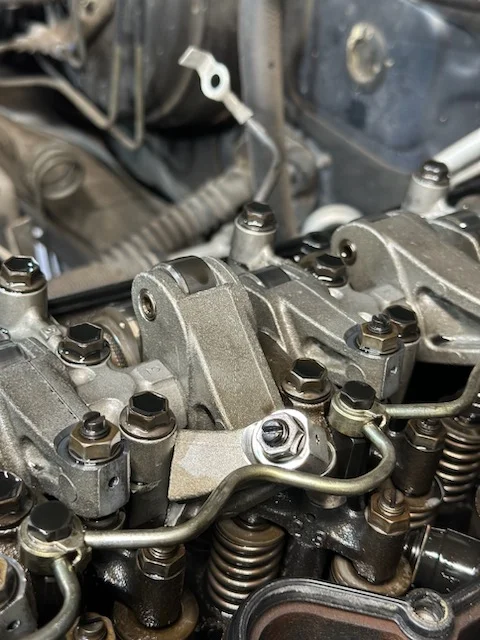

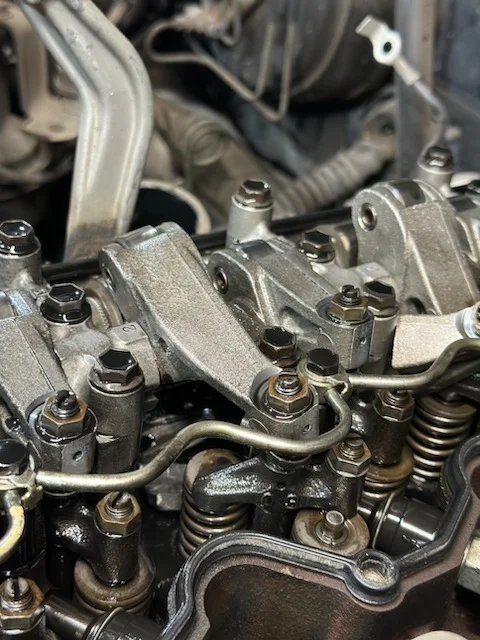

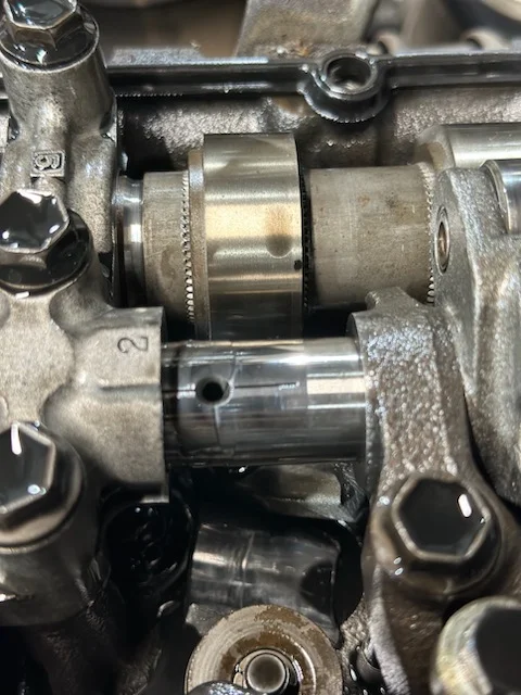

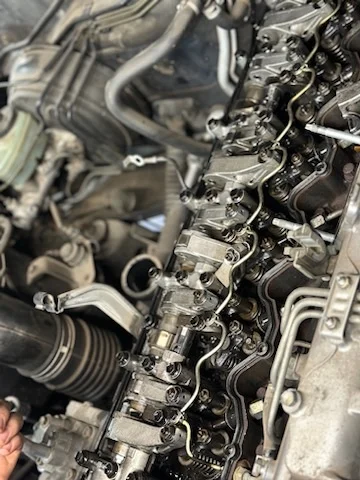

I thought I would give an update to what happened. My HDJ81 suffered a severe catastrophic engine failure when my timing belt decided to jump 3 teeth.
I thought my newly imported HDJ81 was a goner, but the guys at CruiserMatt's in Winter Park, Florida did an amazing job reviving it. Those guys are super knowledgeable. It runs like it's brand new.
Ouch, glad it could be saved. Why did the timing belt jump? Hopefully the root cause of the issue was fixed.
When they pulled the timing cover, they found the timing cover gasket in a bunch of pieces. What they thought was a chunk of the timing cover gasket got pinched between the belt and caused it to skip timing. 😟
Holy hanna, that was a lucky break.
