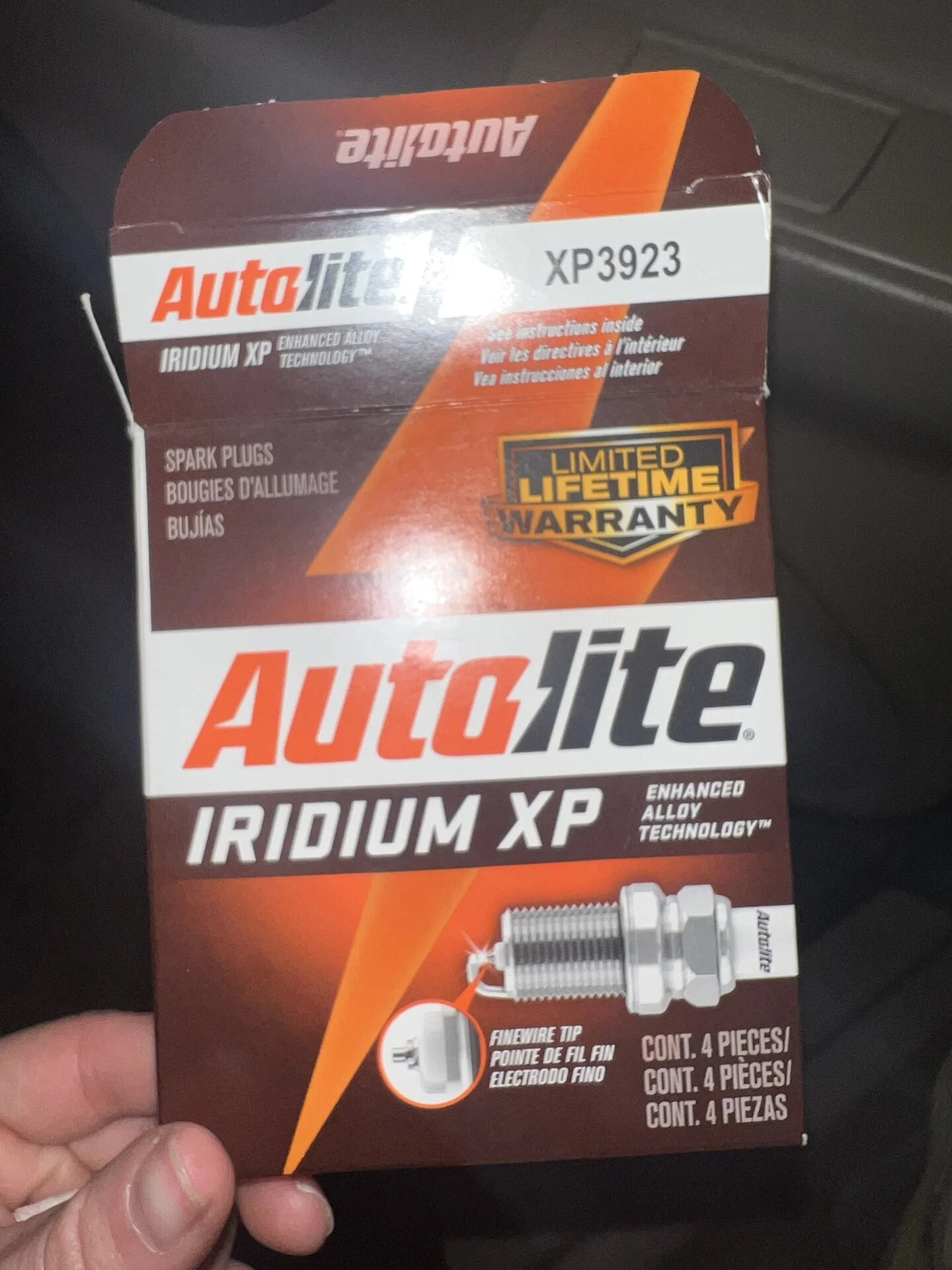

The spark plugs were Autolite
The coils were Duralast.
Not OEM… might also be our problem://
Pictures of the two added below.
I run Autolites in my Kohler K241 flat head. But I would never run them in a 2UZ.

Be prepared to replace all your coils again with Denso as well as plugs. And triple check you do 18 ft/lb on the plugs with no antiseize.
Agreed - avoid non-Denso ignition parts on your UZ. As much as I dislike Rock Auto, that's the cheapest place to get them and they are probably cheaper than the Duralast ignition parts. I think they are around $50 a pop.
