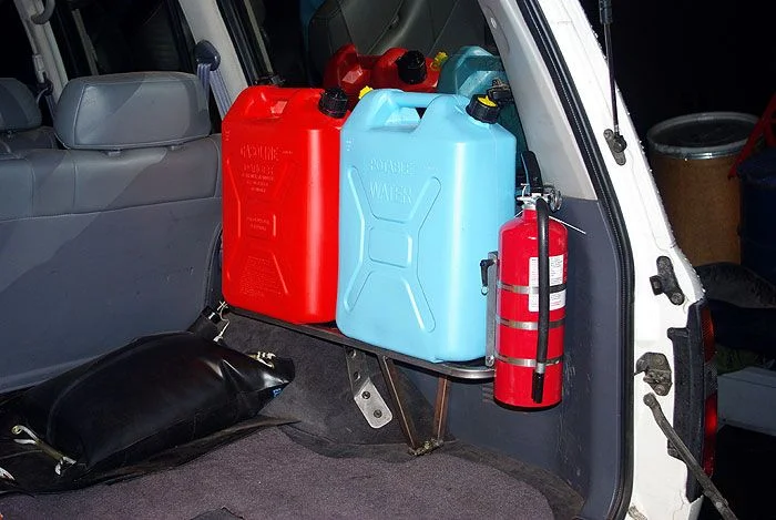

So, this begs the question, (and perhaps a little off topic, sorry) how do you carry them inside? Do you have a fixture/mount or do you just wedge and tuck them in with the fridge/stove/recovery gear etc.? I know when I go camping I have this great stove, but I also need to brint my 5 gal propane tank and that thing is a hemroid to have to pack because of it's round shape. That's how I have to travel with it, stuff and tuck wherever I can get it to fit.;) (And then try to remember how I packed it for going home...)

Inkpot's holder, but his is an '80. They are held by ratchet straps, not going anywhere, well not in a survivable accident. :hillbilly:
