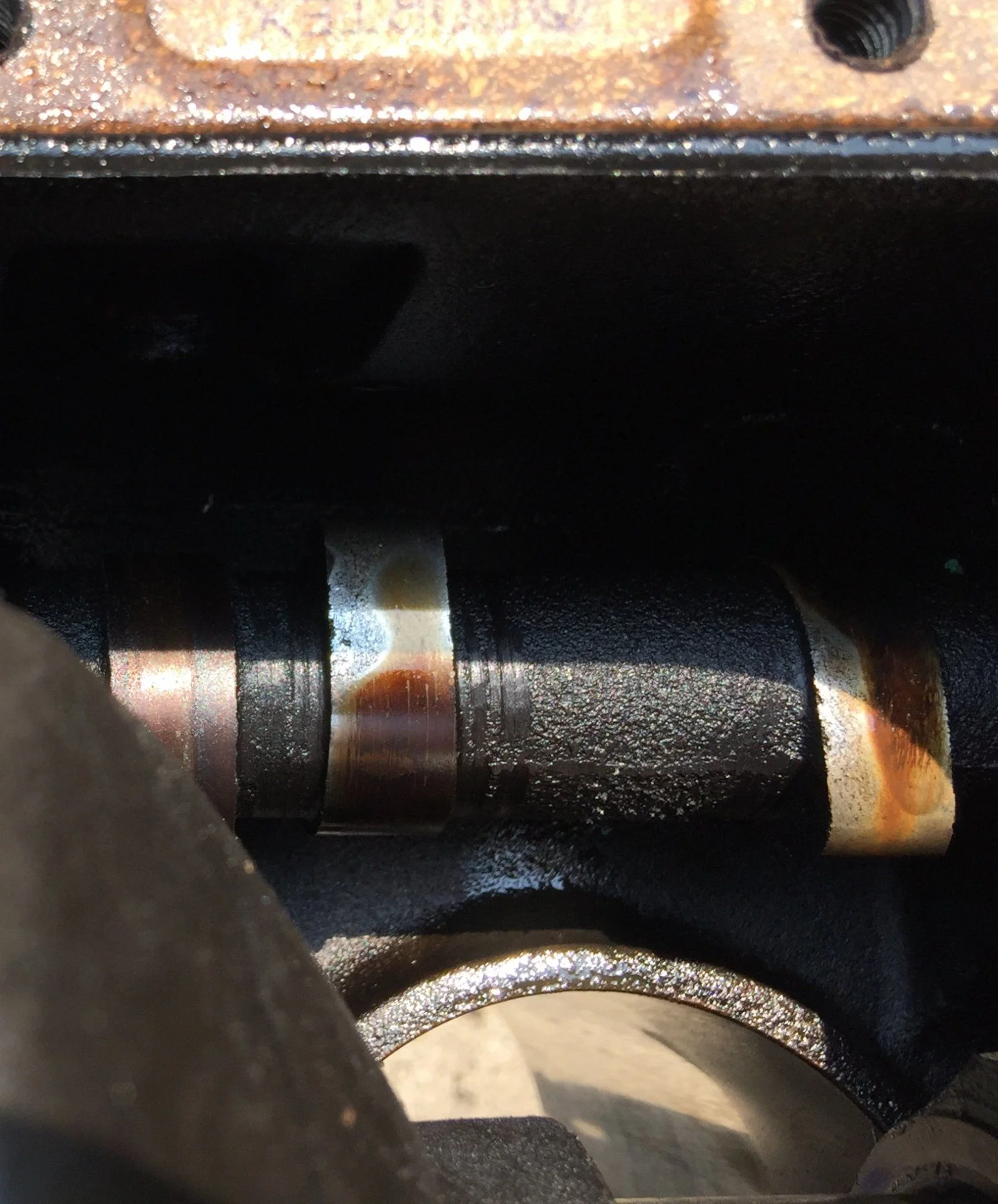

Did you have your lifters ground and resurfaced with the cam regrind? They may be concave or worn on one side. The lifters don’t line up directly on the lobe...they are slightly offset against the cam to push the lifer a few degrees of rotation once the lobe reaches TDC against the face of the lifter.
The picture is of an F we got into a while back with unknown mileage...lots of miles actually.... you can see the wear pattern on the cam....the dark areas are non contact...the ‘hammered’ (work hardened) areas are the lobe to lifer contact area.

Thanks, Mark - I noticed your reply just after I posted last - I did have the original cam reground and the lifters too. Thanks for the pictures, when I get the side cover off they'll give me something to look for!
