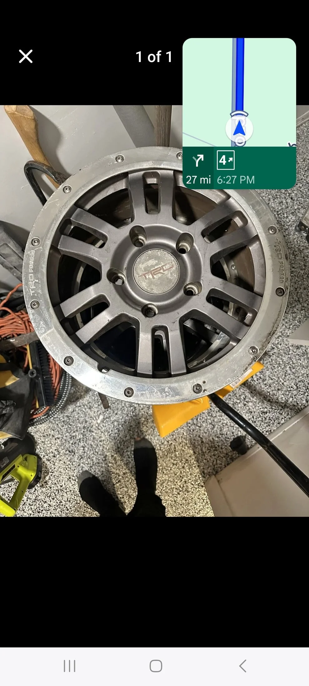

I found 4 rock Warrior wheels.have some scratches but only wants three hundred hours for all four. Is that a good price?
I have a 2010 lx570 with 18 inch Land cruiser. Wheels currently. Any one regret putting those wheels on Are they hard to balance or anything? I would put a tire on that is equivalent in size to my current 275/65/18
Assuming that's a typo and you meant $300. If so, $300 for a set of 4 rock warriors is a fabulous price even if they're completely hammered. One of the toughest and lightest wheels you can fit on a 200. 285/70r17 is the size recommended by Toyota, which is about 1/2" bigger than what you've got. Should fit up with no problems.
If you decide to pass on these, post up contact info so other local mudders can snag them.

Thank you. Is the offset different than the 18 inch cruiser wheels I'm running? I have spidertrax Spacers on there currently to bring the tires flush
Inspect the inner lip very closely for cracks, especially propagating from dings in the very edge of the lip. These wheels can develop cracks depending on use.
What year 18-inch cruiser wheels? 08-15 is +60, 16-21 is +54 (IIRC). Rock Warriors will be +50.
You'll need to get the overpriced splined lug nuts.
And the special socket. Which shouldn't be touched with an impact gun. (but I do anyway)
And be sure to keep the very expensive button head screws torqued, or they will fall out.
Oh and the center caps are no longer available, anywhere (unless you want to pay robbery prices on eBay).
They suck to clean the dirt and mud out from behind the ring.
Other than that, they're GREAT!! :p

I think they are 2018. Thanks

I’ve seen a new part that dealers on eBay say supersede the old cover. I was going to order one during the parts sale to see if it really is the same. It’s only $17 during the sale.
Also, as @bloc said, as long as they aren’t cracked, they are great. Mine were as beat up as these and I put new center caps and rattle canned them back to a color close to stock and they look great from 5 ft away. I didn’t care to make them any nicer.
If you can’t get the rings off, you may have mixed results on whether people say they can put tires on them. I can’t get mine off, but my tire shop had no problem installing the tires.

For cracks are we talking along the edge of the wheel that meets the rubber? And I'm assuming you mean on the lip that faces in or the lip that is under the beadllock ring? Thanks. Picking them up tomorrow
I noticed a better ride going from my original 20 inches to the 18. I'm assuming it should ride even better with the 17? Does it play nice with the ahc system? I don't see why it wouldn't.

I am very interested to hear about these, my center caps look like crap now.
I had several screws fall out on their own last fall. I removed the rings to keep them out of the winter weather and salt, meanwhile ordered a package of new screws. I actually like the look without the rings, I just may leave them off for now.

Very possible this is a similar but not the same part. I have not verified if it fits. This may be the cover for the 6 lug wheels, and possibly are a different size.

The inner lip, where there is no rock ring.
Cracks will propagate from the very edge of the rim where it contacts the rubber sidewall. The whole crack may only be 1/16-1/8” long, but if so it won’t stop there.

Thank you. I'll check that out
