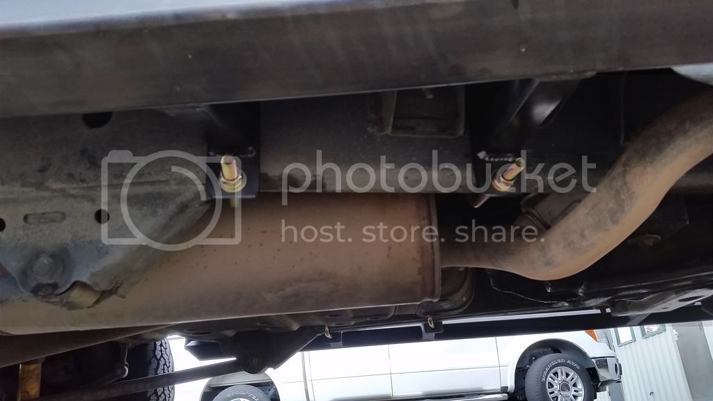

I have the OPOR sliders from Metaltech4x4. They came pre-drilled with hardware. The front bracket is farther forward, the rear ones are closer together, see photo below, thats driver side just below bumper. So the mounting points I used will not help you, I am afraid. The passenger side (the lower one in the pic) has a big plate that bolts right up to frame bolt holes, and then 2 u-bolts on the rest.
In your position (I am with you there, not a metal worker at all), I would find a metal shop willing to mount them, I am not familiar with the brand you bought.
If using u-bolts on the frame, make sure you don't pinch the brake lines that are hard to see, they hug the frame and are held with plastic clips. move them away from frame to sneak the bolt in.

The rear mount is behind the bushing, again driver side.

On the drivers side frame rail, watch out for the brake lines. You will need to unbolt them to slip in a plate or u-bolt and then make sure they don't rub on the newly installed brackets.
