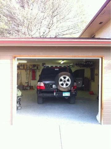

I had a few PM's asking for more pictures of my Rhino Pioneer Platform and I finally had a chance to get some this past weekend. I got it direct from Rhino and Joe, John and Deb were all great to work with. My system includes the following:
100 Series Leg Kit - RLCP02
Pioneer Alloy Platform Rack - 42104
Foxwing Awning Left Hand - 31100
Foxwing Bracket - 43100
Eye Bolt Kit - 43106
Luggage Bag Half - LBH
It's a great piece of kit and I would recommend it to anyone who is looking for a flat platform rack.

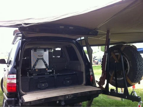

i really like the idea of the foxwing, but can buy two 2.5m ARB awnings for the price. I also spend a lot of time sitting on the rear hatch, can you open it with the foxwing deployed? it looks like it might interfere.
ckkone said:
Rear hatch can open fully and does not contact the awning.
You probably have yours mounted slightly differently. I mounted my mounts "upside down" so that the truck would still fit on the garage. I think it looks better too IMO. Their gate touches but does not interfere. standard highlight also touches. I'm going to search for a nice soft rubber cap to prevent tears.
