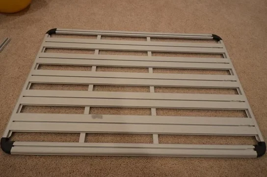

Here are some pics of the rack unmounted. Fit and finish are very good and the thing is stout. One thing that drew me to this rack was the riveted design. If I do lay it over on a tree or a rock it will be much easier to repair than a welded design. Also I like that the rails run lengthwise instead of crosswise. Just make sense to me for some reason. I can see advantages to both but for what I will use the rack for I think this will work well. The only thing I really still don't like are the plastic corners.

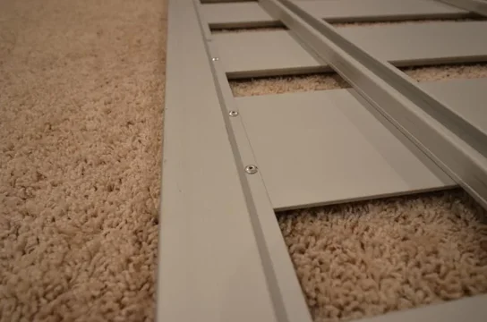

jon, turn it over so we can get a good look at the slotted rails.
The dark spot is an imperfection in the finish, I'm a little upset that something like that would leave the factory at this price point.
The wide part of he slot is a little rough around the edges and could use some refinement, the narrow channel is very smooth.
The rear of the rack does not have the wide slots. All attachments must go through the front.

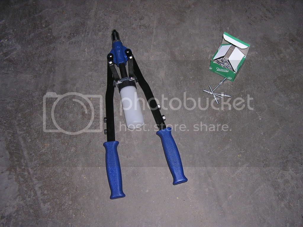

I have a friend with a pneumatic riveter so it will be butter.

The Rhino's cross bars are oriented opposite of the frontrunner. They run lengthwise along the truck, I cant speak for all models but part#42104 (84"Lx56"W) is as follows:
Bottom of Rack:
The 1st, 3rd and 5th rails are adjustable by 1/2" from center. The 2nd an 4th are riveted. Once you get the measurements from your truck dialed in you rivet the 1st, 3rd and 5th into place.
Top of Rack
All inside measurements were checked and are the same.
