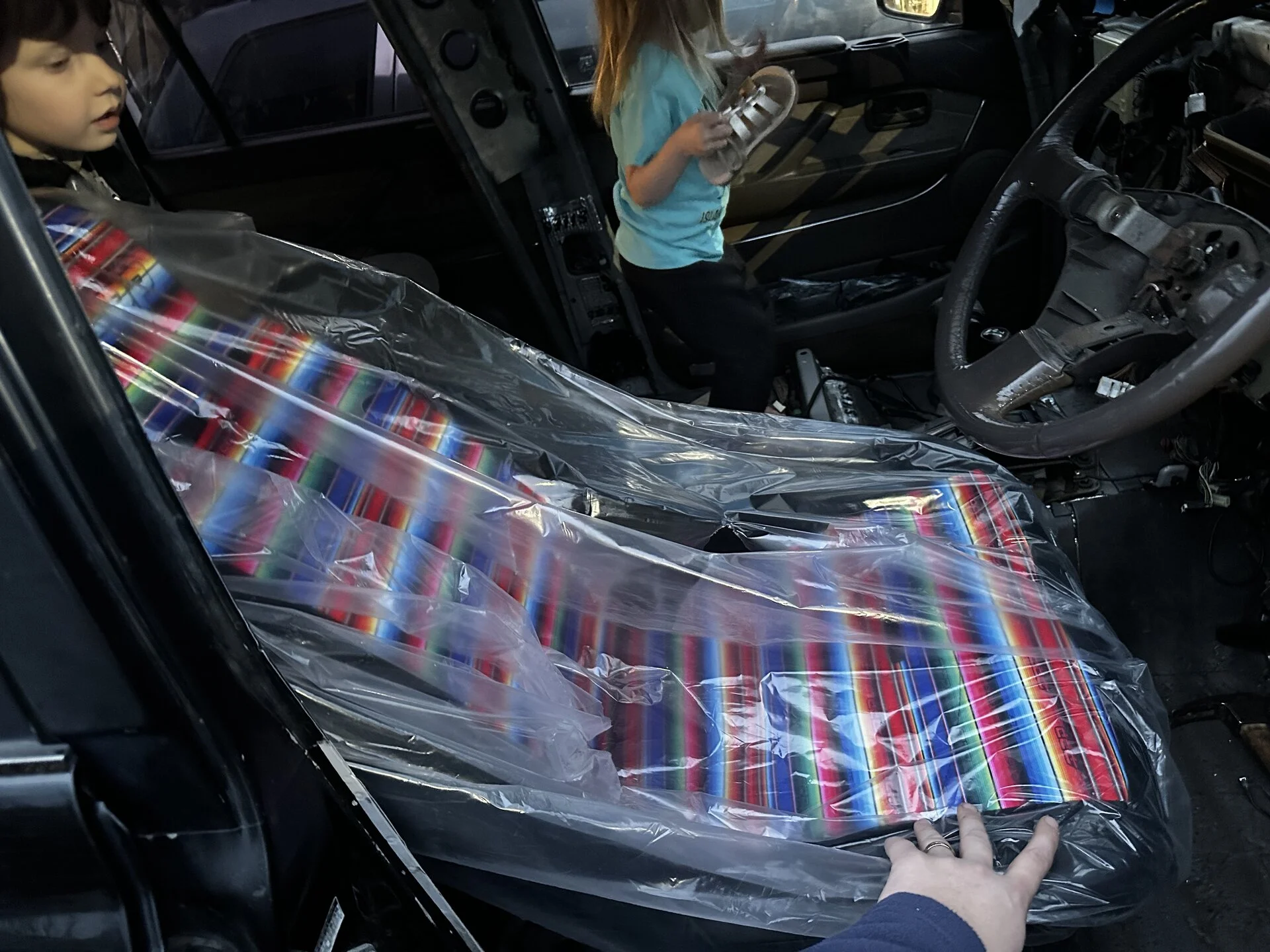

With the roof all welded, painted and headliner in i had a big sheet of thick plastic I through over the cage I then raised the cage into its final position. I tack welded it into the floor and a few other spots to keep it in place. after that I took some time and trimmed the plastic in and taped it. I won’t be lowering the cage again so I’m trying to protect the headliner.

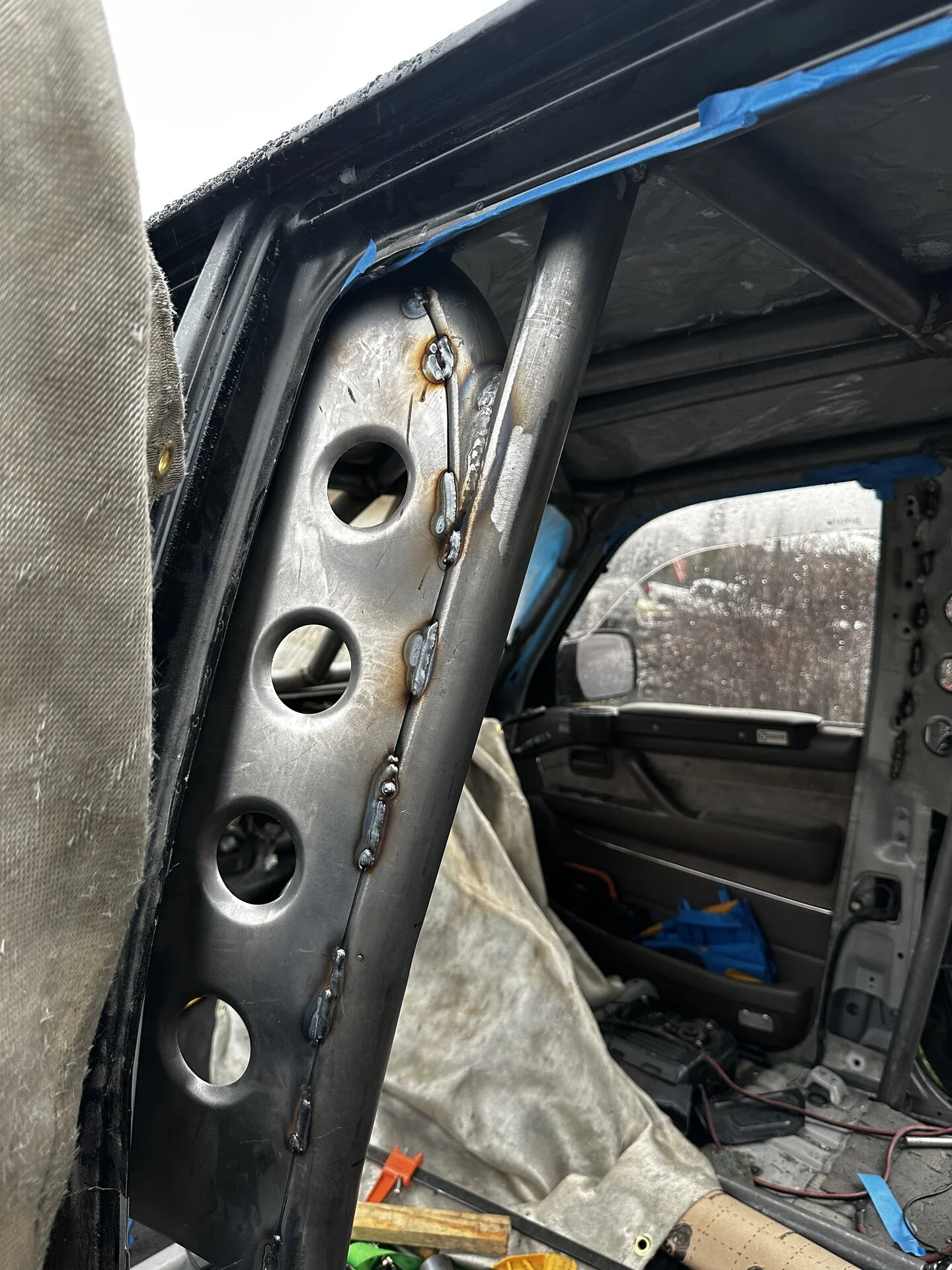

Since the plan now is to fully attach the cage to the frame and the body I decided to go ahead and throw some dimple die body tie ins in.

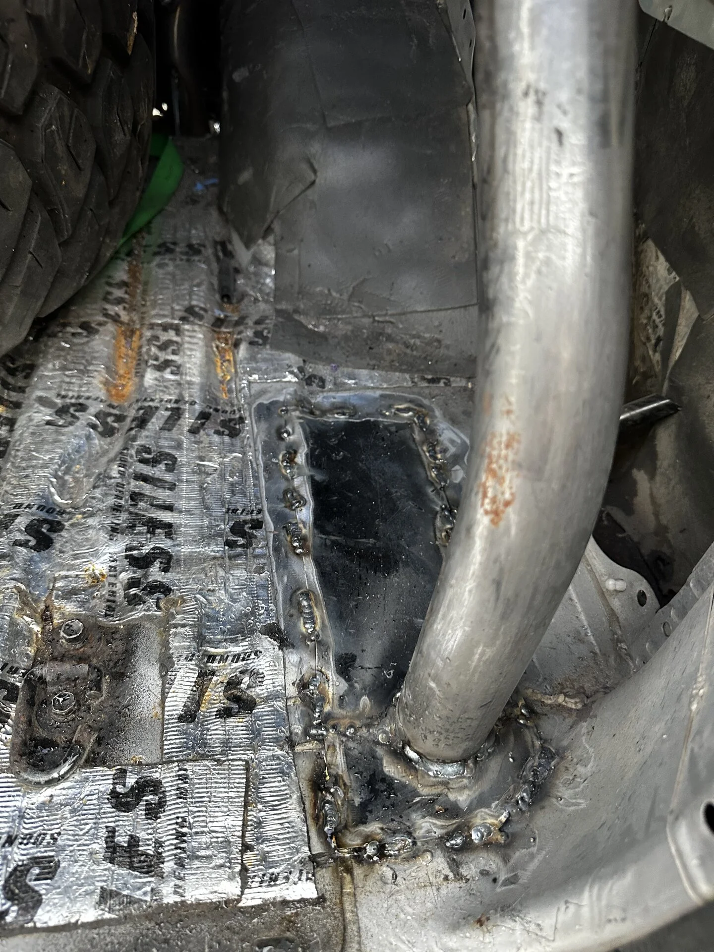

I then went to the C pillar down bars. I’ve mostly seen people run these into the tops of the rear fenders. I’m not really a fan of that although it’s hard to do anything else. I ultimately bent the tube around the fender and strait down into the frame. But I wanted to support that bend. I do have a 1/4 inch plate on the fender and a tube going into that otherwise it would be a huge week spot. Once I get fhe X bracing in I may gusset this area as well. I want to direct most the force into the frame. In the event of a rollover.

I also added a bit more support for the C pillar where it makes that bend around the fenders. One day that will likely all get cut out and tub the rear but that’s a project for another time.

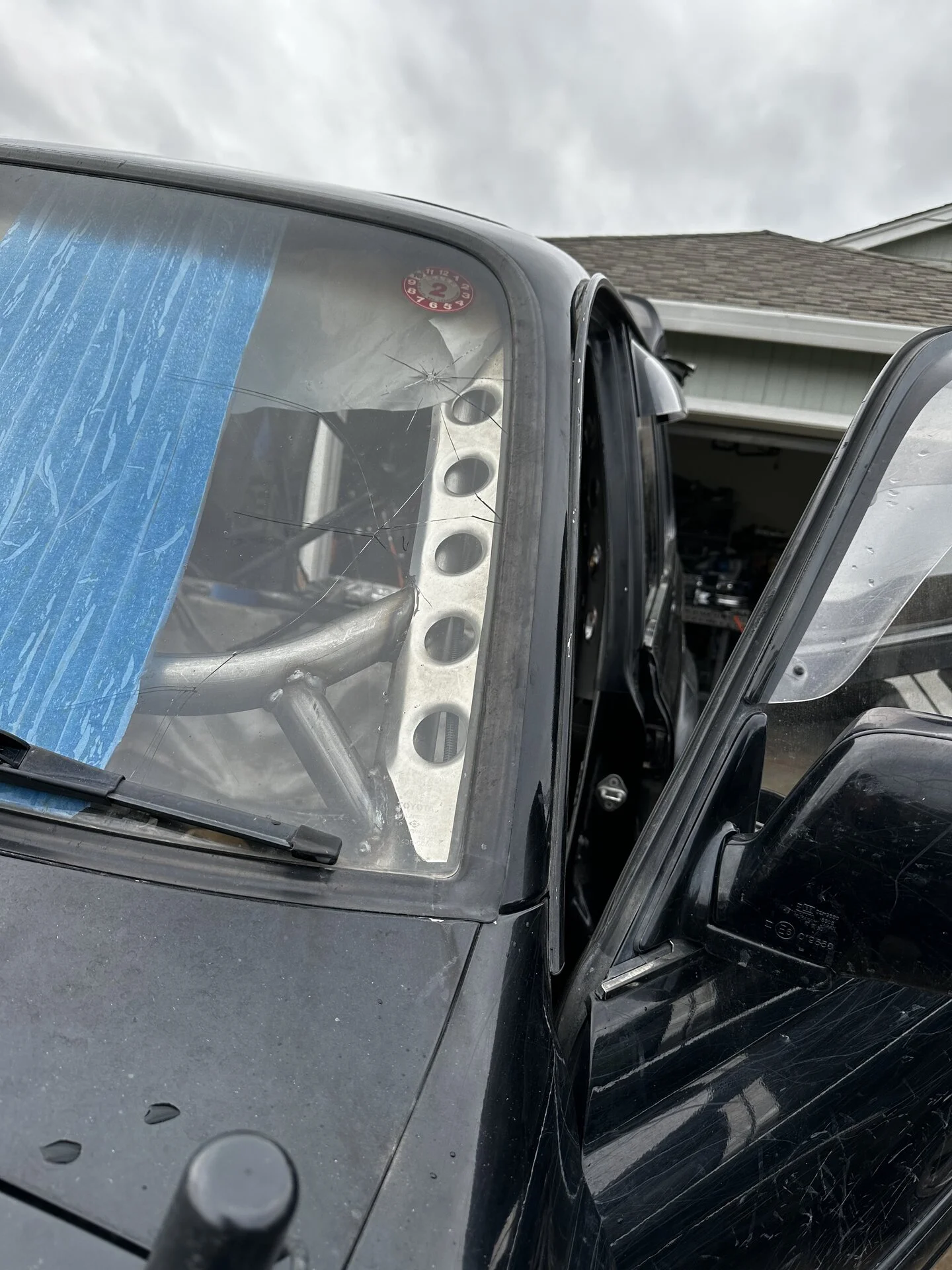

Then I did dimple die body tie ins in the A pillars and the C pillar roof area tie ins can be seen in the previous image.

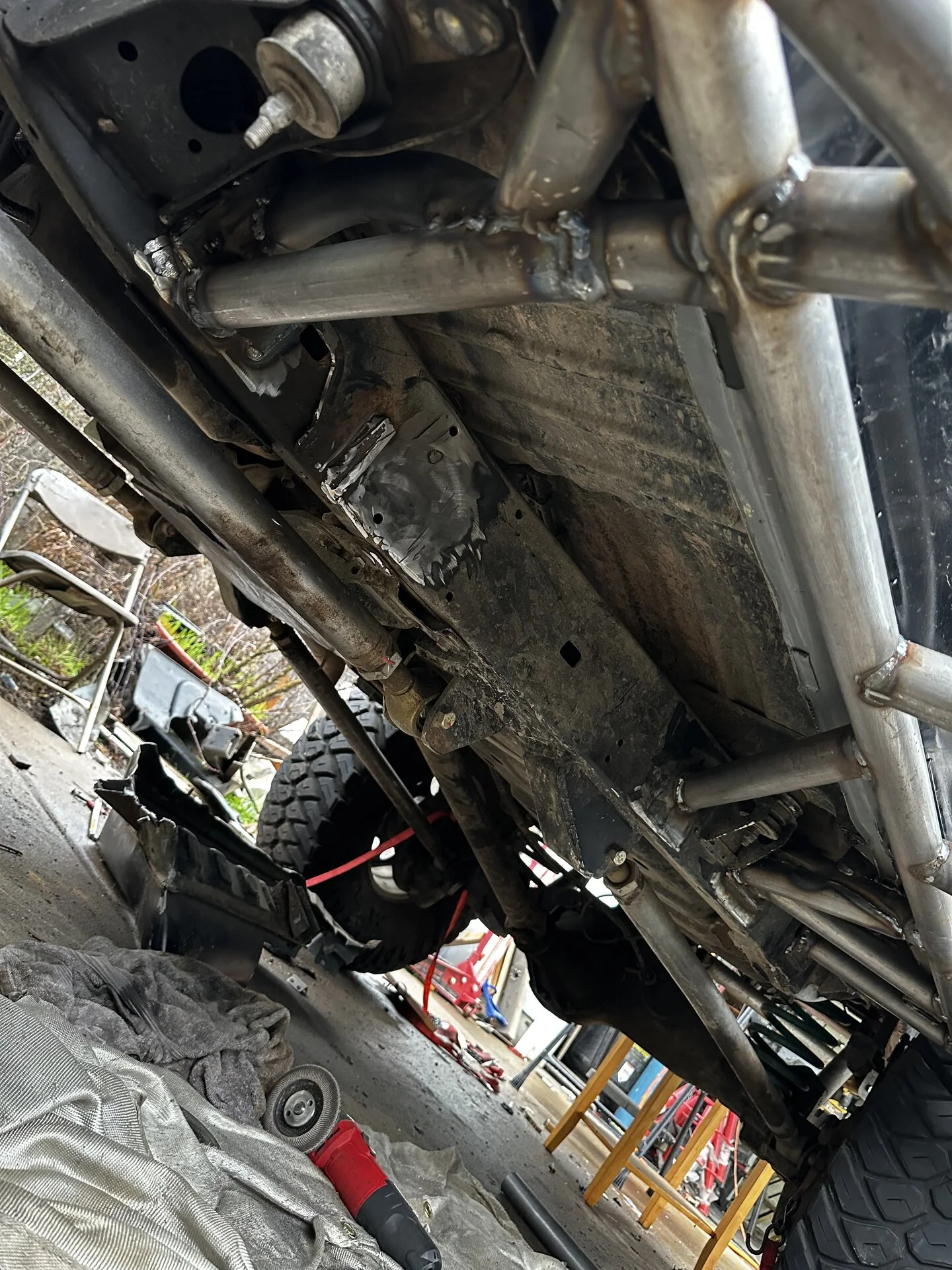

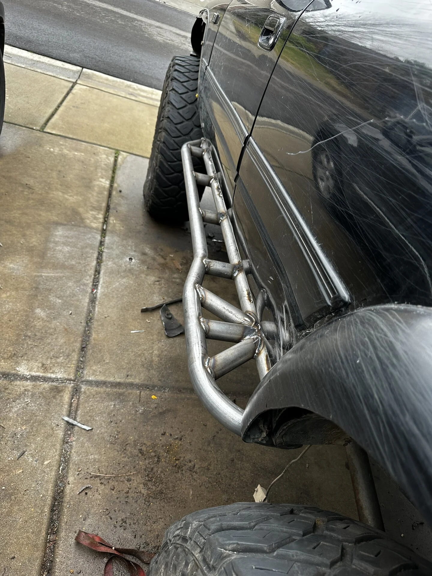

For frame tie in I’m building them off the sliders and and I’m tying those into the body. My rockers were rusted so I also did the rocker chop.
I went with a kick out but a gentle one. The old coastal sliders were abrupt enough they caught on rocks and were an issue. I was actually considering buildikg boat side sliders. But after a couple trips through the rubicon I seen how much of a Benifit kick outs were. I hadn’t used them to pivot off rocks much before then. . I may have overbuilt all this a tad.
Frame plates are 1/4 plate. A pillar is over built having 2 tubes supporting and gusseting it the B pillar had a tube running from the slider to the frame with a slight upward bend to create a grown then a long gusset supporting the whole thing. Then all this is again welded into the body. Then the middle and very back has a tube supporting the slider. I was a bit paranoid of having anything bend causing the door not to open when I only have .5 inch clearance. Should be more than stout.

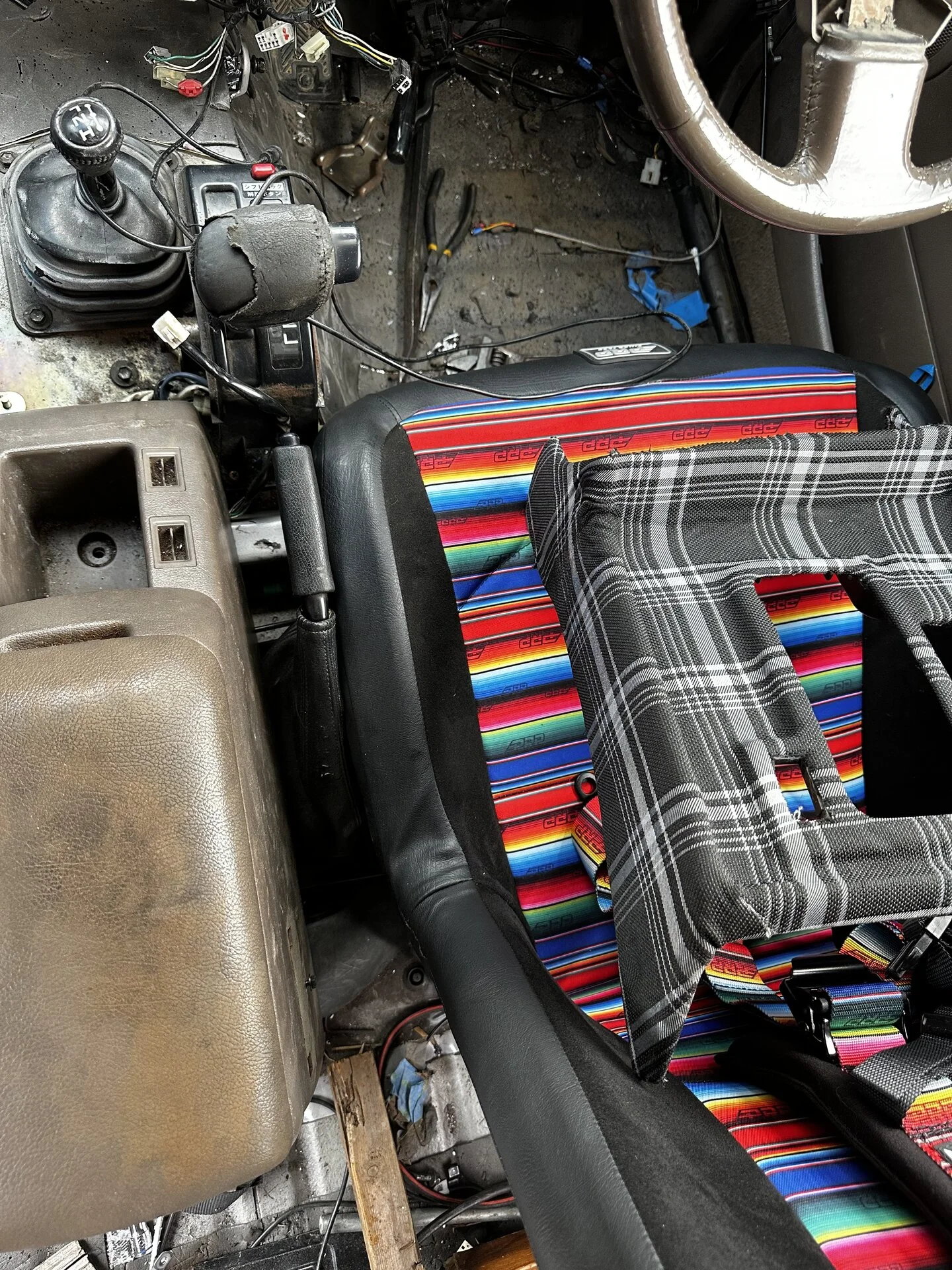

So these are daily driver seats from PRP. Both are +2 wide and mine is +2 tall. My wife shoulders were perfect for the standard seat so I just went with different size seats since that will fit her better. The seats are all mounted and I finally was able to start on the seatbelt bar. The front seats are all custom mounting points. I also had to smash that rib the seats mount to and goes over the trans tunnel flat up front. They need welded up since they are all tack welded right now but I’ll do that once the rest of the cage X is tack welded in place and I remove the seats for finish weld what is left. then paint!
Worth noting I had to slightly bend the Ebrake handle over Twards the passenger for clearance too and the shifter counsel will need some trimming. Ultimately +2 PRP seats are very tight and will require custom work.

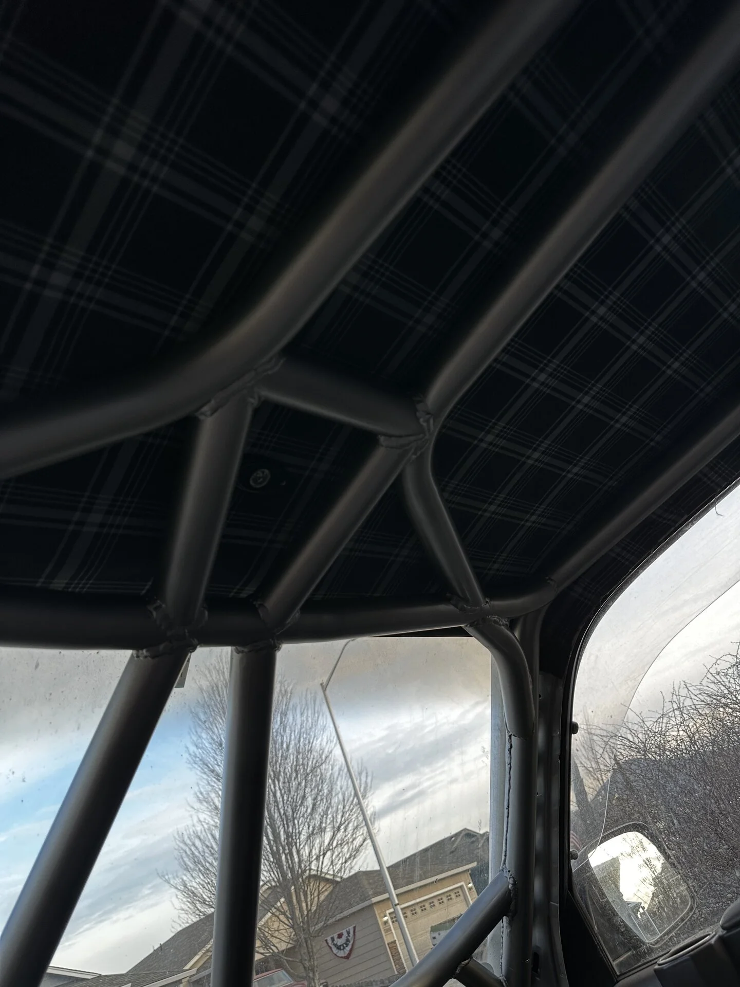

Alright I’ve been busy since last I posted. I finished the cage up and painted it. The removed the plastic covering the headliner and started assembling the interior. I trimmed the carpet around the tube which is easy especially since I’m my early carrier I did carpet for a living.
Part of the interior was seat mounts. The rear seat required the most work. Used 1”dom .120 wall tube to go between the mounting tabs on the PRP seats and some 1” square tube that’s thinner wall for bracing. Front tabs are 1/4 plate and the rear is cut up 1x2 1/8 tube that I then gusseted.
The factory belts work with the rear seats as well.
I proceeded to installs most of the internal plastics I changed colors on along with seats and harnesses all of which are PRP. I painted the rear cargo lower plastics and used the headliner for the rest. All the other plastic either has headliner material or is wrapped in a black leather.
