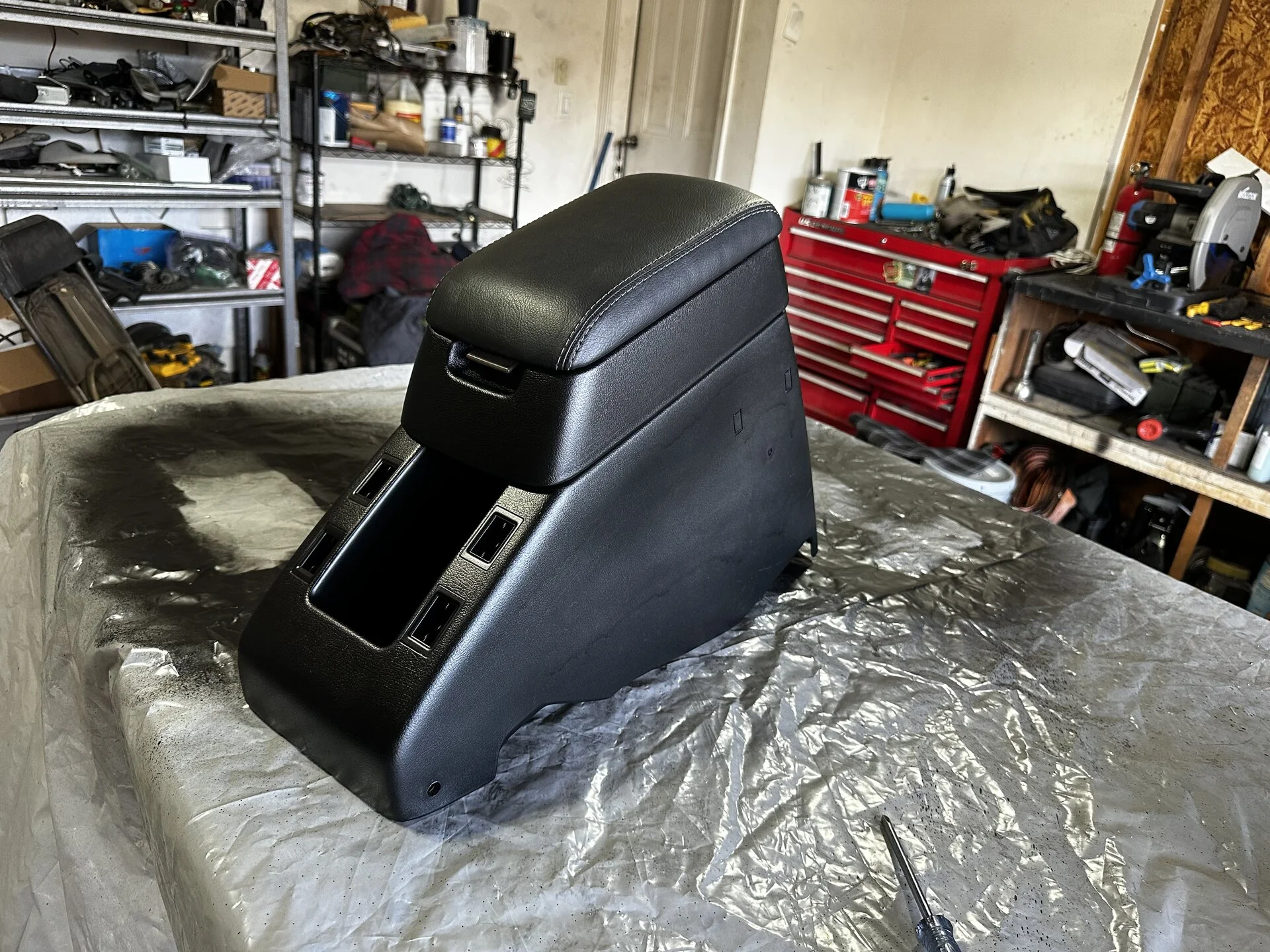

right before last weekend I came home from a work trip and got into the remaining interior that needed assembled. I found on eBay a wrap to go over the center counsel top. The cover was kind of a pain to install but I ended up using some contact cement to keep it all in place and not lose. but I wanted to change the rest of the color of of the counsel. I’m not sure it will hold up but I bought some interior paint in black. I used this for the trunk plastics and the steering wheel center and liked it so we will see how it holds up.
I also needed to block off the open din from the single din head unit I bought. I made this from some aluminum I have and then used some 3m VHB to attach it. I also painted it with Seymour 316 stainless. I also stuck my radio face to this block off plate once it was assembled.

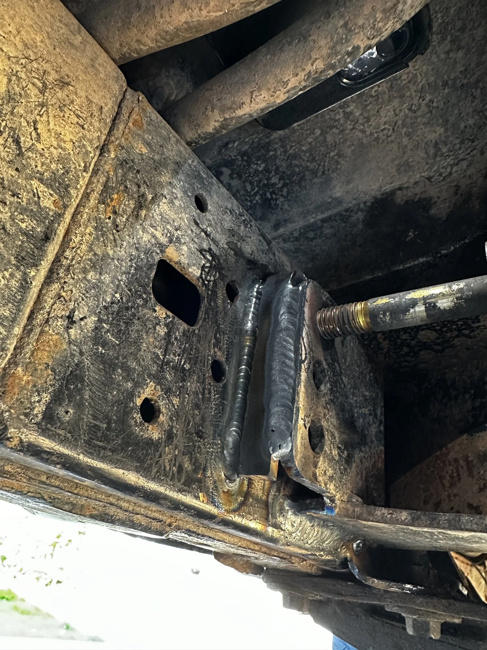

I’ve done quite a bit on the cruiser since the last update. While servicing link joints I found a tiny crack in a weld starting to form. I’ll admit it was a terrible weld but I caught it at maybe 1/4 long. So I ground it out and welded it back up then supported the front of the link mount.

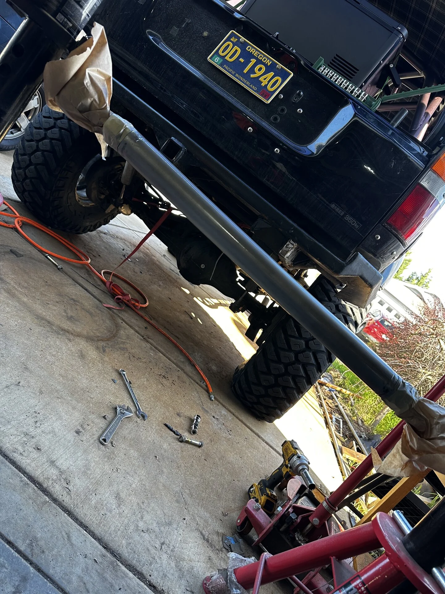

I also bought part time hubs and welded up the rear of the center diff to turn it into a spool. I started by doing a few root passes with my Tig machine then fill passes with my mug welder.

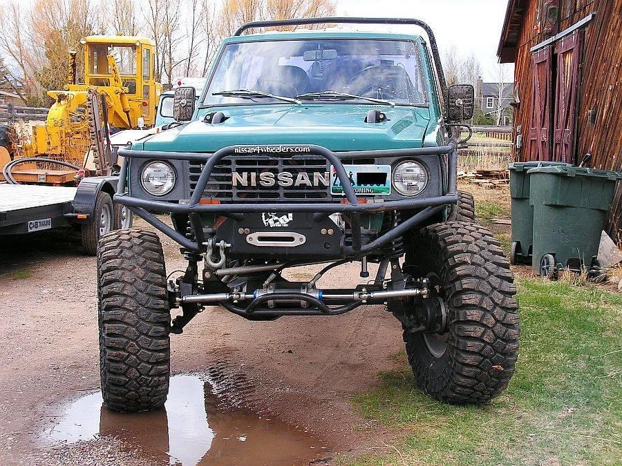

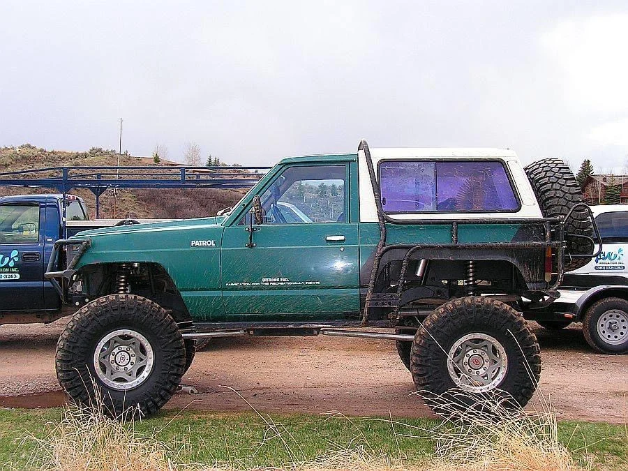

16” coil overs are massive!

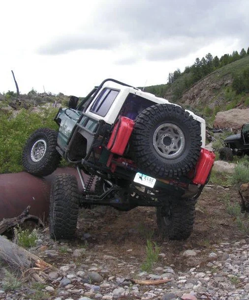

Thats was my Patrol crawler 15yrs ago on 16” c/os. 40” rubber as well. The portals made it tall and keeping things low with a full bodied rig is tough. We also boxed in the rear body (wheel wells) with the c/os. Flexed absolutely awesome though, thats only about 1/2 way there in the flex up pic.

That’s amazing! I’m sure I don’t need 16” and it’s probably a bad idea but I’m obsessed with the idea of having lots of up travel and droop so I can go fast and have all the droop crawling. But I may change my mind it works super good now with 14” of travel even when it drops a coil from the perch
