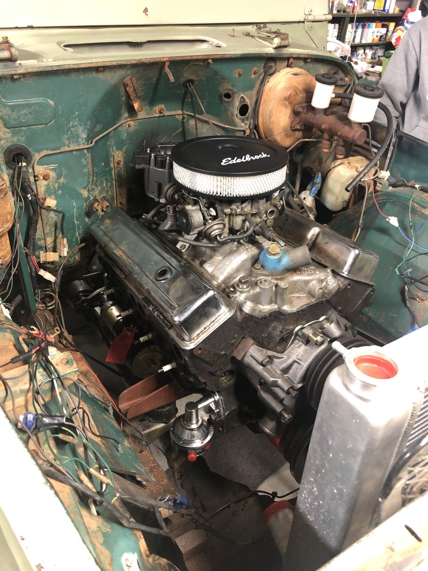

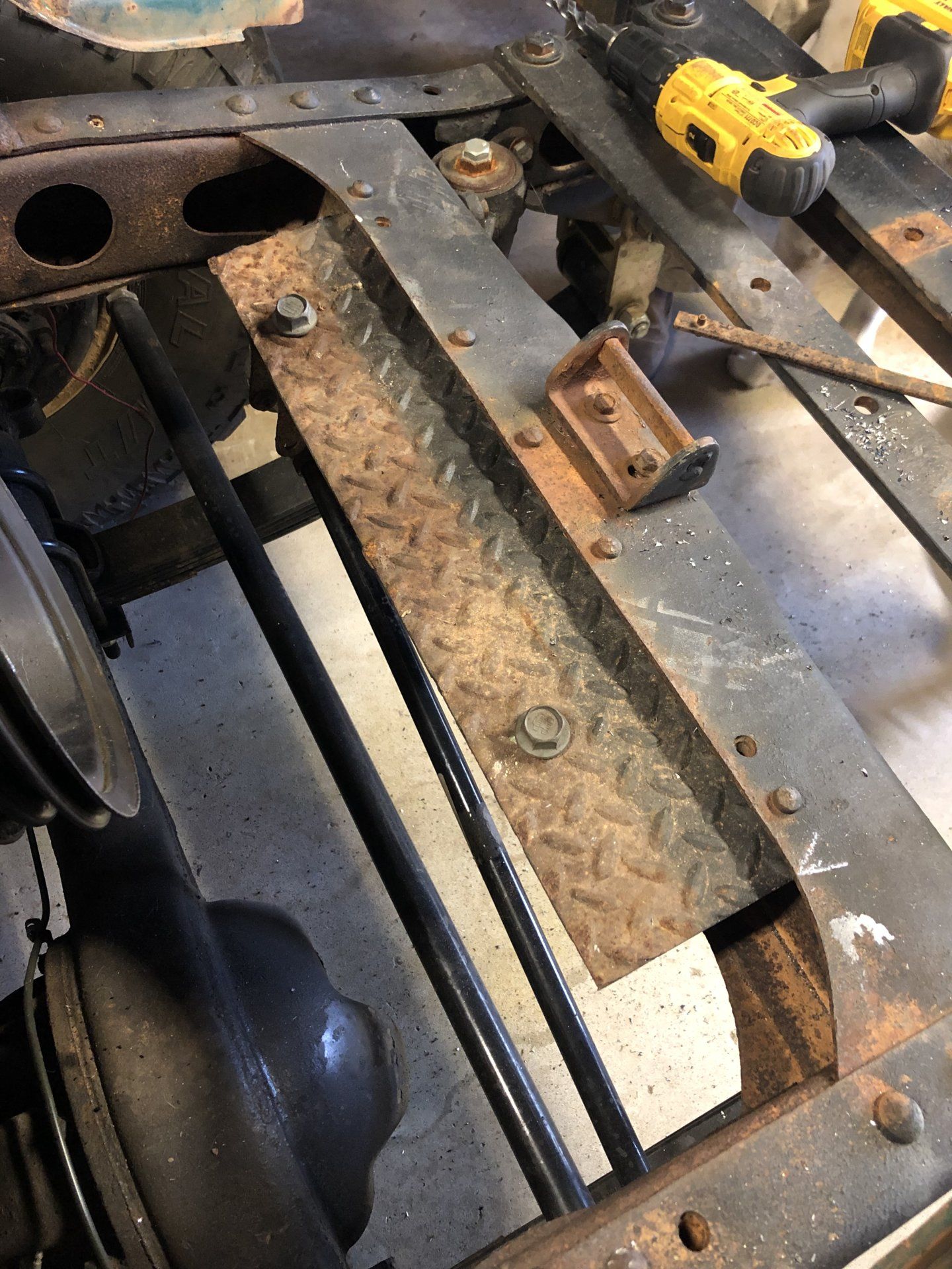

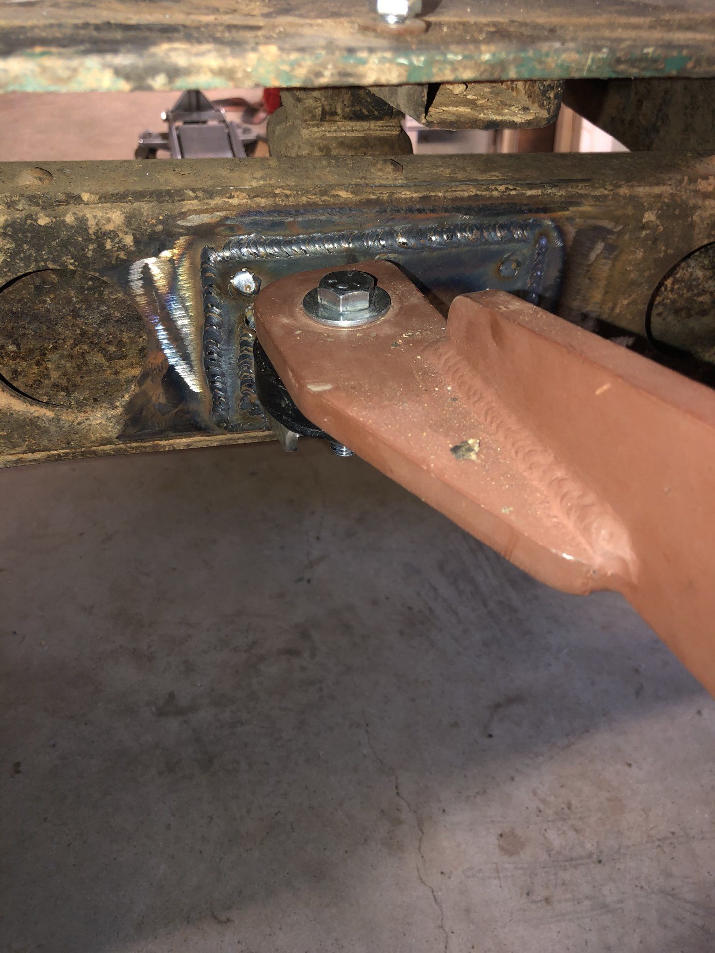

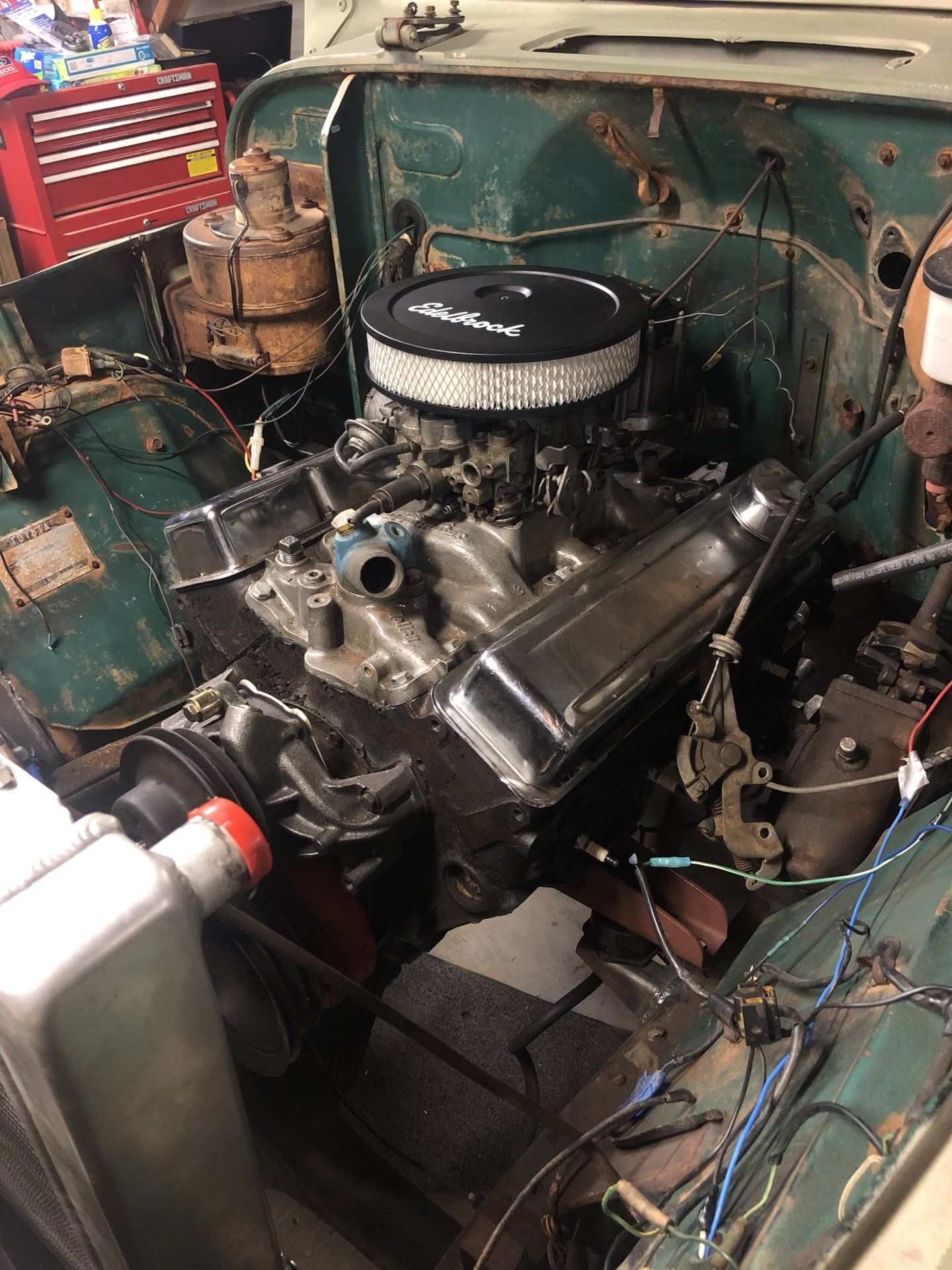

So I got some big updates, the engine is in! My buddy who is a welder came over when I was home for christmas break and helped get the motor mounts in and man they look good. We scabbed the frame for each of the four mounts, and his welds are great. And it worked out that both driveshafts fit almost perfectly. Also got 75% of the fab work done on the radiator mount. And got the starter, alternator, distributor, and carb installed. As well as the drivers side header.
Header clearance is really tight on the steering box, it was quite a pain to get it in. But there will be a lot of space when we do a power steering conversion.
