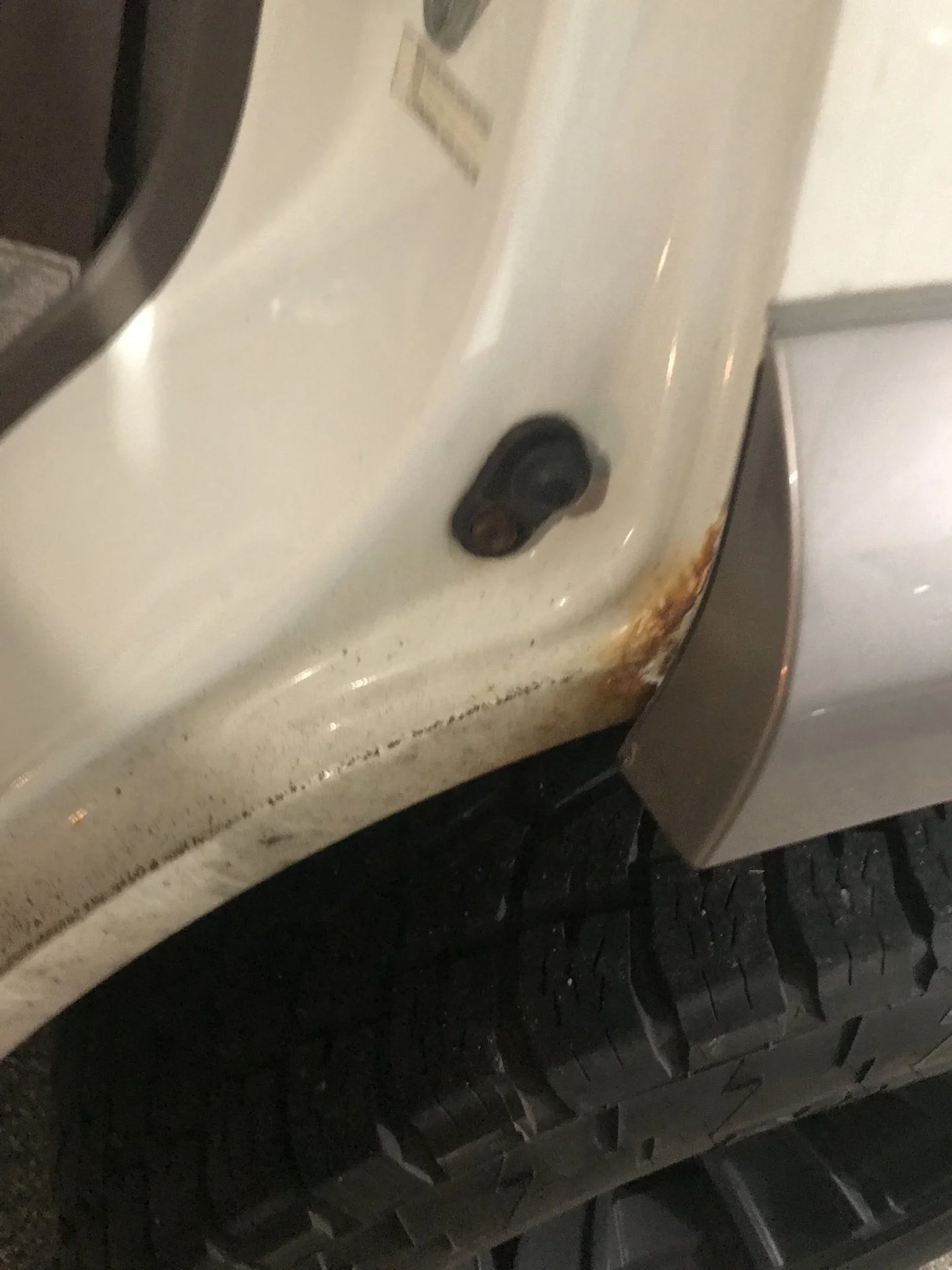

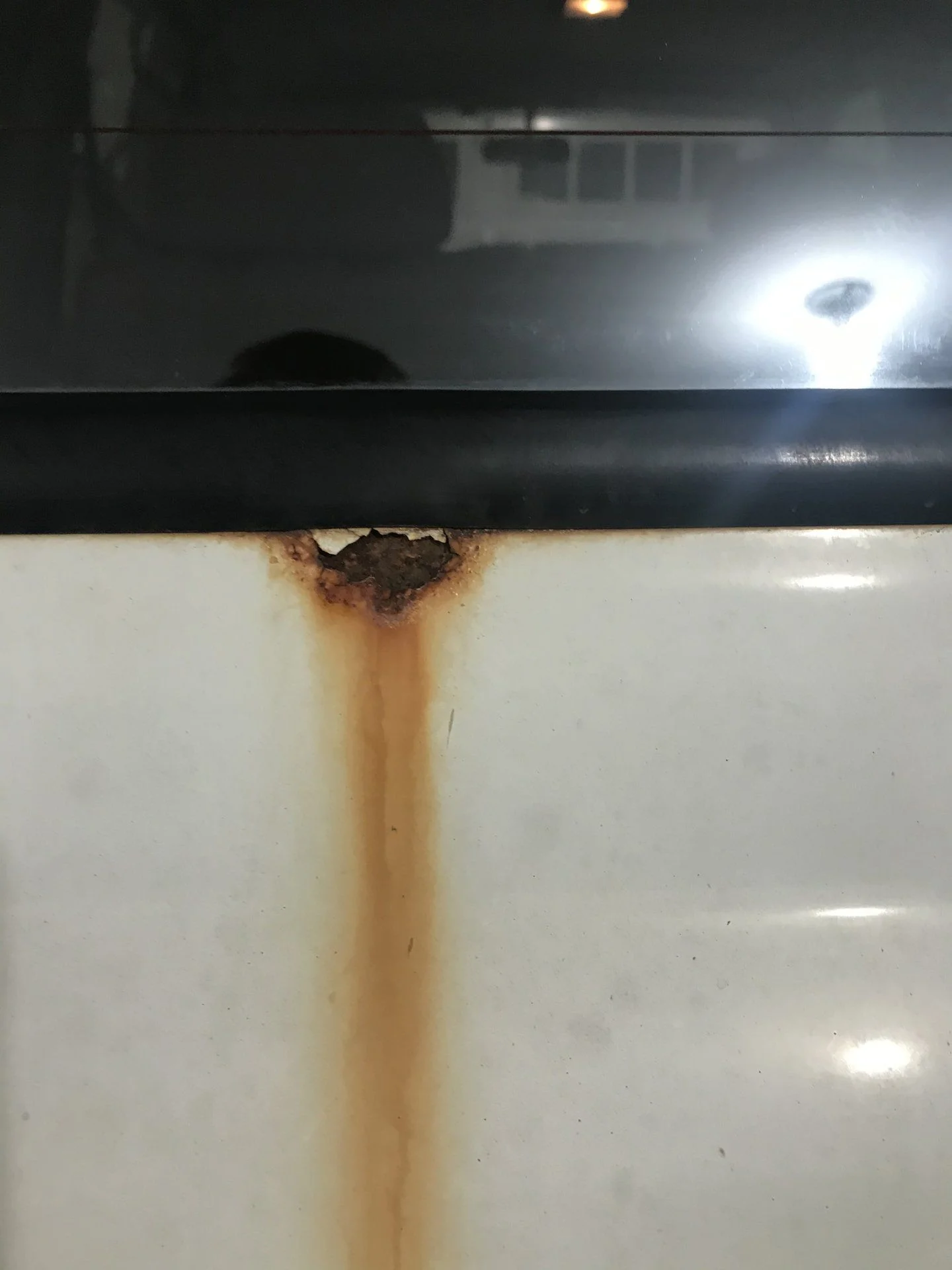

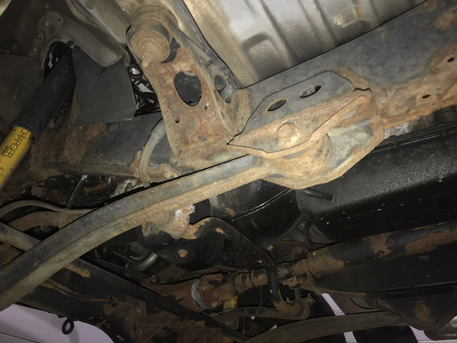

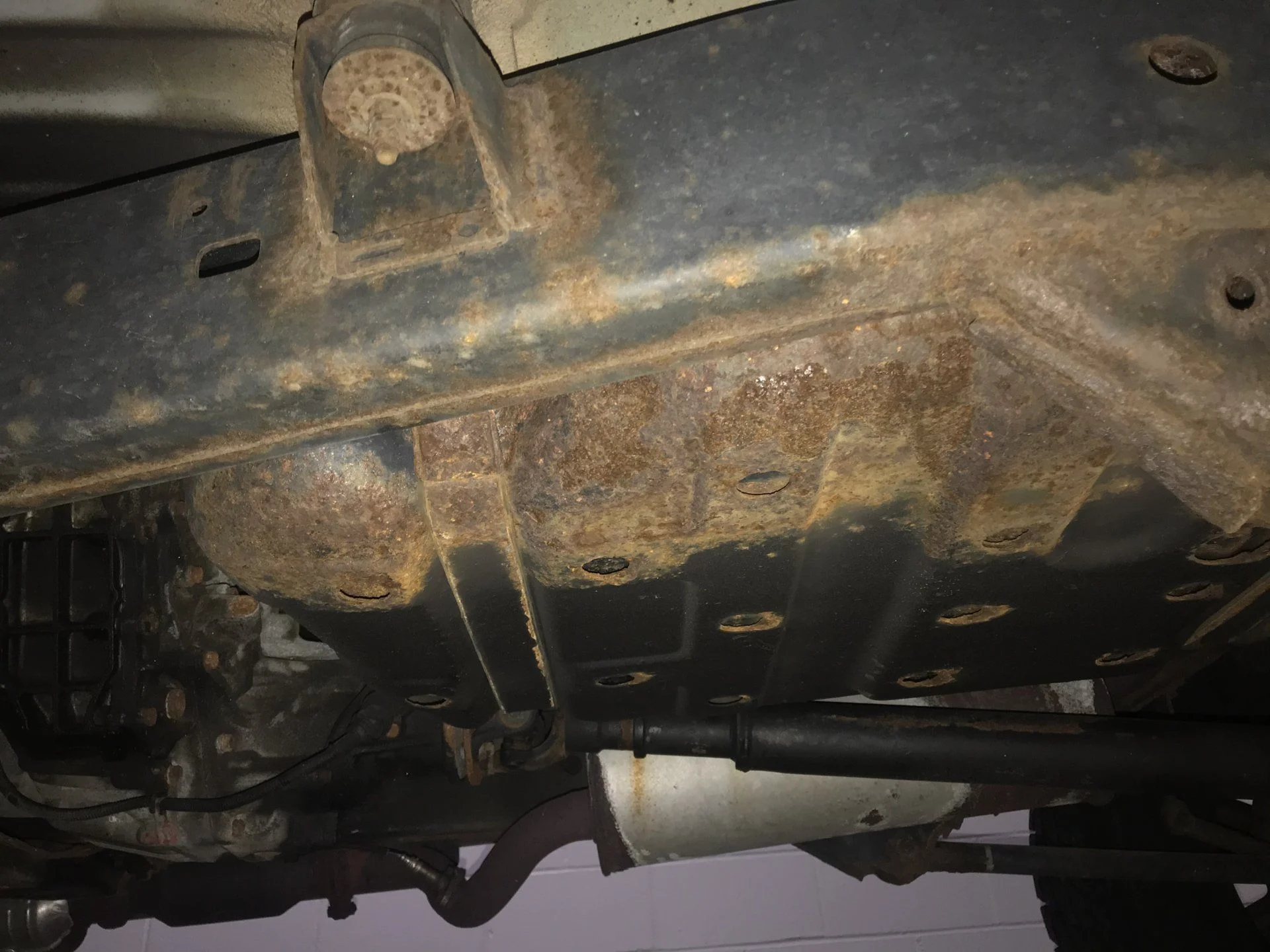

Twist: Why frame-off paint job, is it that bad? Do you have body mount brackets that are ready to fall off, rust holes in frame? Can you post up some photos of the worse areas of the frame and body?

I know it’s not on the verge of falling apart, but it annoys me and if it’s not cost prohibitive to make it perfect, I’d consider a nice resto.
