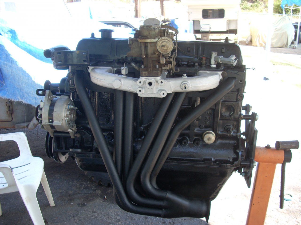

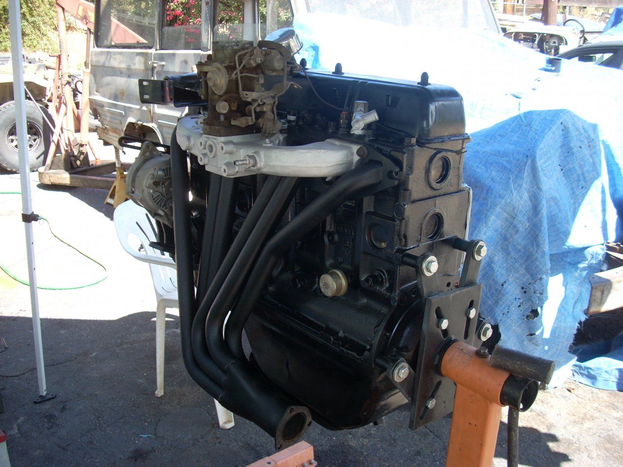

I have been running the same headers on my 1973 40 for over 25 years, 10 years on my sons 1973 40 I also ran a set on the 1966 LV with a 1974 1.5F . I am running a 2F he still has the orginal 1F. Honestly I could not tell you what brand they are I picked them up used via a fellow mud member used, Painted them with some BBQ paint and have never had a problem. Living in So Calif I couldnt tell you if there would be a big diffrence in location ( rust issues ) I do know they dont leak, Cruiser runs Great and its clean. ( Pic of the motor going into my 66 FJ45LV ) so I guess my opnion is find something clean/straight and run it
