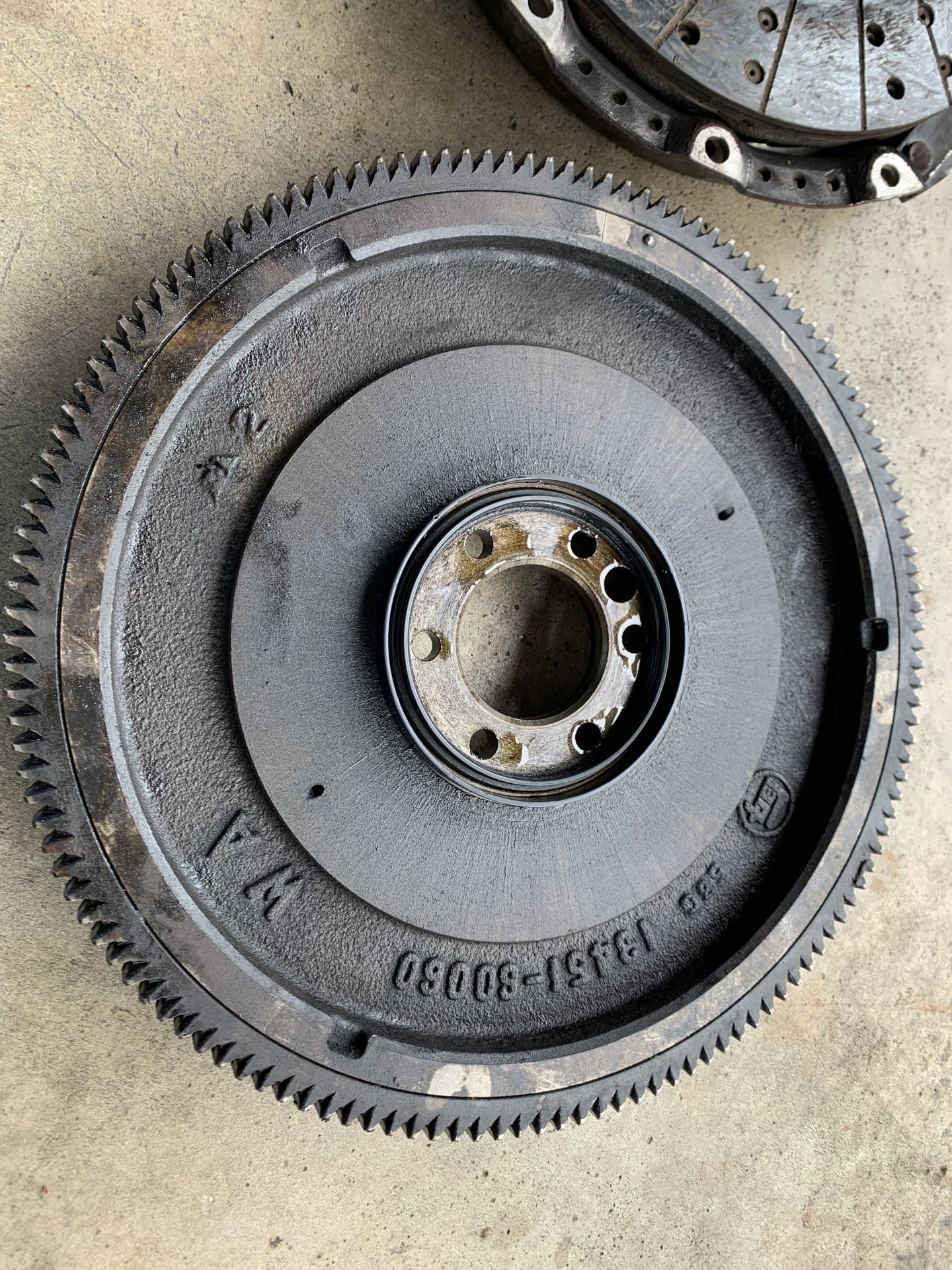

I went down this path over the winter. Mine was leaking oil from a lot of places so I did the timing cover seal and gasket, the pushrod gallery cover gasket, replaced both the oil pan and gasket, RMS, had my flywheel resurfaced, and installed an Aisin clutch kit. While the transmission and transfer case were out, I resealed both cases (they were leaking too) and replaced the o-rings in the speedo housing (included in the reseal kit for the t-case).
For reference, a photo of my flywheel with obvious RMS leak. The seal was so loose it came out with the flywheel.
Nice of the RMS to save you the removal step!
