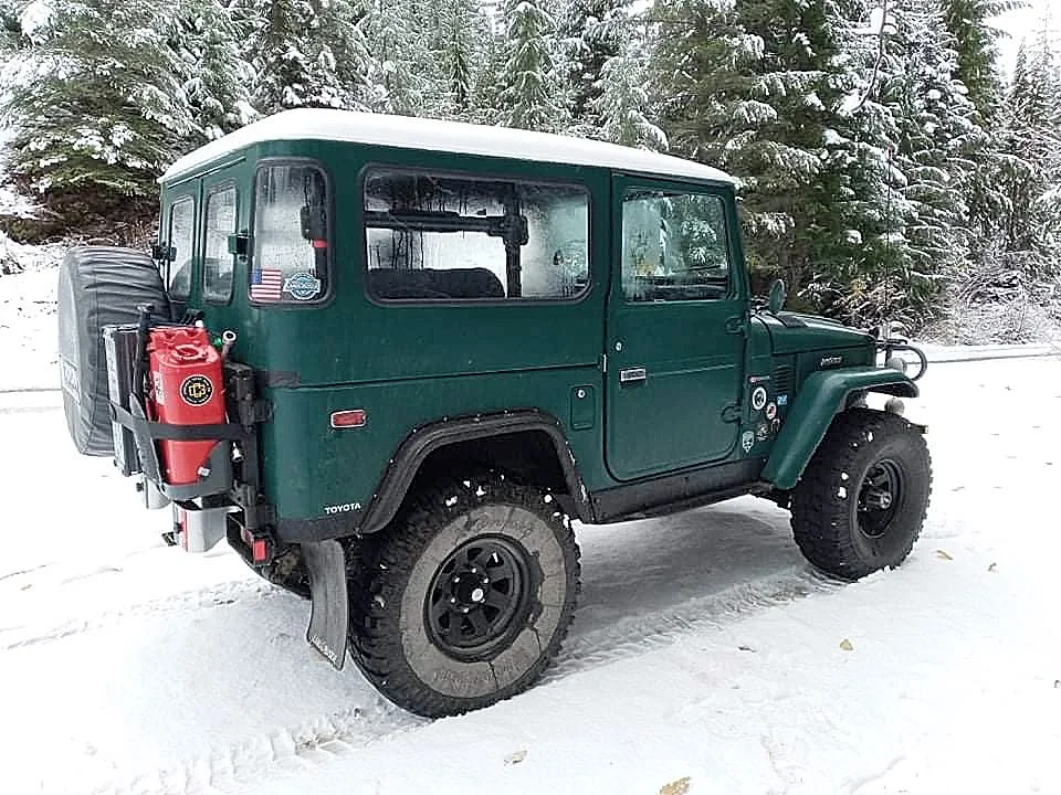

I'm running the 4 inch HFS springs with 35's and Bilstein shocks on my 76. I didn't need to extend the brake lines on mine but your 69 may require doing so. I do still have to extend my front bump stops about an inch but haven't got around to it yet. Tried some cheaper shocks but they blew out within a couple years. Bilsteins are well worth the extra money and helped smooth out the ride tremendously. Good luck!
Nice. Yeah I figured for ~$400 new shocks were almost definitely worth it to just go on and do, and the homie hookup on the lift springs makes that easier to justify. What width tires are those? My christmas present from my wife was/ is some steelies similar to those; I went 15x8 for the wheels, but haven't picked out the exact tires yet.
