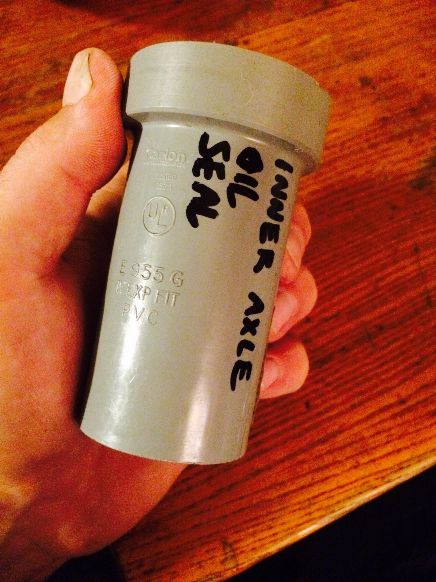

I'm a subscriber to the "PVC SST" school of thought. For the inner axle oil seal, I use the female end of a 1.25" SCH 40 expansion fitting, but I'm sure there are others that would work. Cheap and readily available.
View attachment 1504412 I'm a subscriber to the "PVC SST" school of thought. For the inner axle oil seal, I use the female end of a 1.25" SCH 40 expansion fitting, but I'm sure there are others that would work. Cheap and readily available.
I like this idea. Good job.
