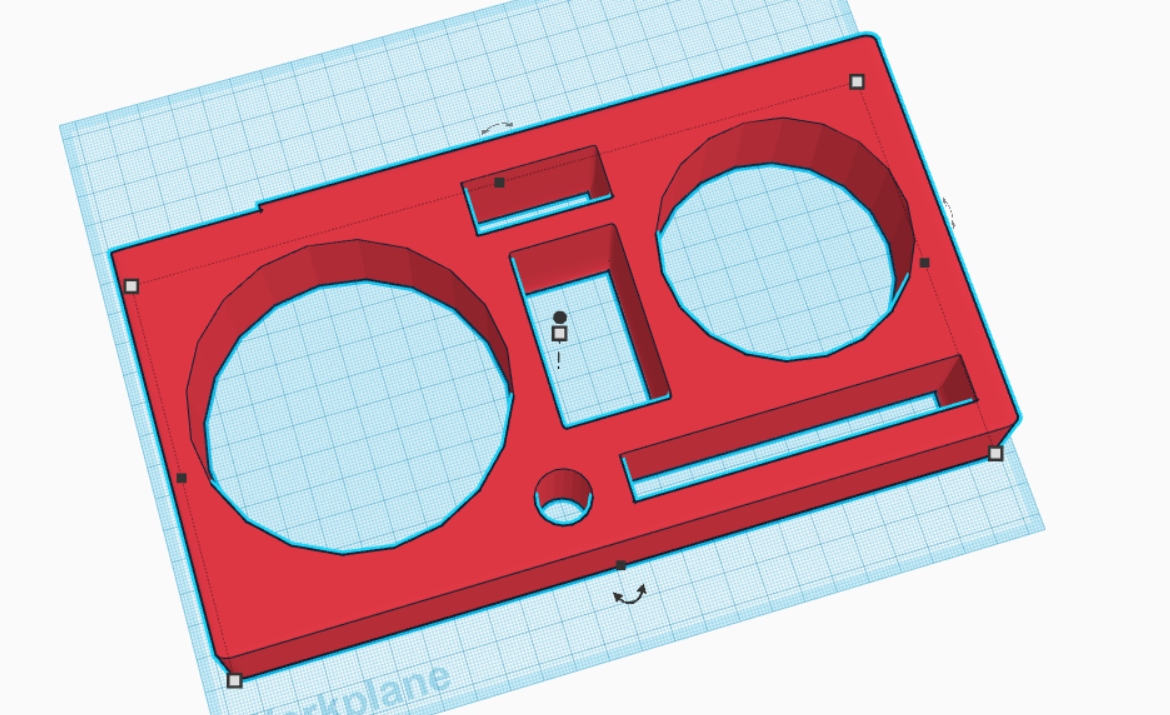

Okay, call me bored. Whipped this up as a first pass prototype to establish working dimensions
Nice. Is that a phone slot? I would include two.
While my wife is much better in Revit than i am, i may have to bug her. I have a plastics guy across the street from me.
