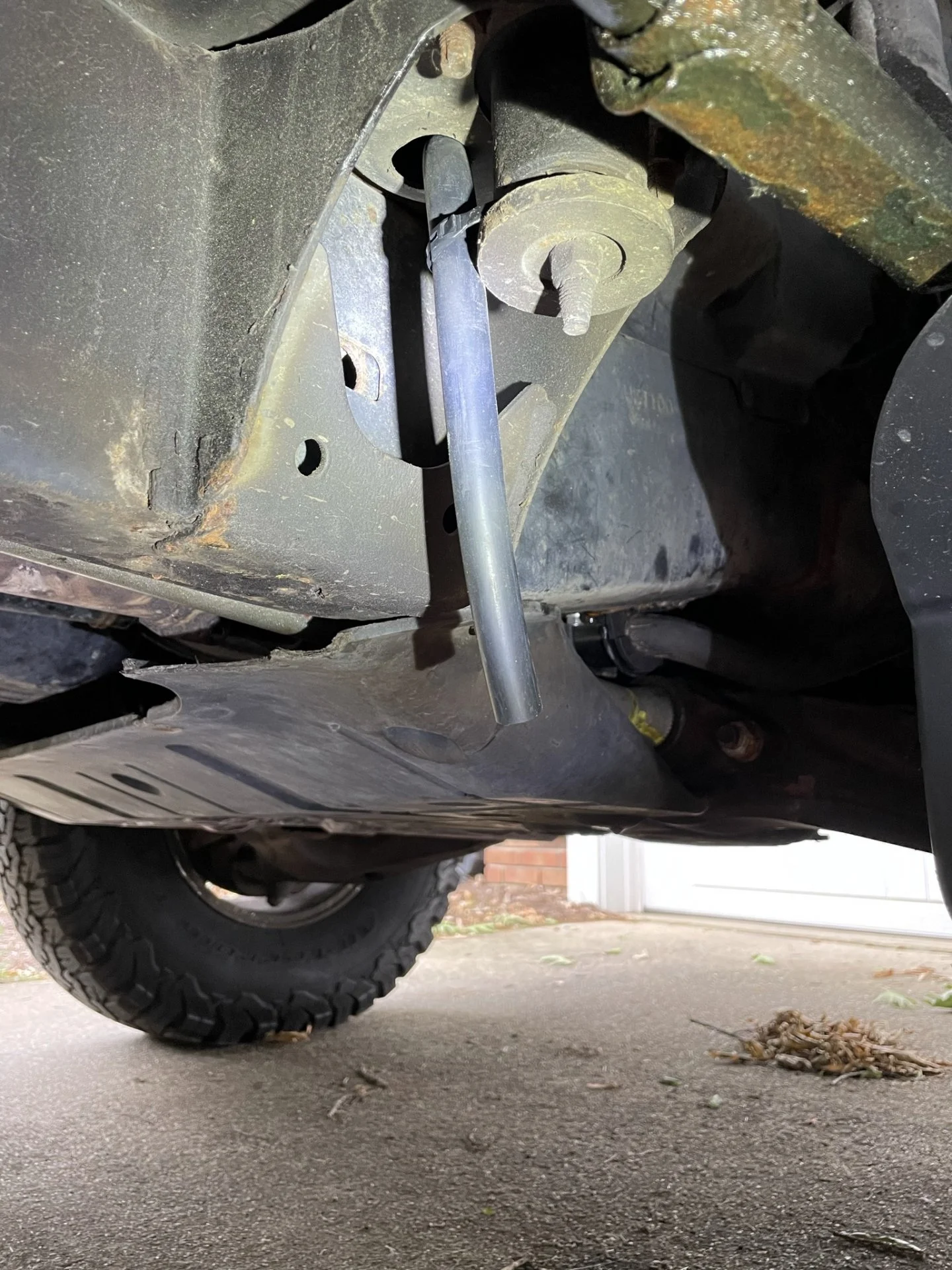

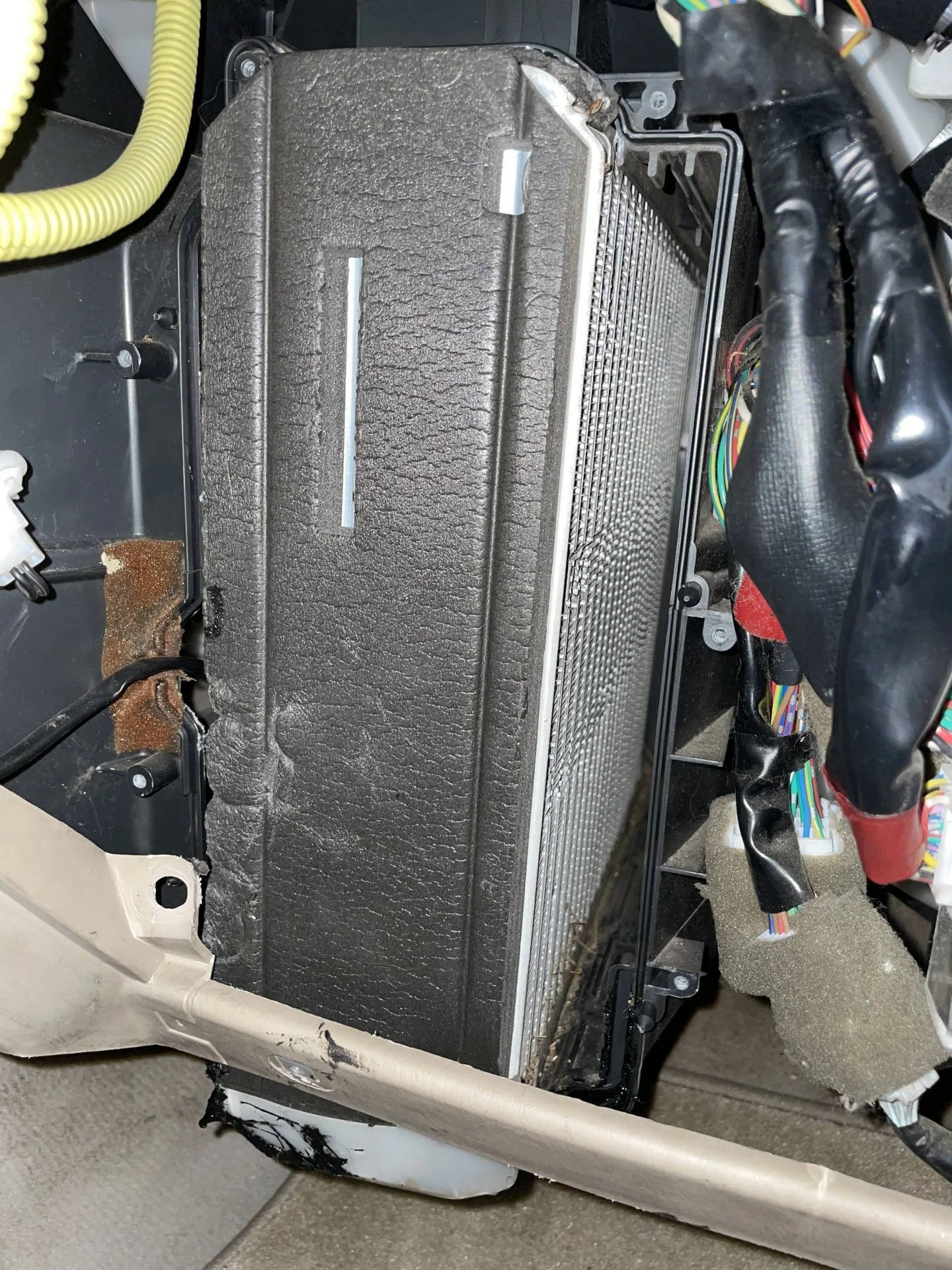

This has all been super helpful. I got my system recharged and it lasted about a month. My shop said it was difficult to find the leak but finally found it in the evaporator. He was booked out a couple weeks and in the meantime I decided to start the job myself. Here is what I found.
Best I can tell the evaporator was replaced previously. There was black sticky caulk like sealant at the bottom, the core looks very clean and I do not see any evidence of dye. Additionally, there appears to be dye on the line near the front passenger wheel well, which makes me wonder if the leak is elsewhere.
What do you think?
Still replace evap?

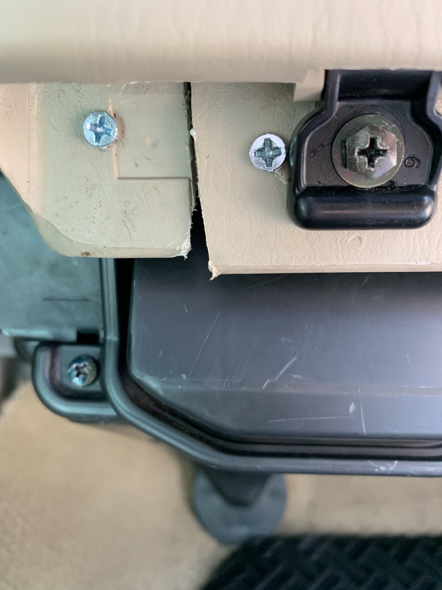

Got my evaporator and condenser replaced. Saved about $800 in labor by cutting the glove box support. But now I’m having trouble really securing it so the glove box hangs properly. I used a little metal plate and some nuts and bolts as shown in the photo. But the weight of the box pushes it down. Afraid to tighten the bolts any further as they will just go through the plastic. Any thoughts on additional support? Thanks.
Get rid of the Flathead screws and replace with panhead screws. Remove what you have now (glovebox) get some 'good' 3M double sided high contact tape, put it between the metal and plastic then screw it back down (use a PANHEAD screw). Let it sit for awhile, then re-tighten so that the double sided tape is fully compressed. Then reinstall the glove box.

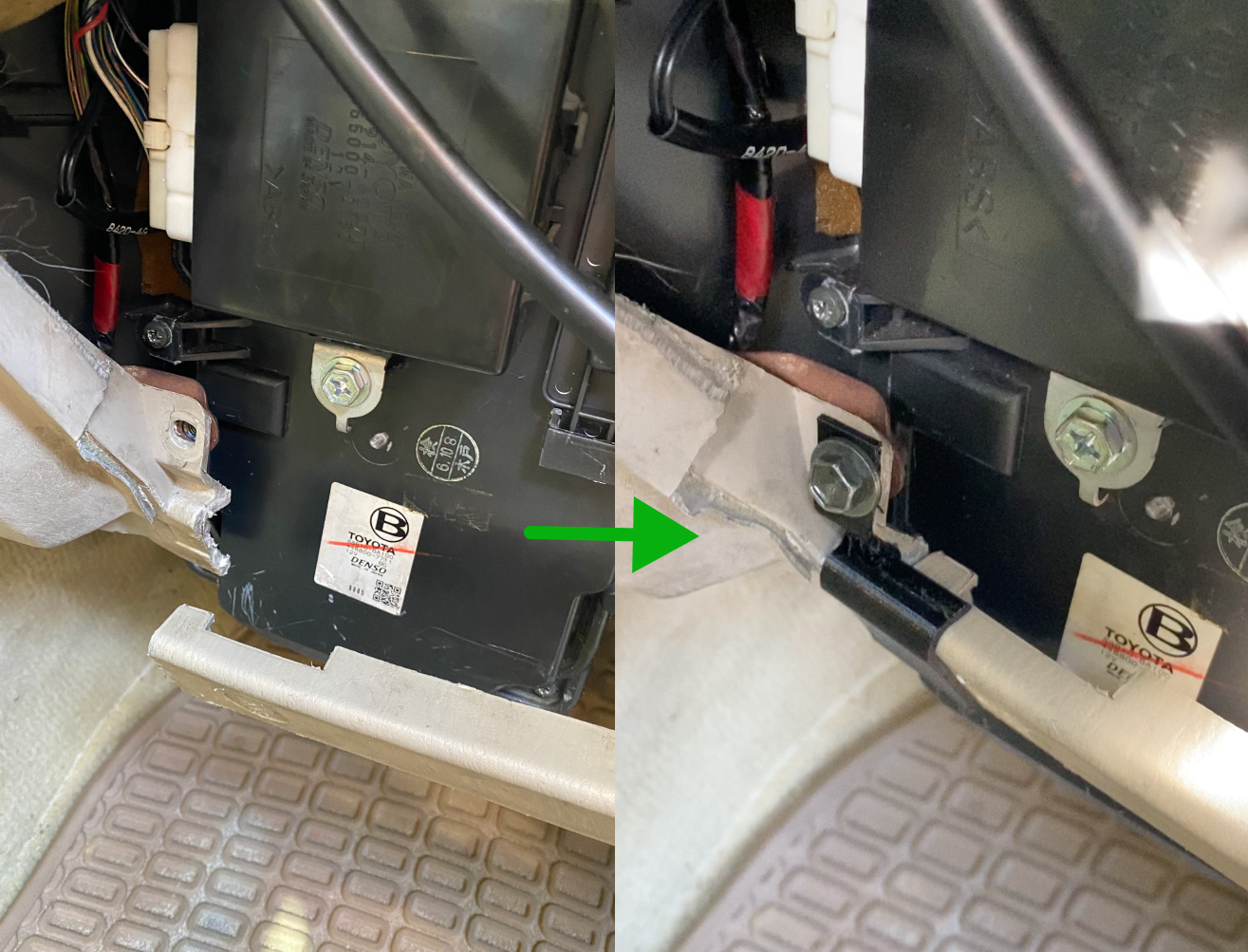

This 'C-Section' method of removing the evaporator does indeed make it easier to remove the evaporator...but someone with a 3D printer needs to come up with an easy way to put it all back together. There is a good business opportunity there for someone inventive.

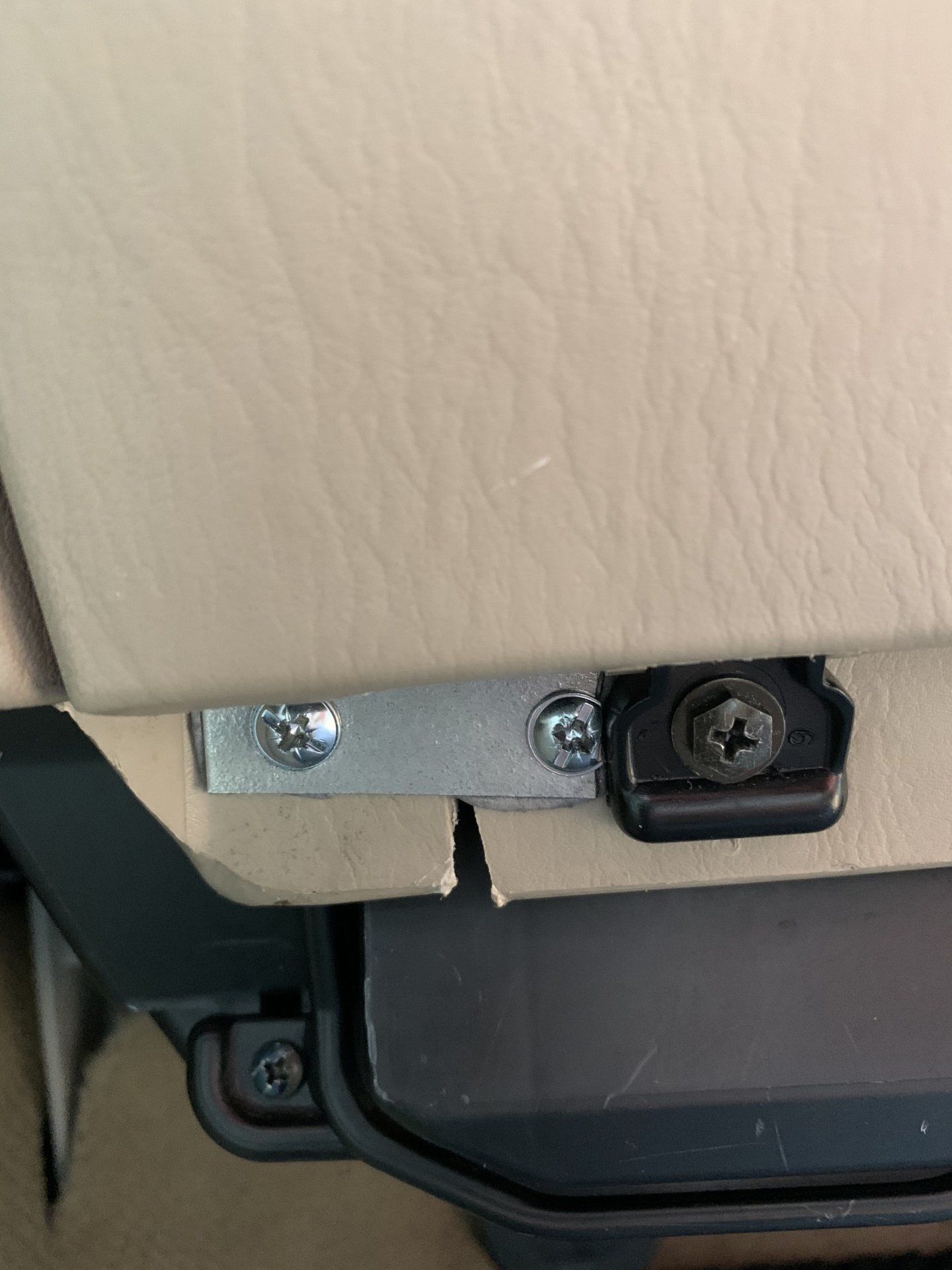

A 3-D solve would be great! I will say to everyone, do this at your own peril. I took @flintknapper’s advice and used some pan head screws with heavy duty double stick tape. I also sandwiched two metal plates to really tighten it down.
The weight of the box still pushes it down just a bit. It’s not the end of the world but the box is slightly crooked when closed. I might try to build up some JB Weld or something similar in the space where I cut the support to really fuse the two sides together. Then add the plates again for extra reinforcement. Open to other suggestions though.

The weight of the box still pushes it down just a bit. It’s not the end of the world but the box is slightly crooked when closed. I might try to build up some JB Weld or something similar in the space where I cut the support to really fuse the two sides together. Then add the plates again for extra reinforcement. Open to other suggestions though. View attachment 2735775
Your flat metal is not nearly as wide as I had imagined. Perhaps a piece of aluminum 'angle' would provide better support on the backside. You have a lot of 'gap' to support there. Keep at it, you're almost there.

@Jfcol @fooldall1 I created one for my evap core change a couple weeks ago.
That is slick! I wish I could turn back time. Mine is holding up with a combination of a bracket and JB Weld. I just hope I never have to cut it again.
