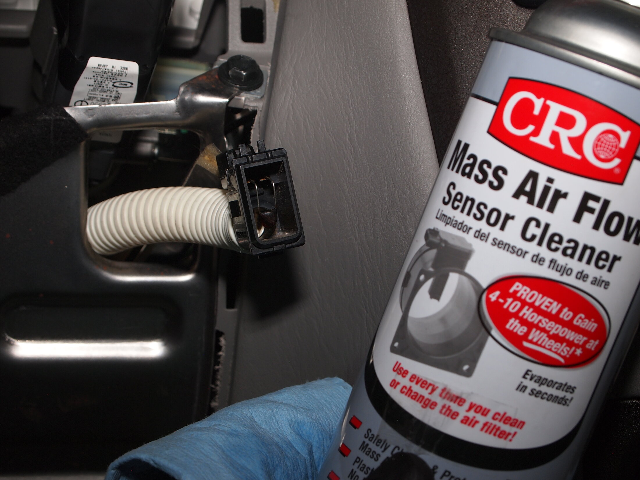

If AC blows cold on max cold (~45F). AC charge okay.
The white hose connect to a sensor. Cleaning or replace sensor is sometimes needed.
Also make sure radiators fins clean
