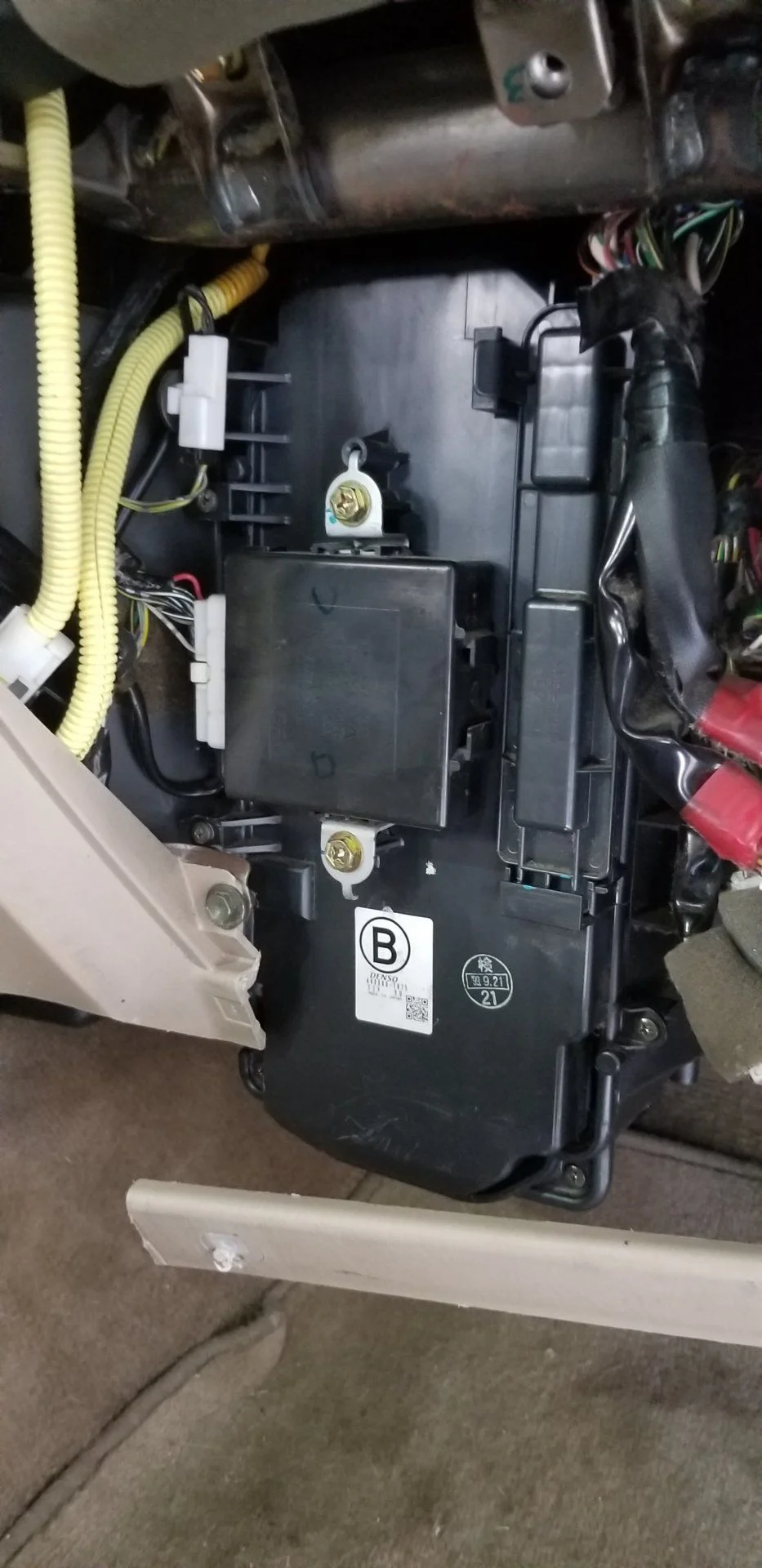

Take off glove box with two screws on bottom. Two screws on top corners takes out the black plastic liner. Unhook couple electrical connectors you will see. Then two gold screws takes off the small black box from evaporator cover. Take off narrow filter cover on right side of evaporator (about 4" long). Take out two filters. Then 8 small screws takes off the evaporator cover. Then the evaporator pulls out. Really tight by holding both ends of already cut plastic rail.

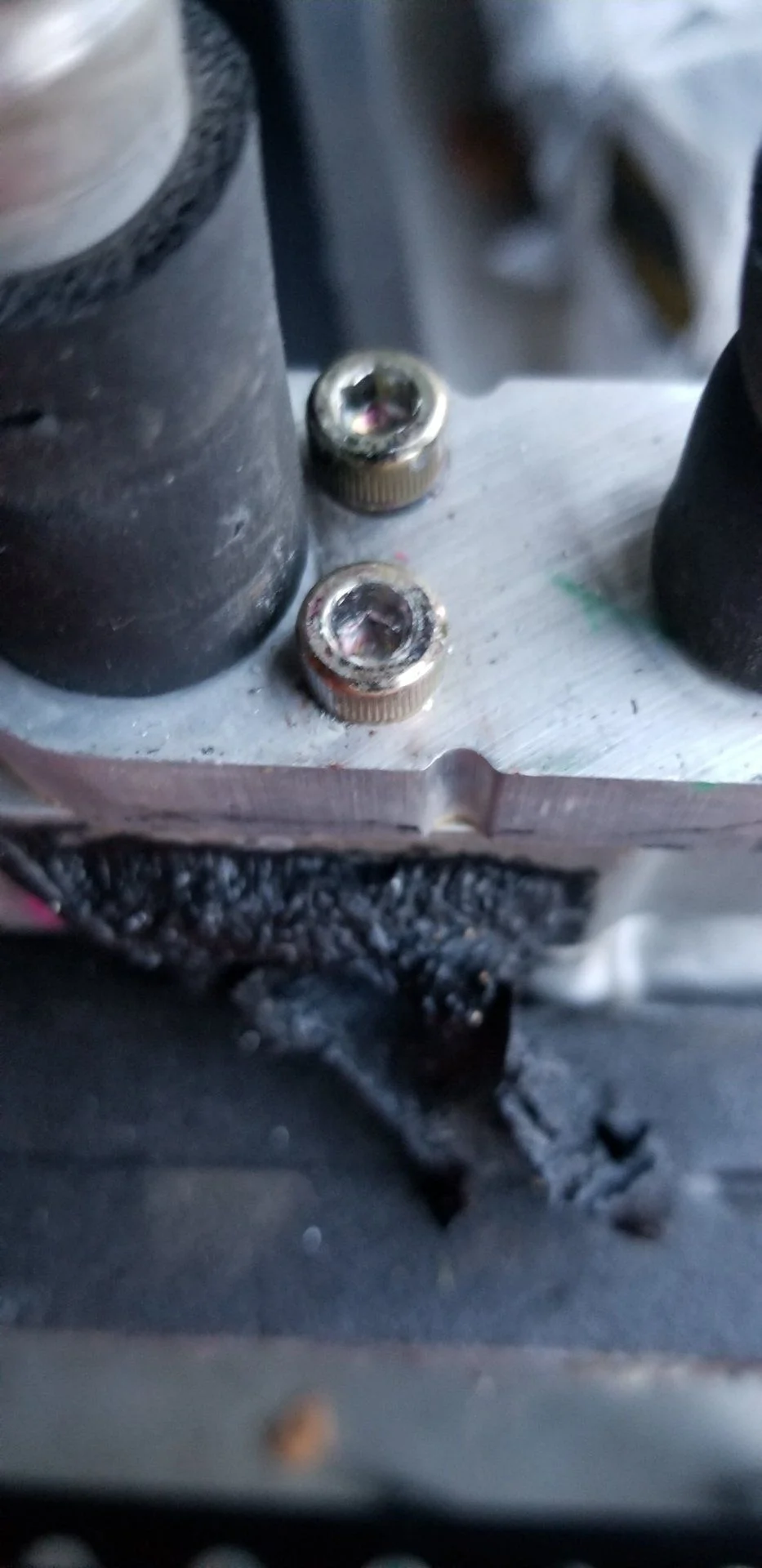

Expansion valve has the two allen screws. Mine were pretty corroded and hard to get out. I sprayed liquid wrench on it. Using allen head inside socket and ratchet, it finally came out. i replaced the bolts with hex head stainless bolts. After removing. Make sure to replace two O-rings on the new evaporator going into expansion valve, two O-rings on pipe connector goin into other side of expansion valve and two O-rings on each of the steel lines under hood.

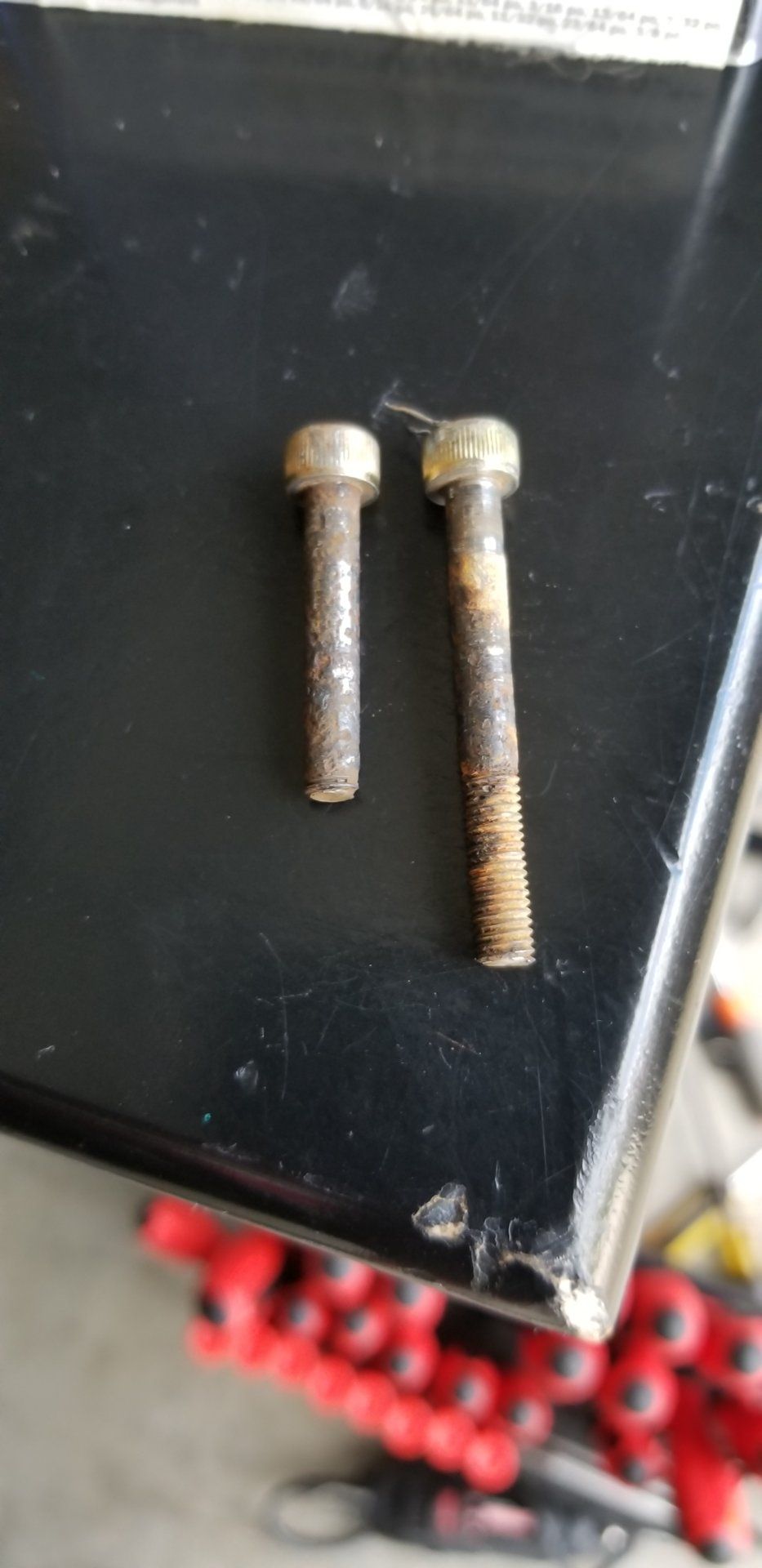

You say you replaced the bolts with stainless hex head bolts..what size, type,thread pattern etc? I'm only asking because I think these arent the original bolts because they are 4mm..not 5 as the FSM states and were so bad they both stripped and broke off inside the old core-expansion valve
This bolt was corroded and clearly overtorqued. My Dewalt and the screw extractor worked but this Damn bolt crapped out
Gracious... I don’t know remember what the screw specs were. Dang
I got some from Ace, that look really similar but i will just sweat it out and order them Friday. Lowe's didn't have anything similar. Because these broke off inside the threads of the old Evap core-- I have no idea how long they're supposed to be.
Well, they're only 3 buck a piece from Toyota- @gatormark91 I will get an extra three for you as well for when you do your Evap. Another Poster above mentioned his broke in there as well. Must have something to do with heat/cold/heat/cold and moisture. Stainless does sound like a MUCH better option.
Thanks! If those bolts are steel, and the core is aluminum, bi-metallic corrosion is probably the culprit.

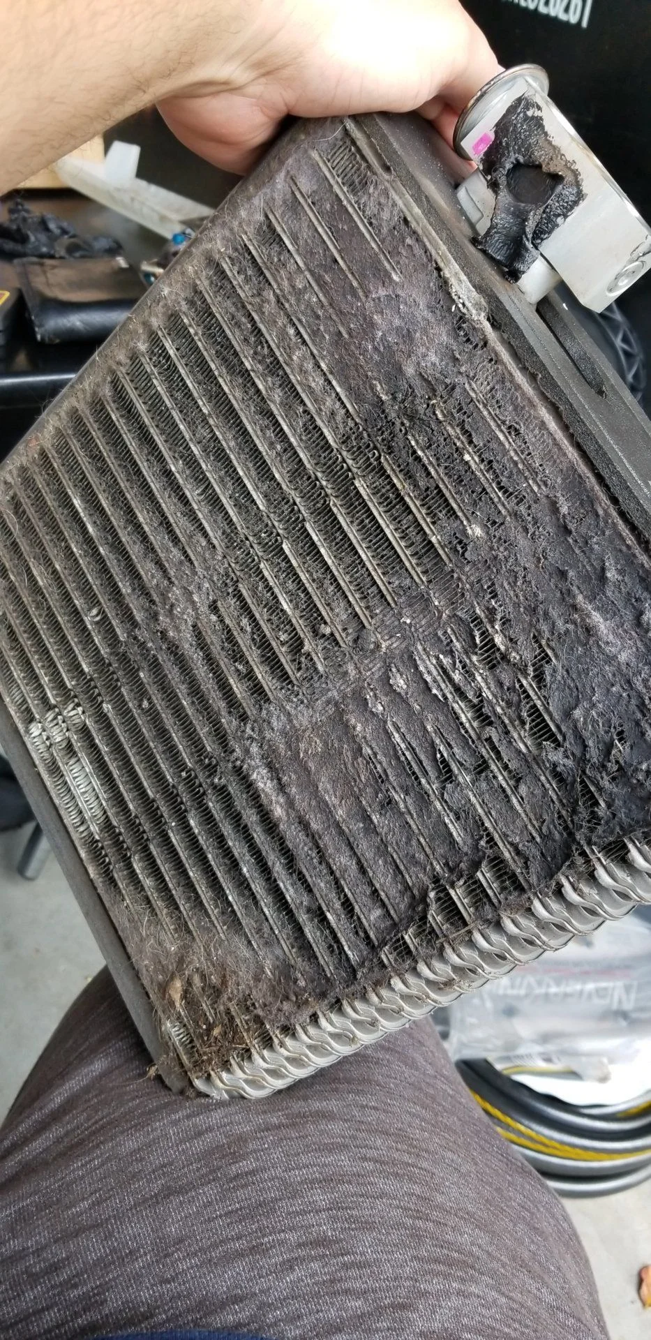

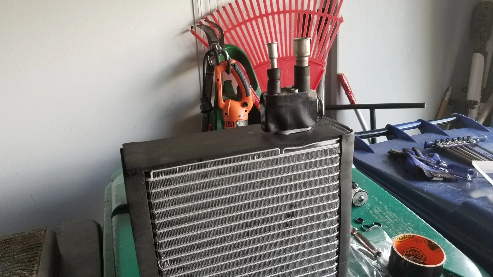

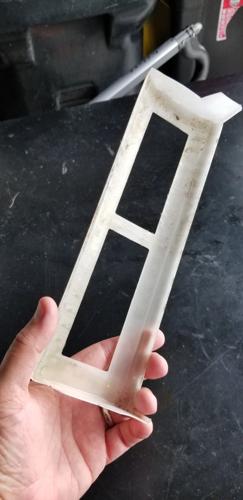

The core was in very bad shape... also, the original expansion valve had some type of tar tape on it. Is that required? Originally, I guess it insulatesthe valve? Also, don't forget to remove the old white slide tray from the evap core when you replace it.
