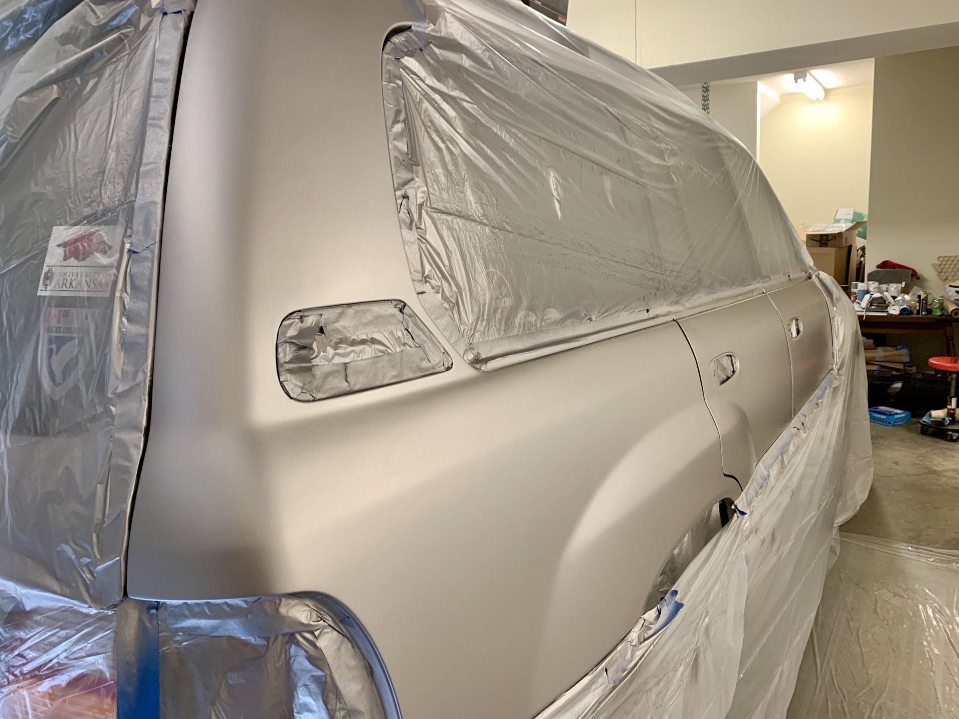

Appreciate the input on the blender guys I think I got my steps all lined out now! Everything is masked off so paint & clear will go on early tomorrow morning. All I got left to do is drape a drop cloth down the center of the truck and then wipe down with wax & grease remover and finally tack cloth before spraying.
Let the fun begin
So far so good. I’m really happy with how this is coming out. I’m 2 coats of clear in and I will put on a 3rd since I had a few small runs I want to compound and buff out at a later date. VERY happy this is going well! The areas above the door molding and below the rear vent that are darker are just reflections of my garage floor and ceiling, the clear was still very wet when I took this pic
For an aerosol metallic paint it went down fantastically. I always heard about how much of a pain metallic paint can be since the flakes will sometimes not match, but man this is spot on! Also, I did end up using the SprayMax 2K Clear Coat instead of the regular “High Gloss Clear” from Automotive TouchUp, and holy cow this is THE BEST clear coat I’ve ever used! It goes down very thick and it gets very hard after letting it sit for even 30min. It’s smooth as glass too (besides the orange peel that is noticeable along the body line in the 3rd pic). For reference, I did not paint the front fender or A-pillar, and the freshly painted panels match it perfectly. Now I will just wait until tomorrow to reassemble everything, and then compound & polish next weekend after it’s had time to cure.
