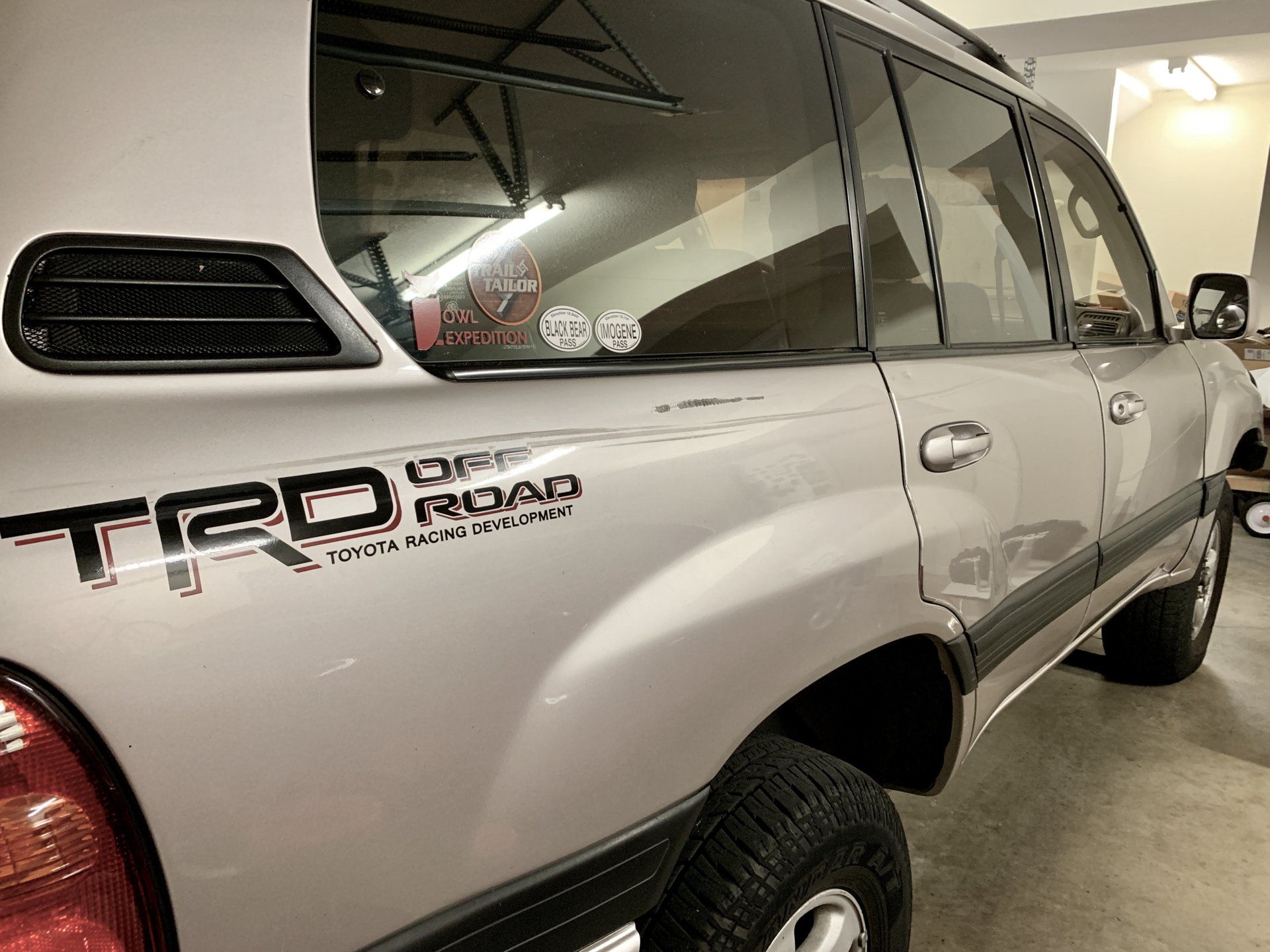

Back in March of 2018 I had a distracted driving incident where I wasn't paying attention and ended up veering off the road sideswiping a mile marker sign on the shoulder. I clipped the mirror which thankfully did not break off and instead folded in like it is designed to do; however, it did shatter the mirror glass and then continued to scrape down the side of the truck digging in the deepest when it reached the passenger quarter panel. I immediately replaced the mirror glass since that was a priority, but quickly realized that I had no interest or care to fix the ~6" long deep scratch on the quarter panel.
Fast forward to today and I am considering repairing it myself. I've already ordered the (1B1) Champagne Pearl paint from Automotive TouchUp, as well as a can of their High Gloss Clear Coat. I ordered both in their aerosol forms to make my life easier since I don't have a pneumatic paint gun or other fancy equipment.
Now I am looking for some tips, tricks, and opinions (especially from those who are familiar with this type of work on 2-stage paint) on my repair method that I briefly thought out. Any and all input would be greatly appreciated! I've outlined the steps that I thought made sense below:
  1. Wash, dry, clay bar, & dry polish the entire quarter panel with a wool pad on a DA buffer to prep for sanding
  2. Since the scratch is so deep, I was thinking about starting out wet sanding with 200 grit in the area surrounding it to get rid of the lose chips and to feather the edges as much as I can. Then, progressively move up to finer grits (400, 600, 800, 1000, etc...) always wet sanding
  3. Thankfully there are no dents within the scratch so Bondo/glazing putty seems like it would be an unnecessary (correct me if I'm wrong)
  4. Use a green Scotch-Brite pad to wet-scuff the area outside of the region where I sanded near the scratch in steps 1 & 2
  5. After all the wet sanding & scuffing is complete, I will thoroughly clean the panel again using a microfiber rag soaked with acetone or 91% alcohol
  6. Back tape the area where I plan to repaint and clear coat. This is where I run into some uncertainty and have a few questions:
    • Will I have to repaint and clear the entire quarter panel just to fix this one scratch?
    • What if I just taped off and wet sanded/painted/cleared the area I outlined in blue? I specified that area because the tape lines would follow the faint body line that is just below the pinstripe (obviously the pinstripe and TRD sticker will be removed) and would span from hatch to rear door

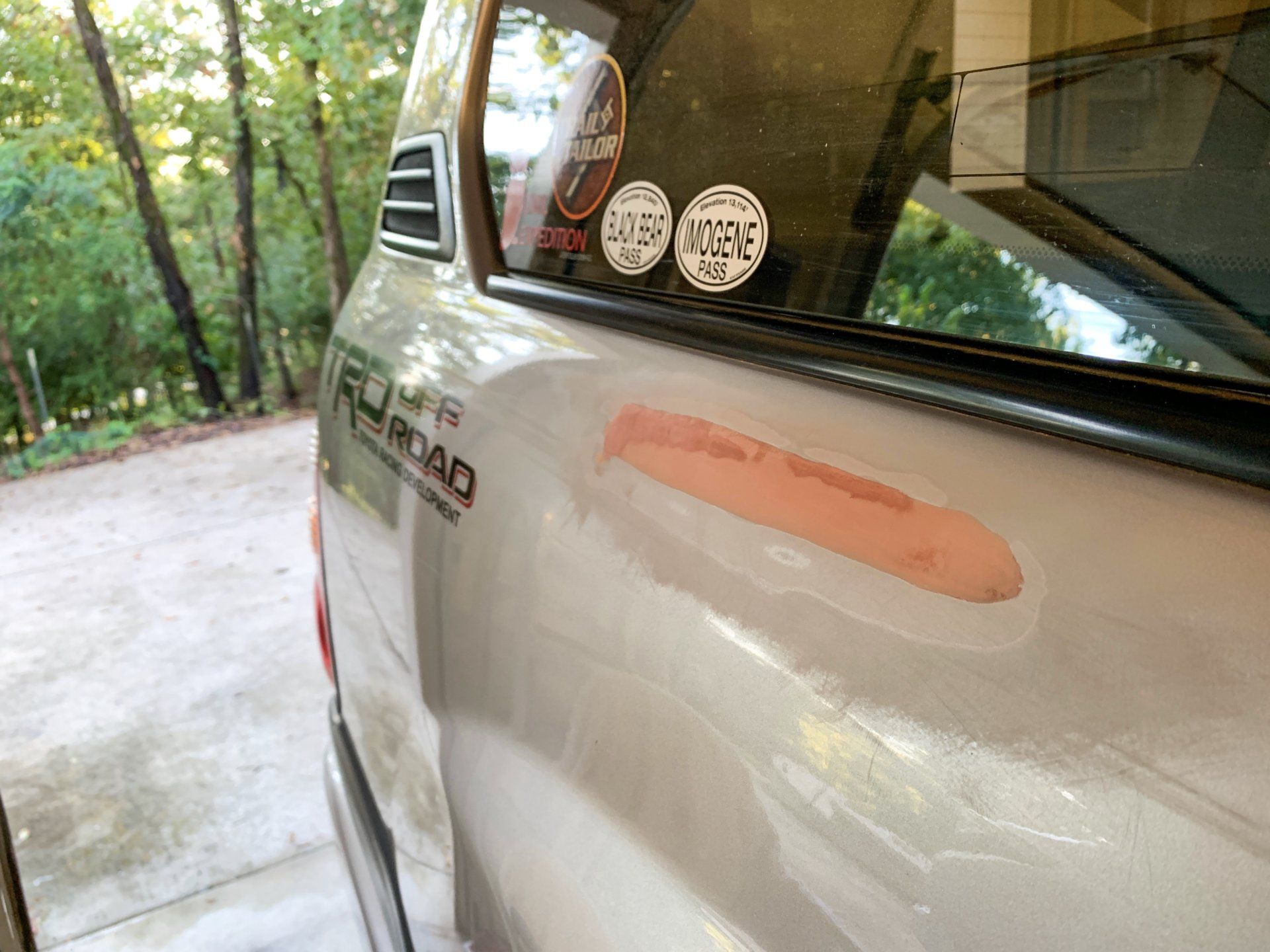

Screw it, progress has begun
Removed the pinstripe on both sides. Went from this
To this
Started sanding and feathering
Body filler & glazing putty on

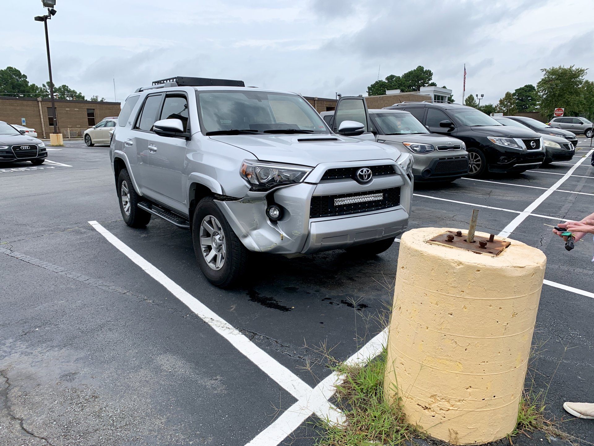

Took my 4Runner to run some errands and ended up crushing the bumper on a concrete pillar in a parking lot so that’s cool:bang: Called it quits for the day, will pick up with filler primer later on this week and then begin paint.
I’m taking this process slow, for everyone saying it’ll look like s*** no hard feelings but I think you’re wrong. I’m not looking for perfect just something better than what it was. And judging by how it currently looks I think it’ll come out really nice. I really appreciate all the input everyone has given! Keep it coming, all tips and tricks are very helpful.

In the process of repairing your cruiser you wrecked your 4runner? Oh man that's a bad day, time for a metal bumper for the T4R i guess
When it rains it pours am I right?? Yeah the low visibility caused by the high hood scoop didn’t allow me to see that pillar. Also you can see in the background every other pillar has a light pole attached to it except the one I decided to park in front of. Went to go get in my car after leaving the store, put it in drive thinking I was all clear in front of me, next thing I hear is the horrendous sound of crunching plastic against concrete. Not my proudest moment for sure!
