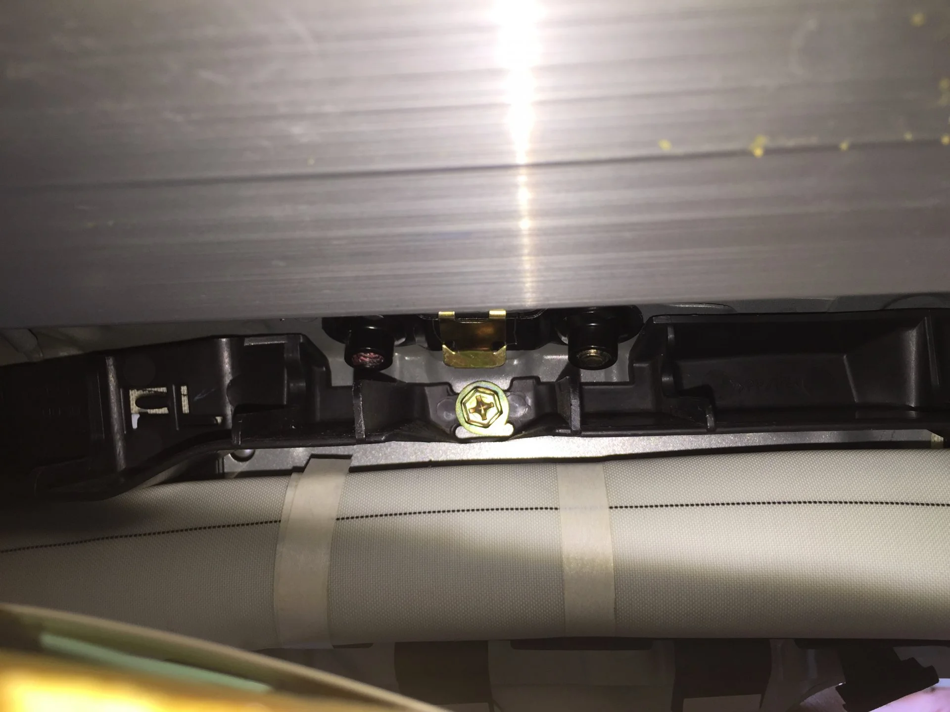

If you are taking care while removing there is probably no need to remove the headliner. The nuts are always in a pair in a small plastic housing. So if you are able to remove one of the screws and secure it you can do then the other one and they don’t fall into wherever they do in the cabin behind the trims.
Thats what I did when I mounted my ARB slimline and I lost only one pair and that was easily to fish out in the trunk while bending up a trim wide enough to fit my hand.
So aftermarket to oem should be in that sense one to one the same as oem to aftermarket.

Ah found a picture of it made by Baja Transit. Not even nuts and a cage. It is one piece. Have been a few years since installing it.

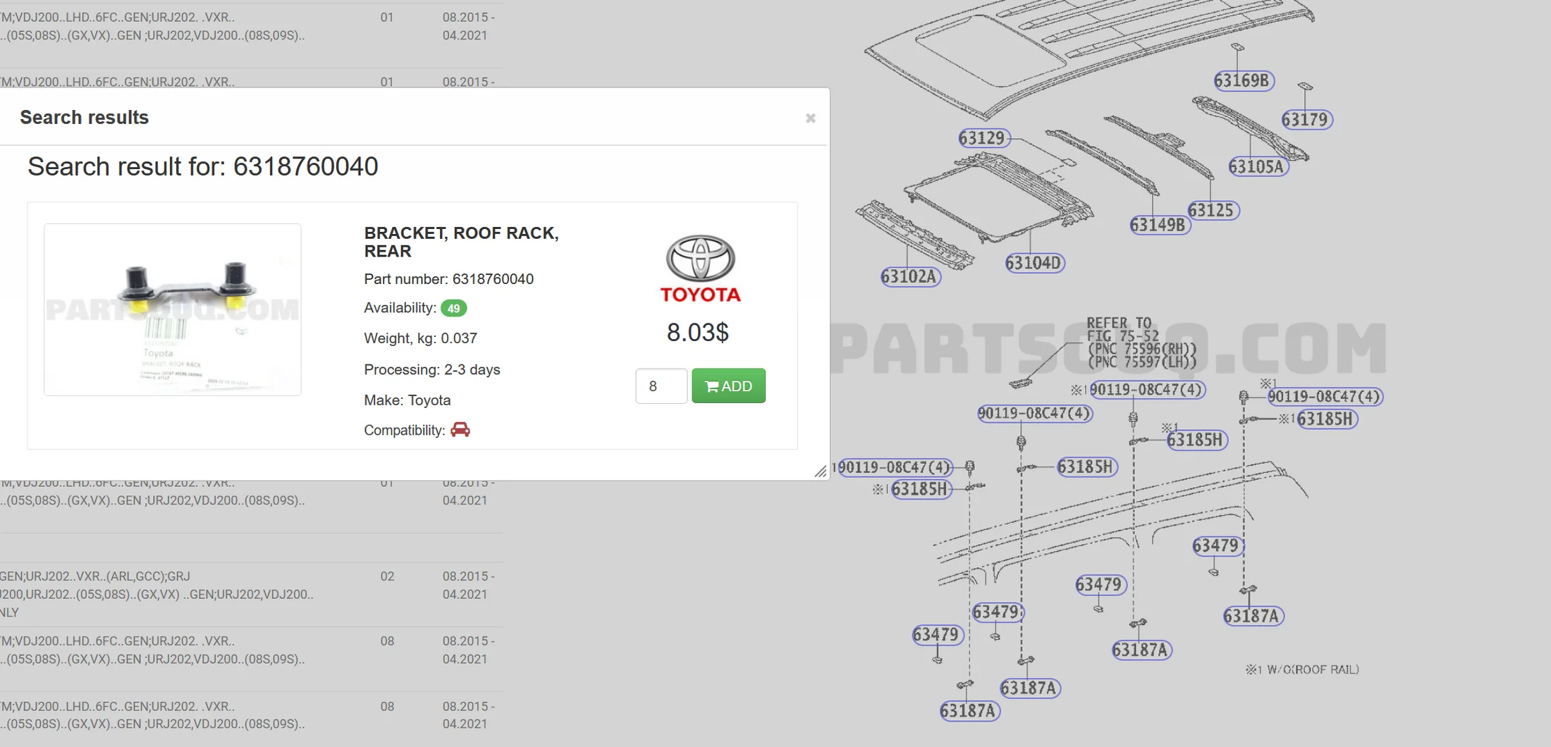

Shortly double checked it with a post face-facelift heritage on Partsouq.
It is one to one the same stuff from the first till the last 200 as I see right.
The little yellow thing is what sticks through the metal as a spacer. In theory it should have a tight fit to keep it in place while working on the roof rails.

Post 2016 LX's do not have those nut brackets installed from the factory unfortunately.

To close the loop on this. OK4wd had records of the installation, but couldn't guarantee that the oem mounting points were installed. I may just keep the rack. Or I may pull one bolt and look for the telltale yellow cylinder. Thanks everyone for the input.

I’d pull one up near the front. I was able to drop a small enough part of the headliner in the front to retrieve the nut retainer from the 2nd set of holes on my LX. Probably only took about 45 min total. A small nut might be harder or easier to find.. not sure.
In case it is just a nut which was tightened with a key from the inside, when the roof liner was down, it probably is best not to touch it at all. Leaks from after market racks not properly sealed or tightened is a known issue.
