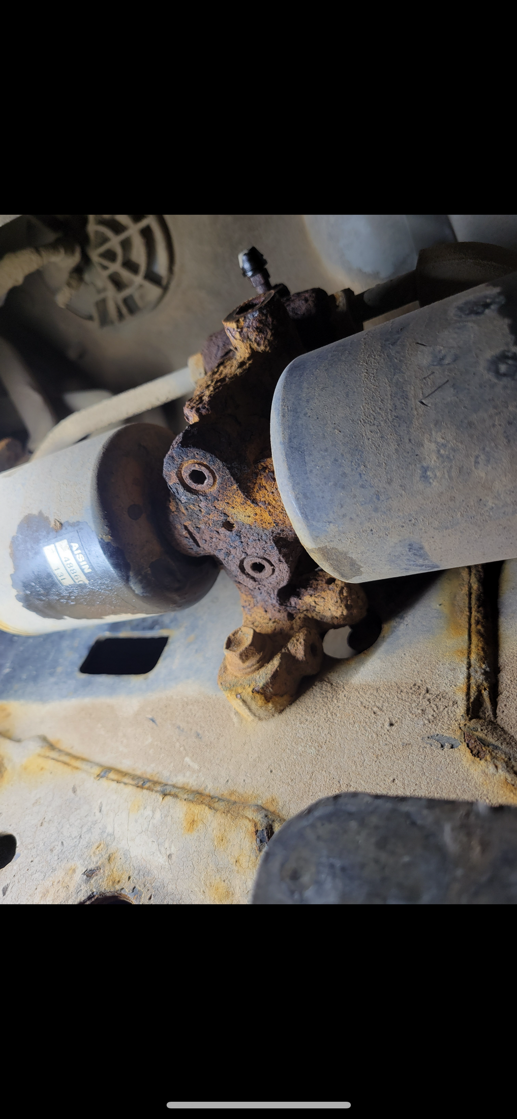

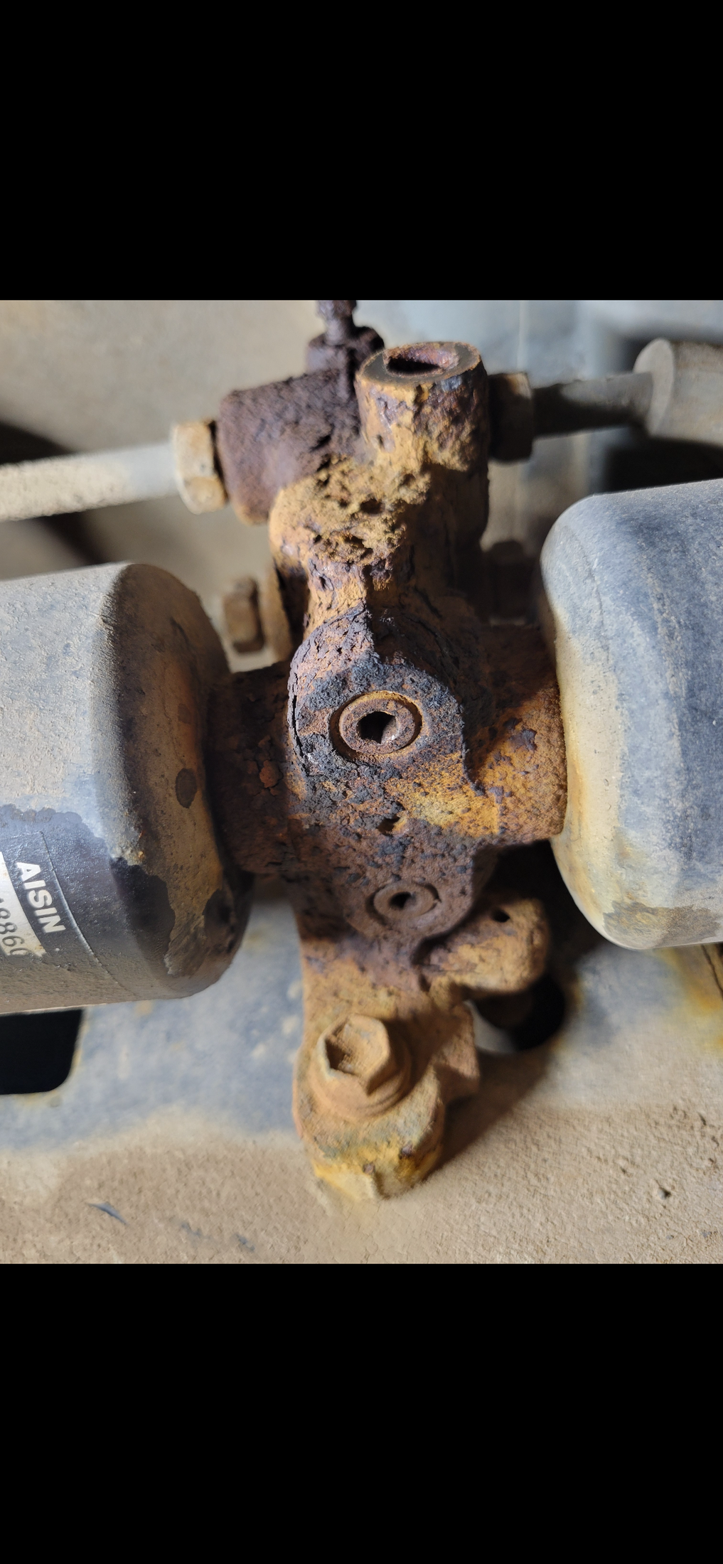

Well, still not done…
They had to take my truck to the local dealership to replace the power steering pump and the 4x4 relay. They did a test drive and got a 4x4 death light and also noticed the truck was leaning to one side. They fixed that stuff, and I’m thankful that insurance covered it.
But now, they have an issue with the two bolts which apparently hold the KDSS system together (?). They’re going to try and apply heat to get these things loose. They also mentioned disconnecting the sway bar.
According to the the tech who is working on it, the reason it’s so rusty - and the reason I’m posting this - is because my Slee skid plates exacerbated the rust issue by not effectively allowing the road salt and water to drain away easily. Wondering if anyone else has had this problem? And for anyone with aftermarket skid plates, check your rig and make sure yours is not as rusted down there as it is on mine!

I still consider my self a newbie, owner for 4 years. However, rusty KDSS is not news to me and there are many posts about it. I’m not saying your skids are innocent but there are many examples of rusty KDSS without your particular skids.
@RandyDaytona I'm going to agree with @Artie here too. The tech saw something NOT OEM and immediately blamed the KDSS classic rust prone nature on it. It's not your skid's fault IMO. The KDSS screws being rusty is a known issue. I am not surprised your dealer tried to blame your skids vs actually say "mea culpa" on behalf of toyota.

Definitely NOT the skids. This is a well known issue with the 200 series LC. Here’s a 235 post thread about the rust.
Good to know - thanks!
Tell the tech he is full of red rust. Clean the KDSS up and slather marine lube on them. And while you are at it drop your spare tire and slather the mechanism with marine lube. That too will rust up and freeze up.
Or lp3 for your spare chain/mechanism.
after removing your rust on the kdss, give it the treatment with whatever goop keeps it covered!
