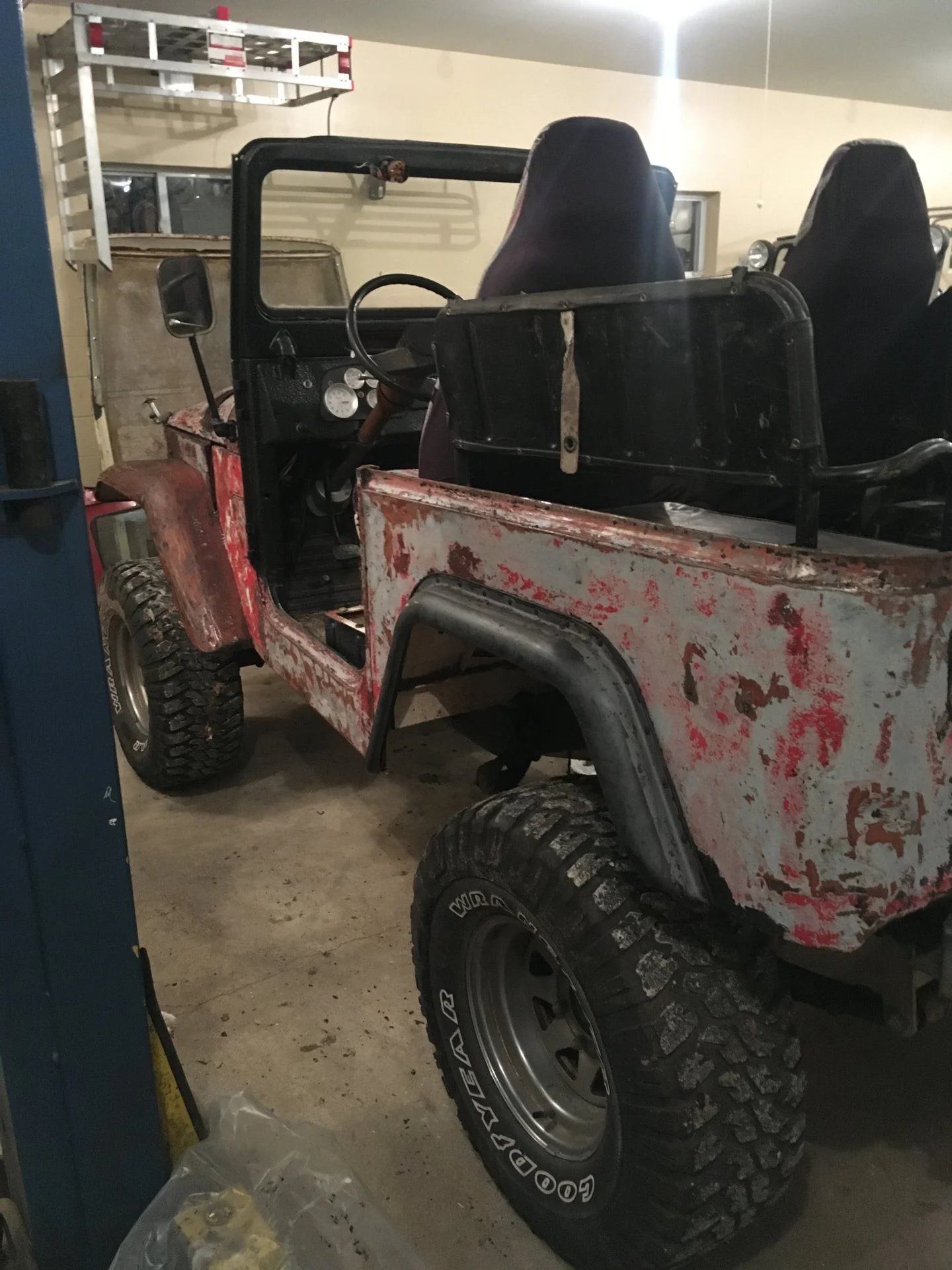

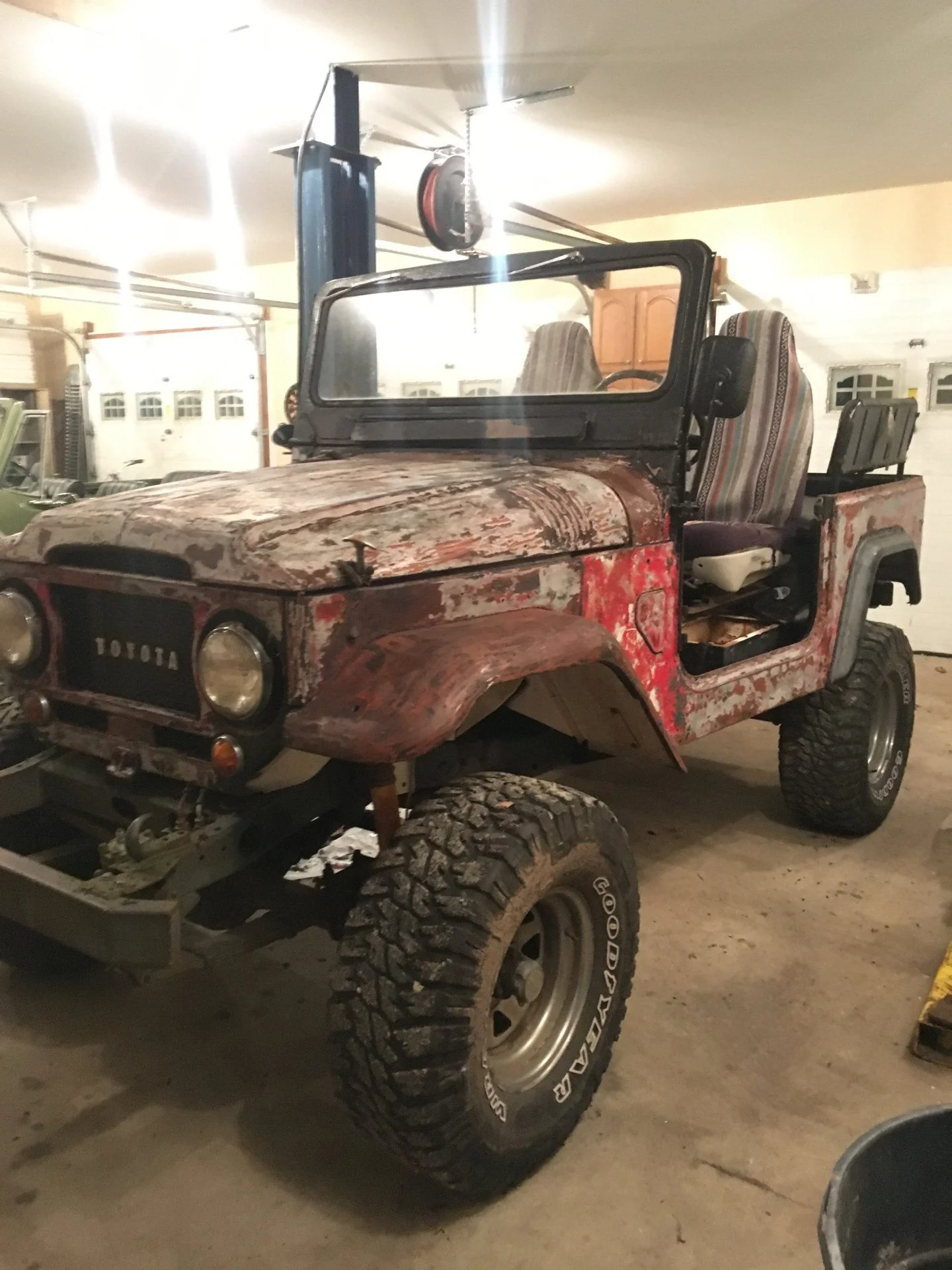

Have a 64 FJ40 that was painted inside and outside with some sort of Herculiner or bedliner. Was wondering if you guys had any tips or suggestions on what has worked best for you. I would really like to get it off and paint the outside of the truck if I can.

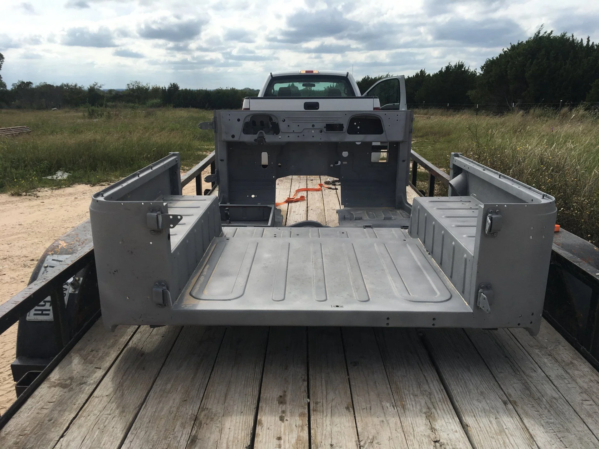

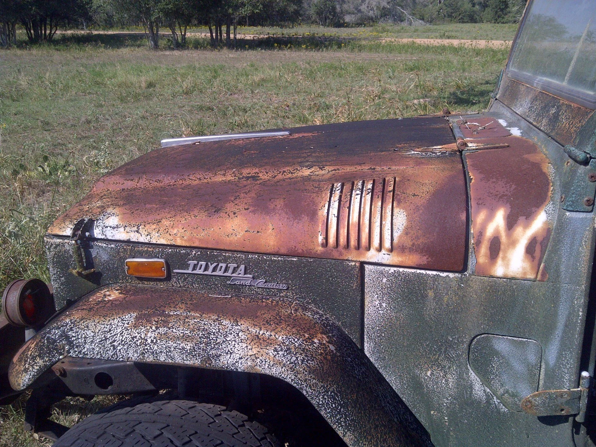

A PO covered the wife's 74 with durabak before I bought it. Aftersitting in the Texas sun for several years it looked like this:
I scraped the remaining liner off the outside with a set of wood chisels from Harbor Freight. I was lucky that he had used an epoxy primer underneath though, I only cut through to bare metal in a few spots which I primered over. It was then sanded and sprayed with rust convertor to stop the rust.

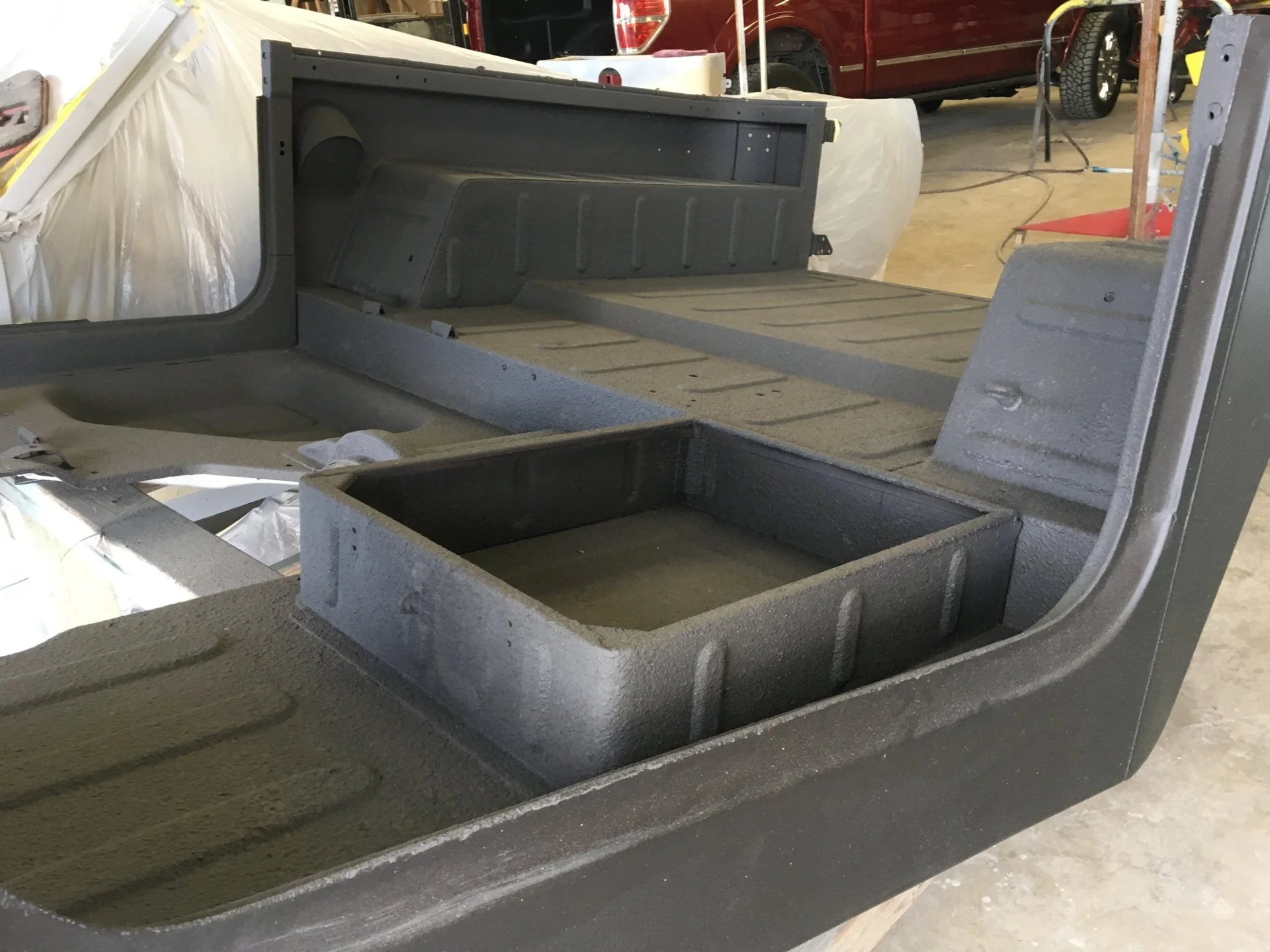

Unfortunately the painter put lizard skin back on the interior tub. He said we should lizard skin the bottom to keep down heat. I thought he meant undercoating. Now I have to go through the stripping process all over.

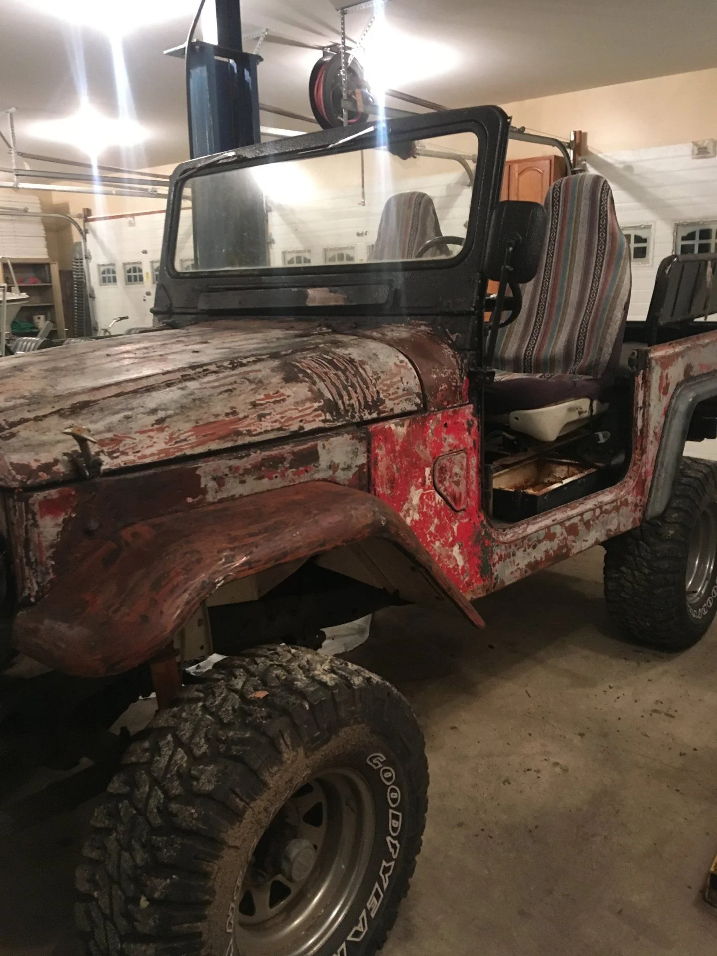

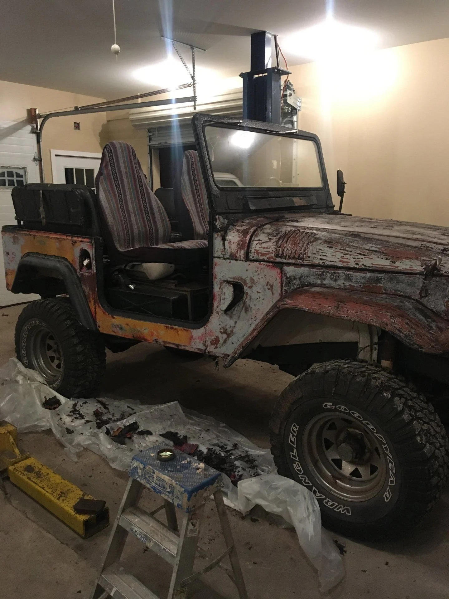

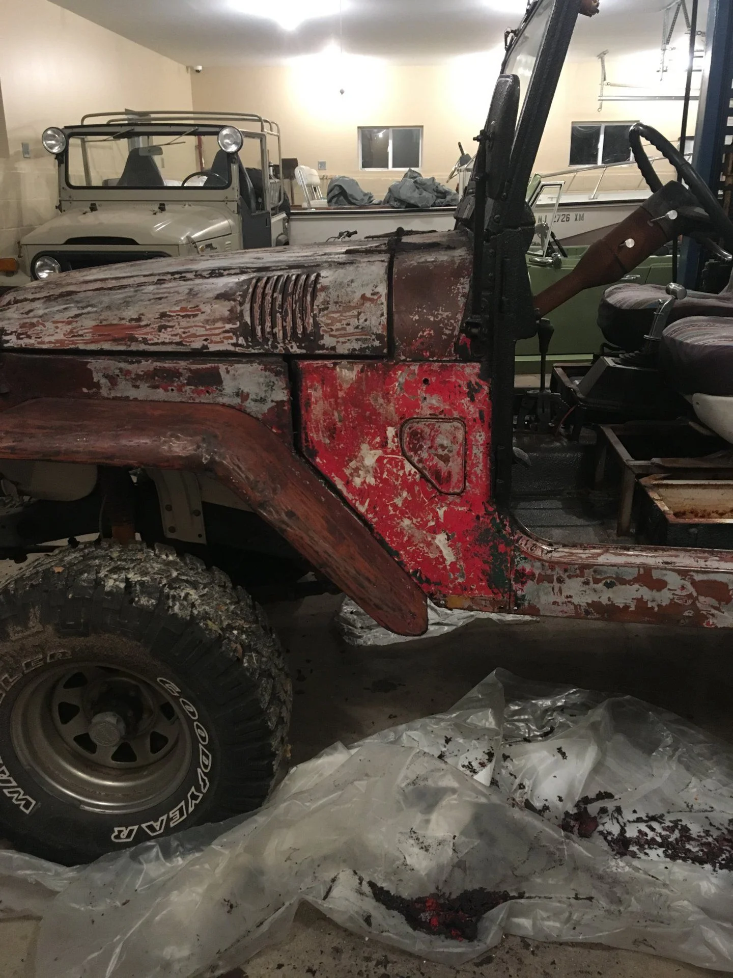

I started to remove the Bedliner today and it actually is going pretty well. I went to autozone to pick up aircraft paint remover and they only had the rustoluem version. I got lucky and it was on sale for $13 gallon instead of 41 so I figured it couldn’t hurt to try it. The previous owner must of put 4 or 5 coats of the Bedliner on, so I lightly scraped the entire body with a flat blade so the stripper could get into the paint. I Put a thick coat on it and worked it in with the brush and then covered it with plastic to keep the moisture in. Really happy with how well it’s going. Going to go try to get more done once the power comes back on, a transformer blew down the street
Power came back on a hour ago and got the rest of the driver side quarter panel and most of the passenger side done. Hopefully have all the Bedliner off the entire outside by tomorrow afternoon
