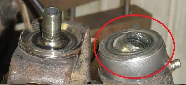

Can anyone explain the process for removing the centering ball in the CV end of a double cardan drive shaft as shown below?

Pull the seal Hugh. :)
Then, work on the bearing.

Seal is out. It was pretty much nonexistent. What was left popped right out.
I can't figure out how to grasp the ball assembly some where with enough force to pull the pressed in ball and race out :doh:

I though about it some and have another idea. There is a hole in the bottom. I think I could put a couple nuts and washer inside the ball, flip it over, put a long 1/4 bolt in the back side through a socket and tighten it down, successfully pulling it out. If that makes sense :meh:

then you should have a 'lip' enabling the internal jaws of the slide hammer to grip for removal.

Neither thing worked. I tried my idea and as I turned the bolt and pulled from the back of the ball, the entire back of the ball broke out. I had already removed the needles and when I tried the slide hammer it pulled the small seal on the inside of the ball out. (I did not realized there was a second seal. There is no lip in there. It is smooth smooth smooth.
I ended up taking a grinder and cutting the ball in half and pulling it out and then cutting the brass race with a dremel. It cracked easily then and I was able to pry it out.
So, I do not know what others do or if there is a right way or a special tool. That is what I did and I did it without damaging the DS.

You'll need a vise
1.) Clean all the needles and crap out of the ball.
2.) Flip the ball over, there may be a pressed in cap, if there is, tap it down into the ball. Hopefully the hole in the bottom is slightly smaller.
3.) Find a bolt that is the same size as the hole in the bottom of the ball, you want it to slide in freely but with as little room to spare as possible, with several inches still showing when it is all the way down in the ball
4.) Wet some paper towel and cram it in the ball. Use the bolt and a hammer to compress it further. Don't get too exited with the hammer.
5.) Repeat step 4 until the ball comes out.
