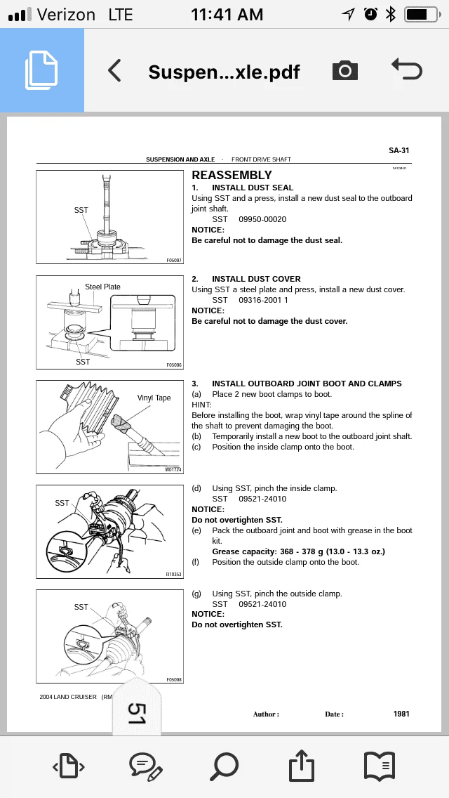

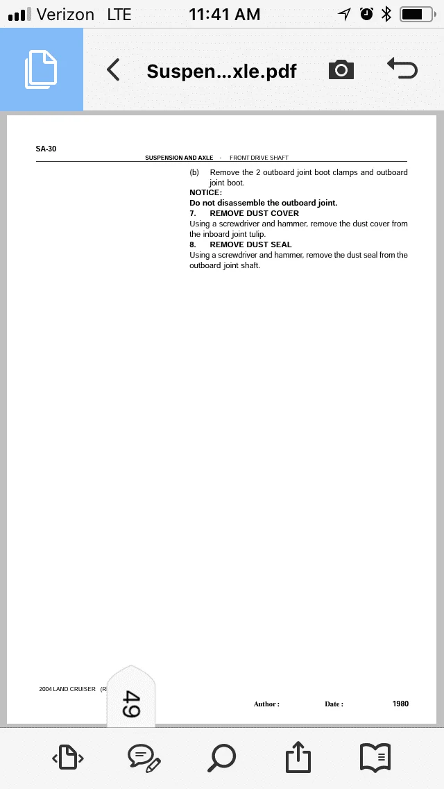

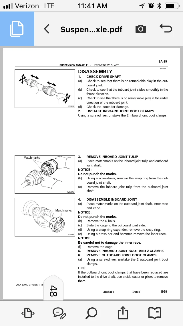

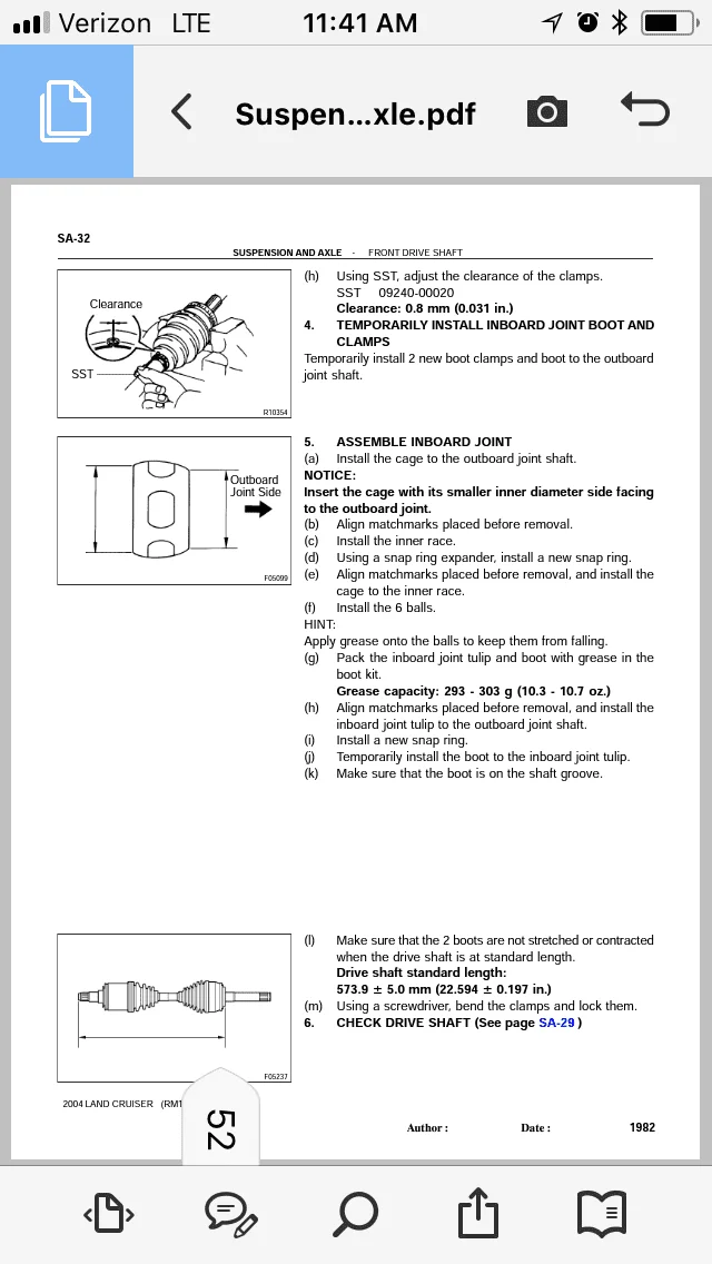

if you going through the trouble of replacing why not just reboot or rebuild yourself
Where can I find rebuild info? There are tons of threads here about CV axles in general. Or do you have a site that sells the parts?
I have an OEM axle with good joints and boots, but stripped splines, just sitting on a shelf.
as long as its not the inboard side you should be able to get parts from your local dealership. if the inner joint is shot out you will need a new axle, only the outer joint is rebuildable. you can reboot both sides
