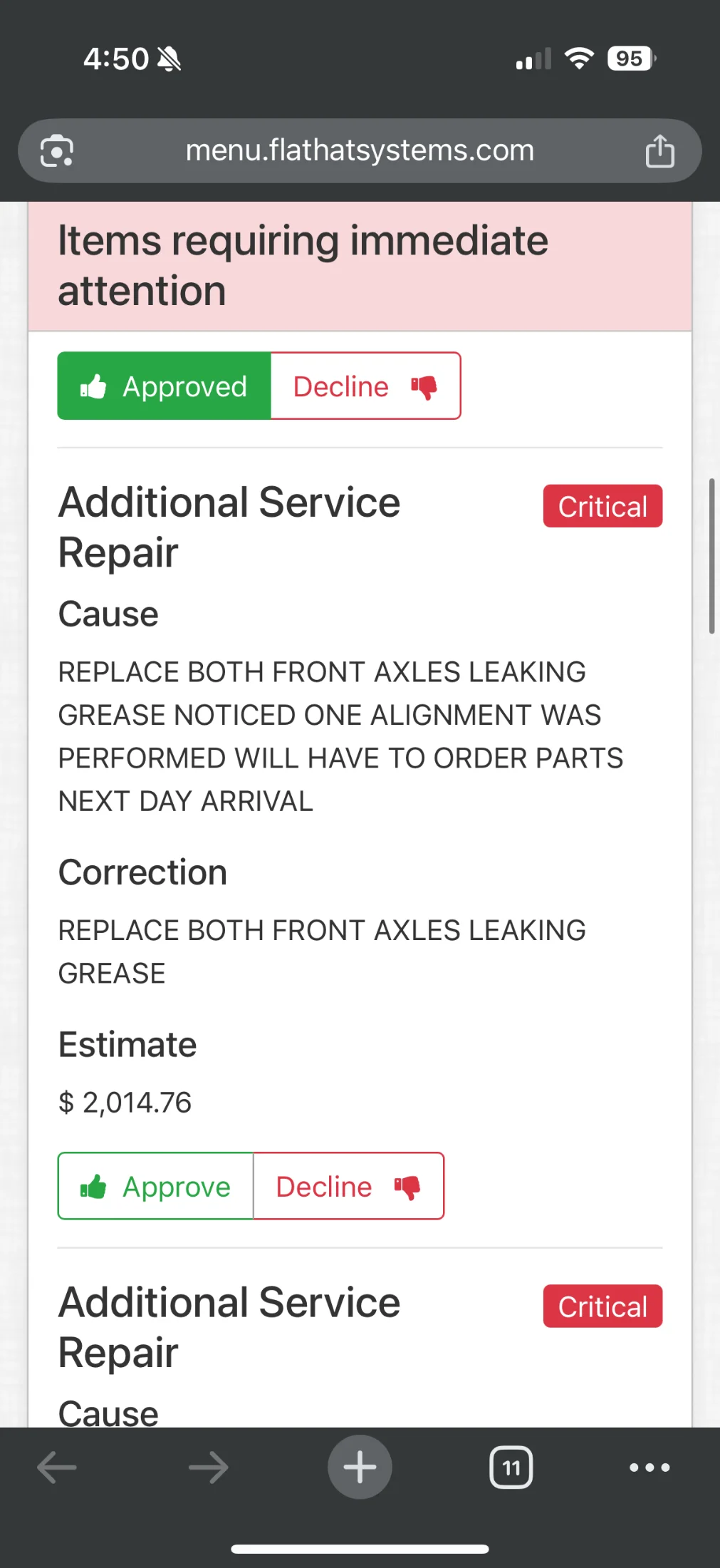

Took my car to dealership for SRS light… they said its driver side seatbelt but they can’t fix it.
They did do an overall inspection and said I need new front axles bc the CV boot had ripped and there are signs of dirt inside.
$2k seems like a ton of money here. Can I just clean the axle and replace the CV boot? Other options?

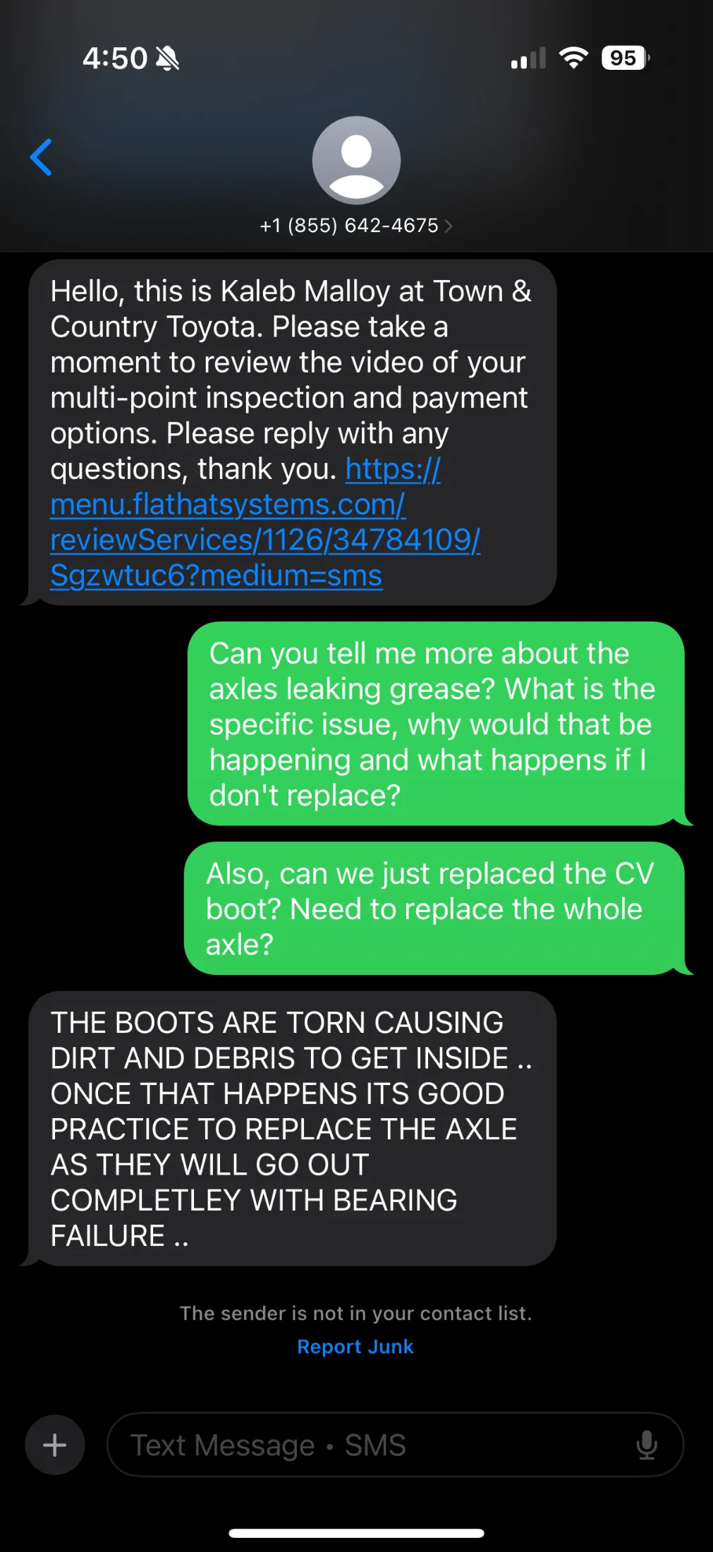

Am I the only one thats borderline furious about the text reply in all caps from the service advisor? Its not even my car and I want to tell him to piss off.
AI is ruining customer service interactions. A dealer will never re-boot a CV axle, and if they did the labor would make the total job just as expensive. Work on your own rig, or pay the dealer tax.
