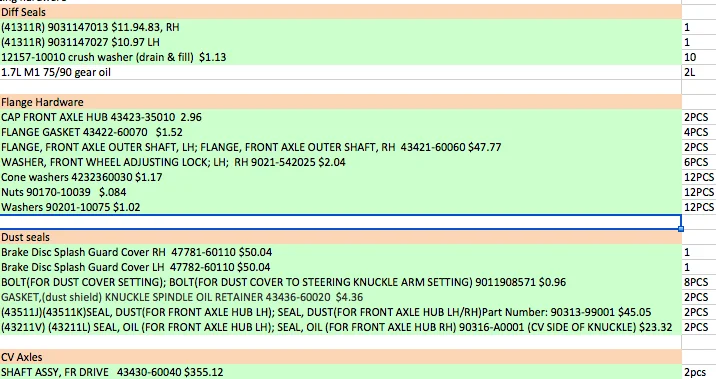

This is the full list to RR with all new parts (not all are necessary its just what I replaced/updated when I did my axles last year). Pick from the list what you want to update and replace. Check for parts updates and pricing updates; its been a year since I did this job. I ordered from McGeorge Toyota.

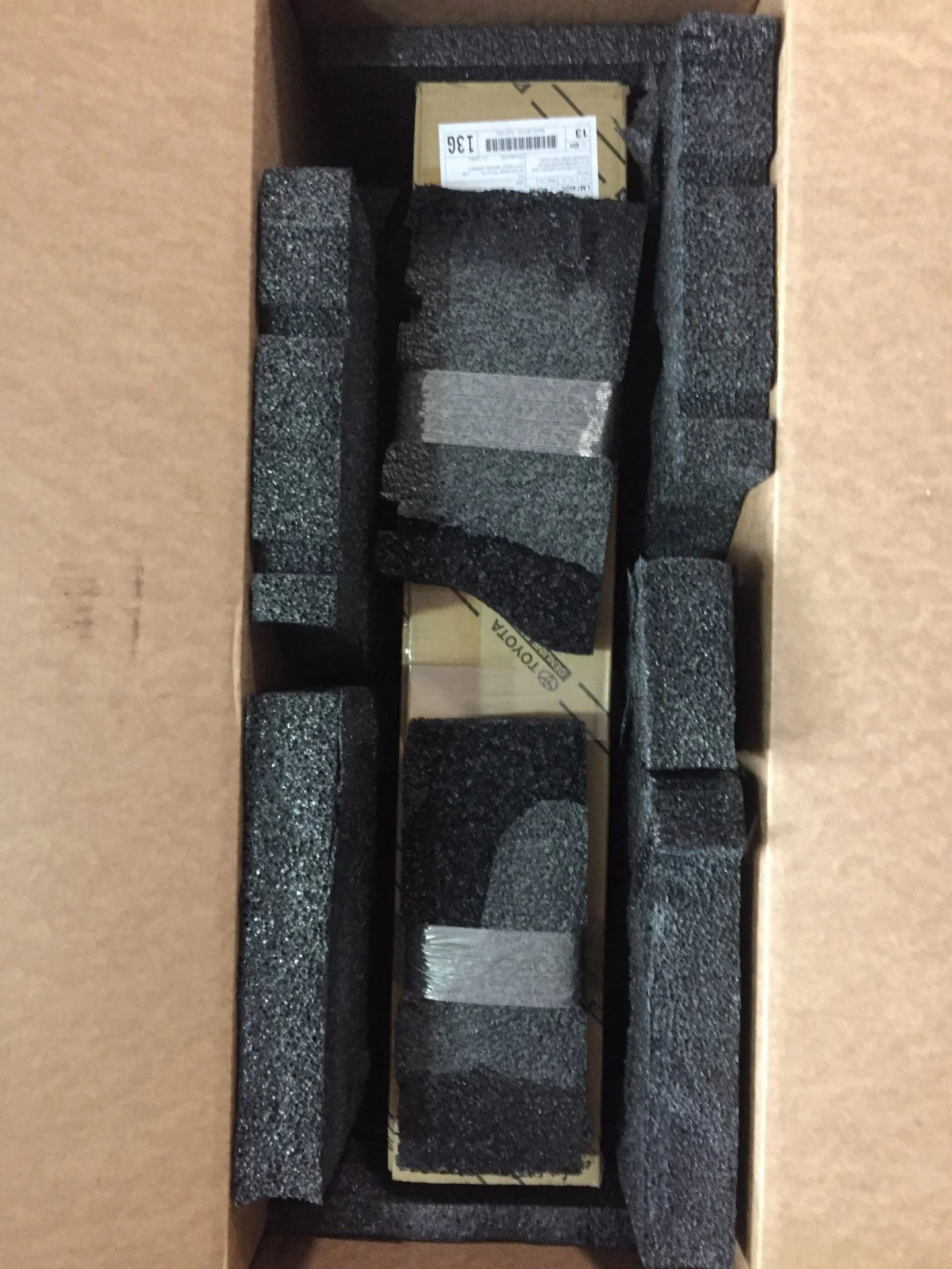

First set of axles I ordered came as you described axle poked through and dust shield bent. After some packing tips exchanged, this was how the second set arrived; could have been thrown from the truck and be ok.
As they are packed from Toyota they are prone to easy damage, Mcgeorge adopeted a good packing protocol to limit shipping damage claims.
(....there is a cv axle in there)
