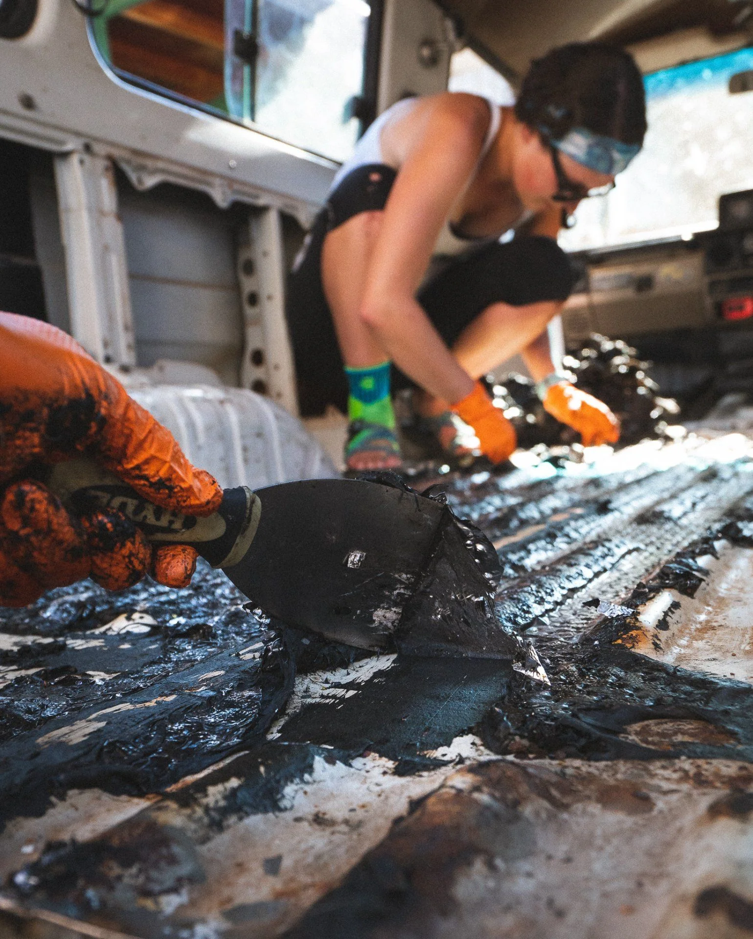

I removed the temporary kitchenette, rolled up the cargo mat, unbolted the front seats, and got to work peeling up the adhesive sound deading already installed. Olivia and I thought about leaving the current sound mat for about two seconds, but the off-gassing and melted foam put an end to that. Earlier this spring we met up with Tim and Kelsey of @dirtsunrise for a beer and to swap a few stories. As they were touring us around their pop-top 80 series the mentioned they had used a product called Lizard Skin on their floor pan. The company makes two spray-on products, a sound deadener, and a ceramic thermal insulator.
We were quickly sold on the product. We needed something that would work on our floor pan/walls, in addition to the underside of our hood. The 12H-T contributes a significant amount of the driving noise, so it will be one of our primary focuses.
I am currently in the process of removing the off-brand Dynamat which has been quite a pain. The heat of summer has melted the mat into a goo reminiscent of cake batter. We are hoping to have the floor cleaned by the end of this weekend so we can repair interior rust early next week. Eight gallons of Lizard Skin (4 sound, 4 thermal) are en route to our house and once the rust is addressed we will prep for paint.

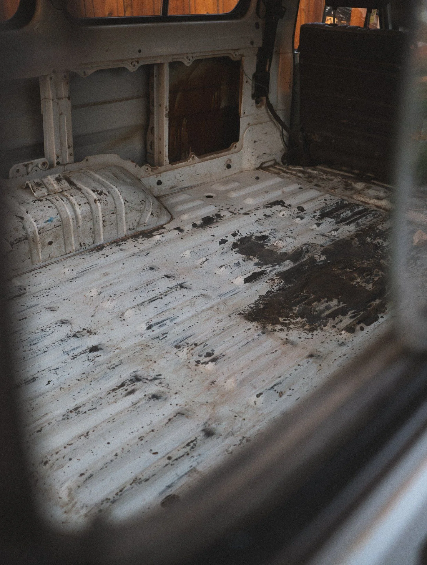

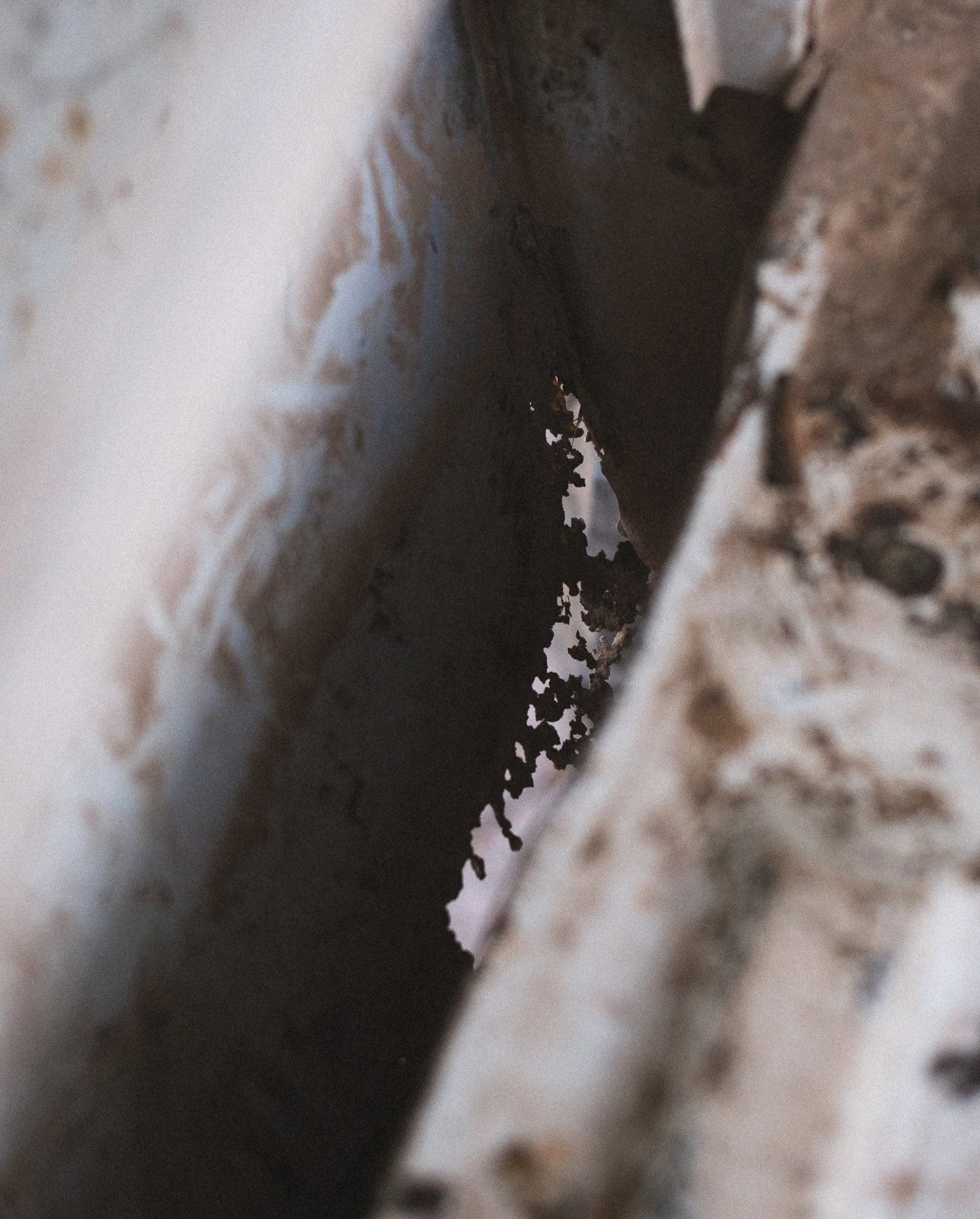

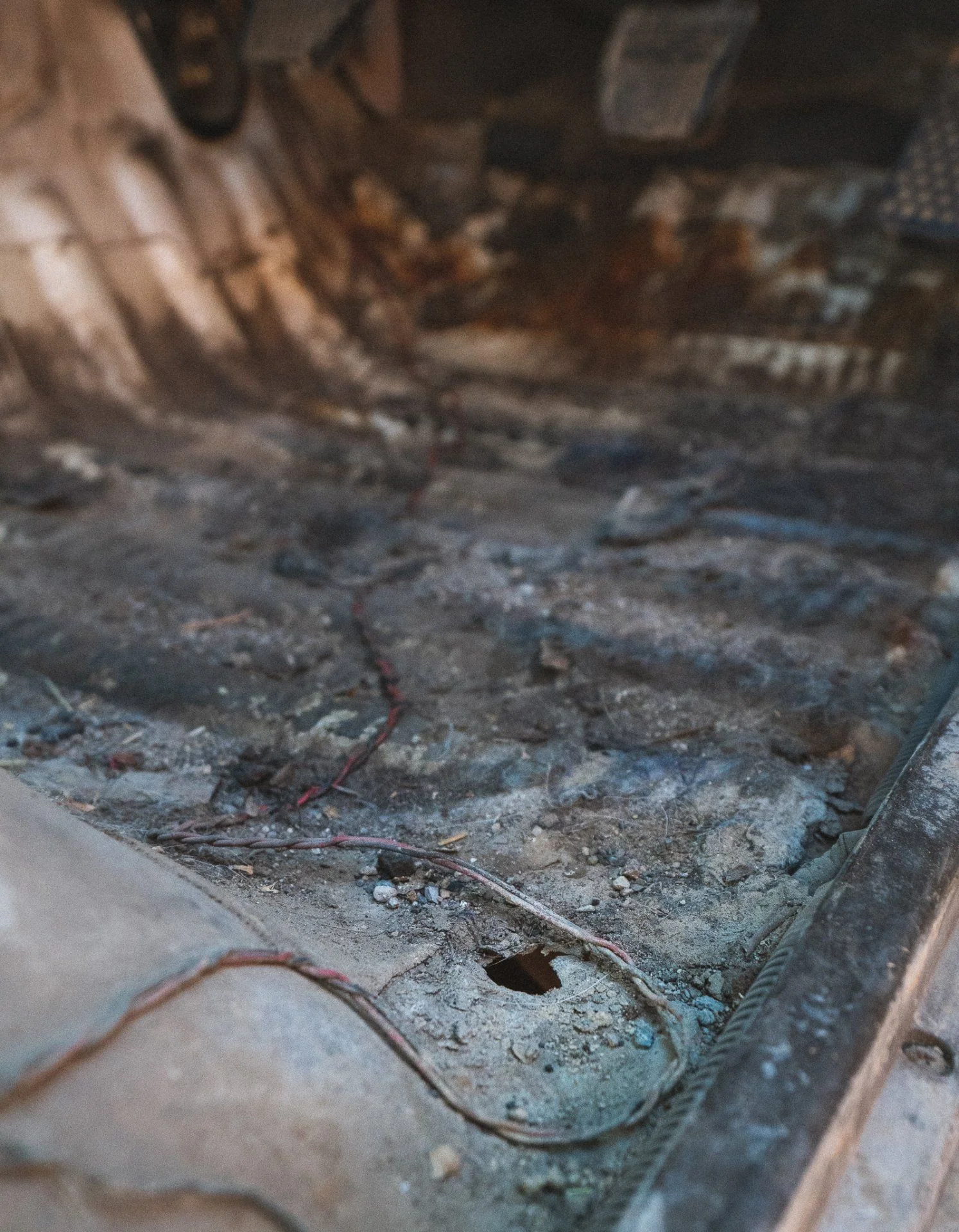

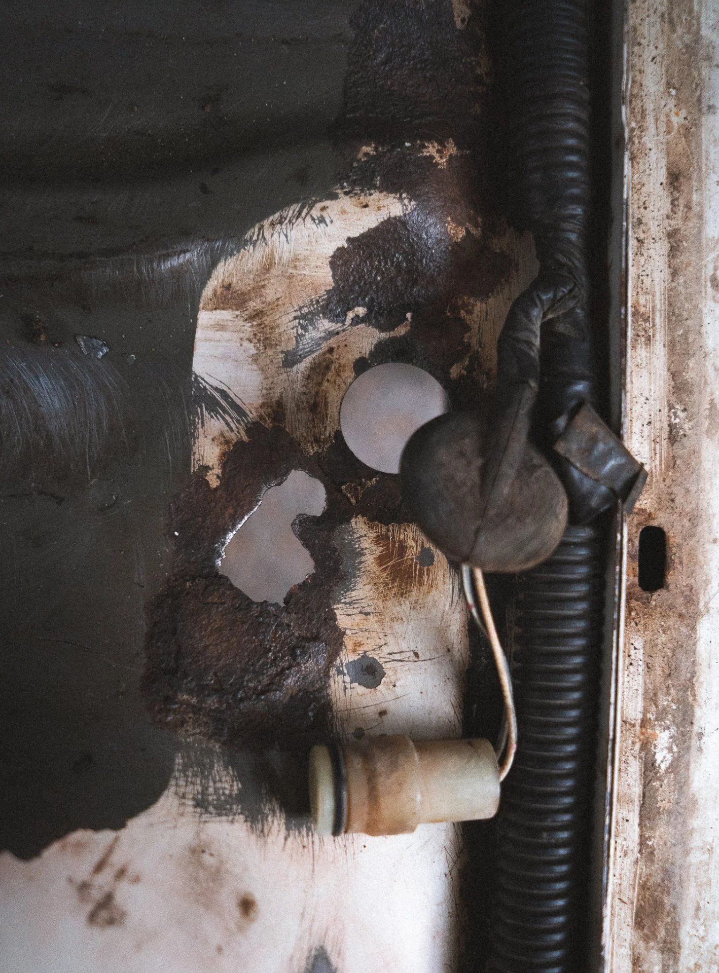

After this experience, I don't know that I would ever put an adhesive layer in a vehicle again. It sounds like when the previous owner put the Noico down there wasn't much rust, now there is a fair bit of pitting and a handful of holes. The Lizard Skin will prevent any accumulation of moisture between the insulation and metal. The cargo area will have the vinyl flooring and buildout to dampen noise as well, and in the cockpit, I will likely put some form of non-adhesive mass noise dampener down. Then the stock floor mat on top.

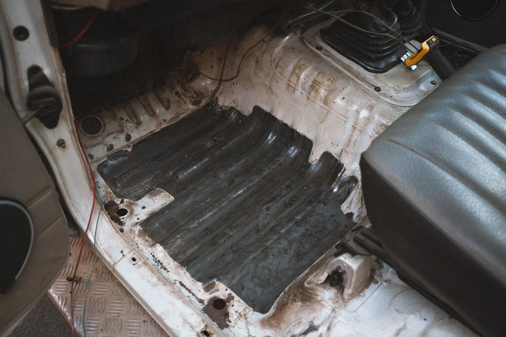

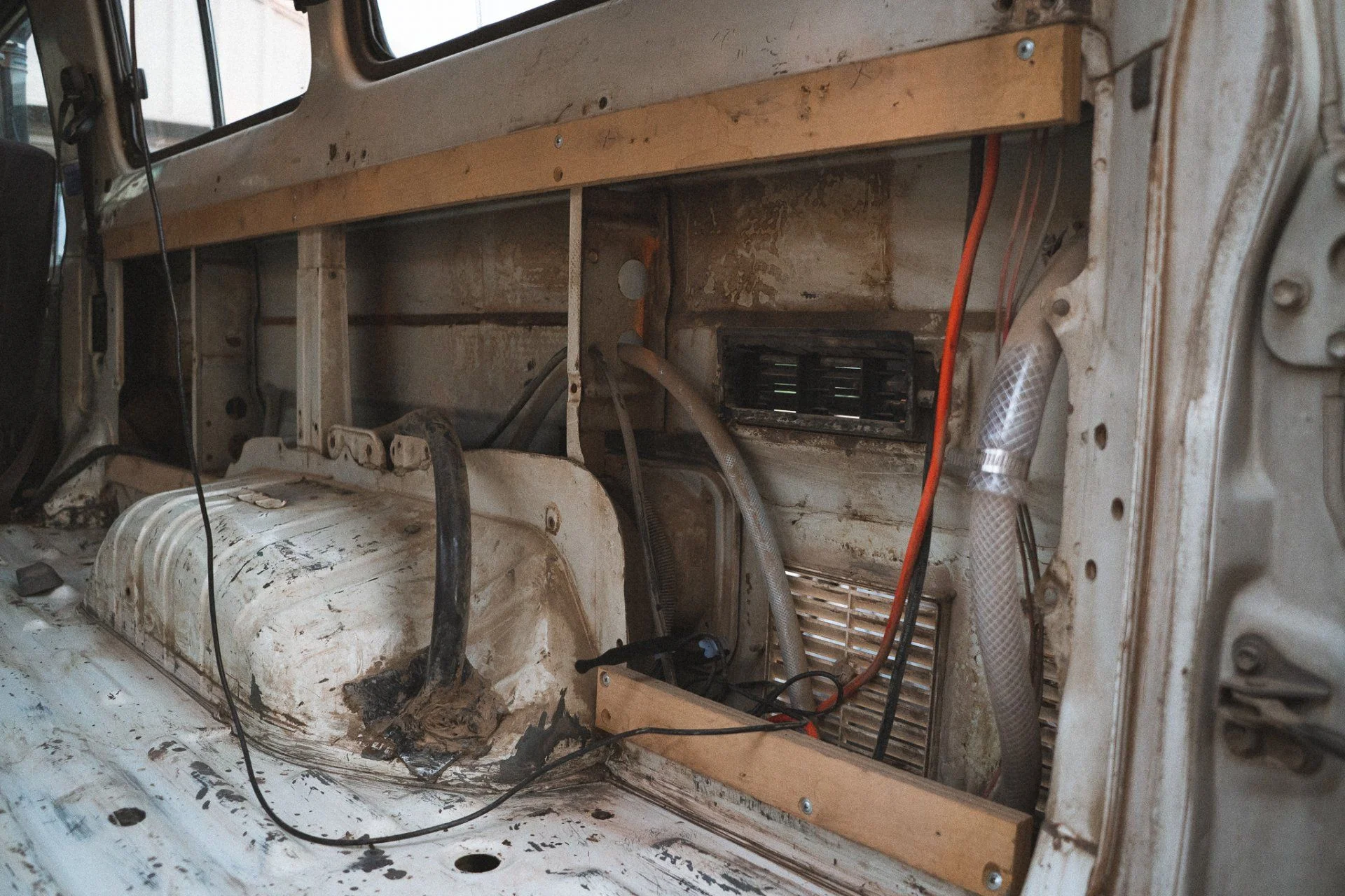

Making a bit of headway in prepping for spraying on the Lizard Skin. Most of the floor has been cleaned up and brushed with a brass wheel. Hoping to start patching the holes early next week. Gotta learn to weld first haha
Still need to get the walls cleaned up and figure out what to do with the large vents on the back right panel. We are planning to install an Espar D2 diesel heater, but I don't think the current vent setup is going to be the best setup. One step at a time.
If you do it right, there should be no issue putting down an adhesive sound deadener first. All about the prep of that rust....which is the biggest challenge generally. I'm not sure I've ever found rust under OEM sound deadener that we have removed. Always perfect under them with rust everywhere else.

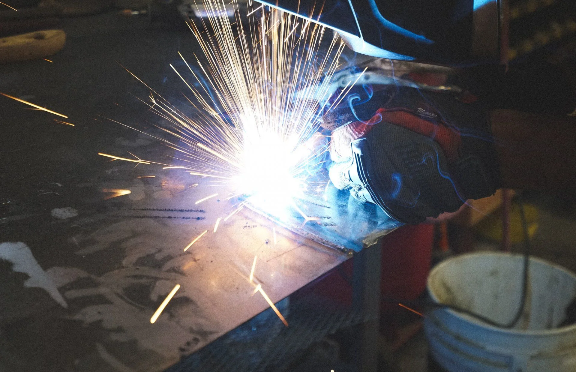

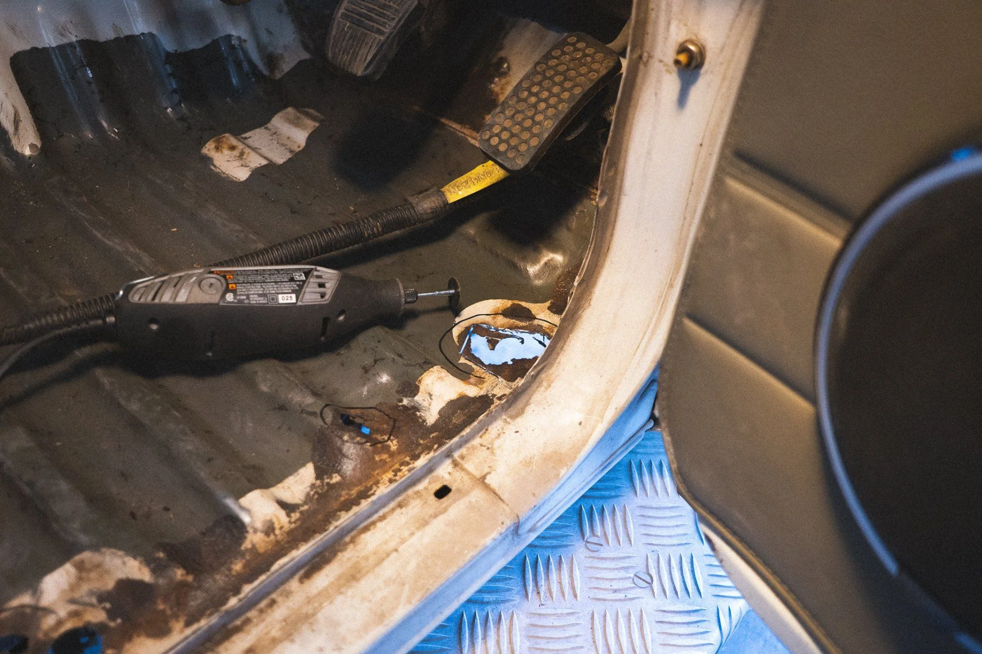

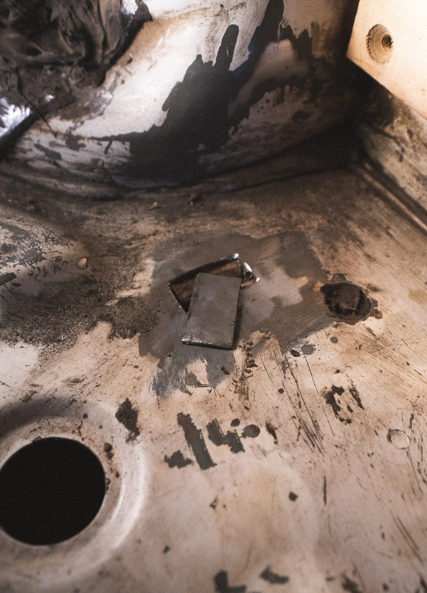

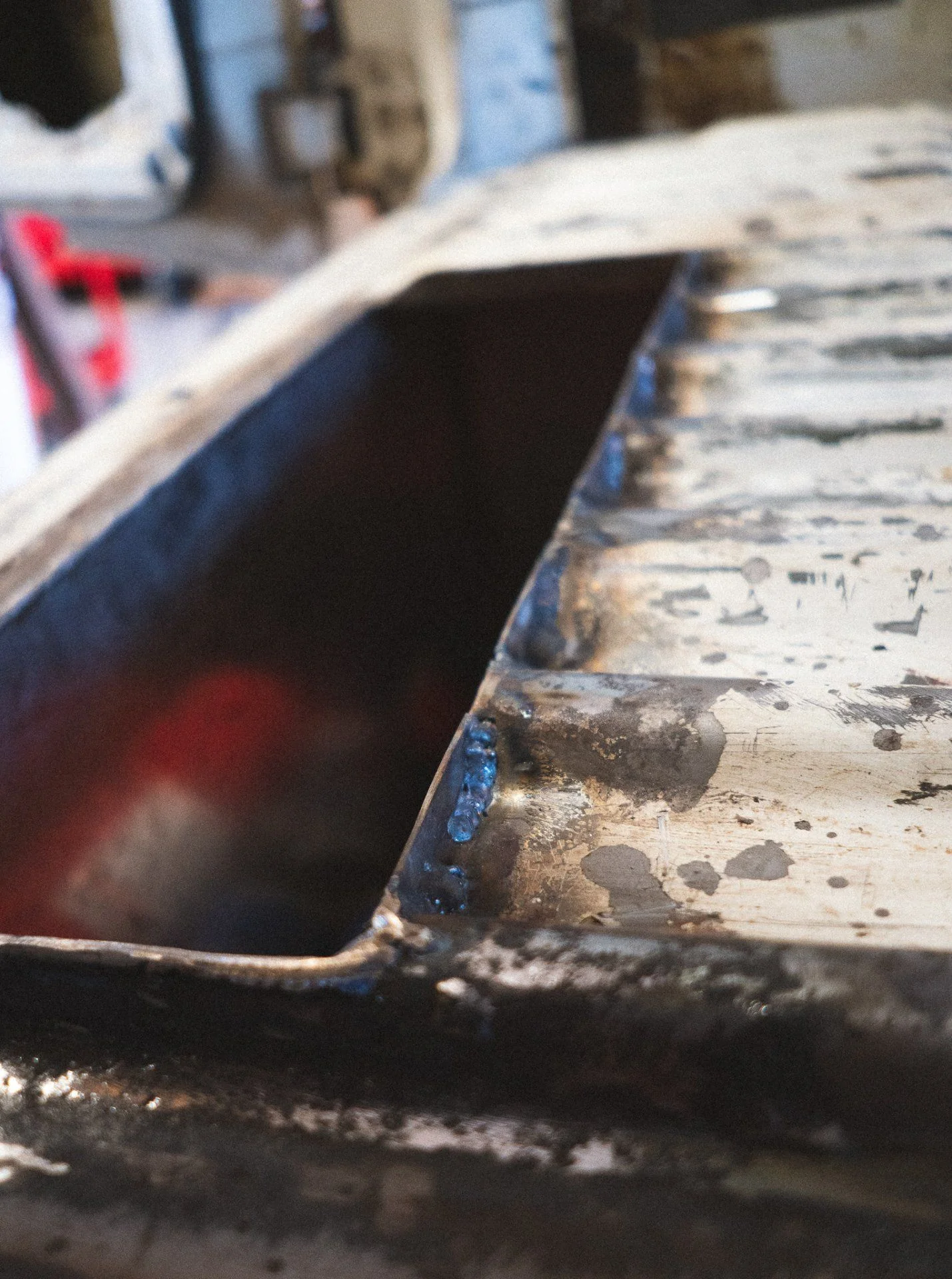

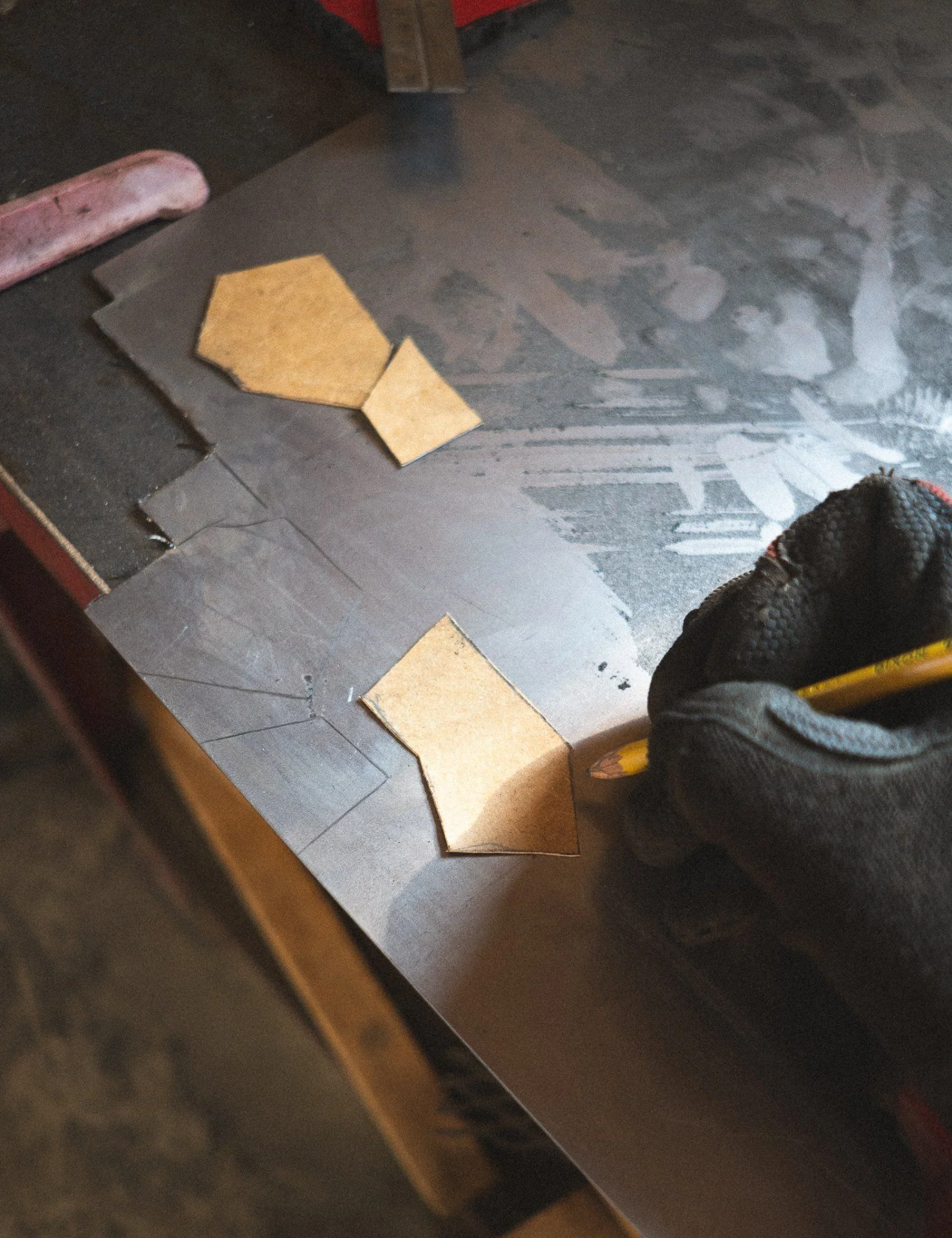

Before I tackled the welding myself, I wanted to get a quote from a place in town. Mostly to make sure doing the repair myself was the best use of time/money. The shop quote me $4,500, not including the rain gutter/door frame rust or the shaping of the rear body panel. I'm sure by the time all the body rust was gone we'd easily surpass $10k. With that knowledge, I set to learning how to weld! Thankfully my parents have a nice shop with welding equipment that made the process easier.

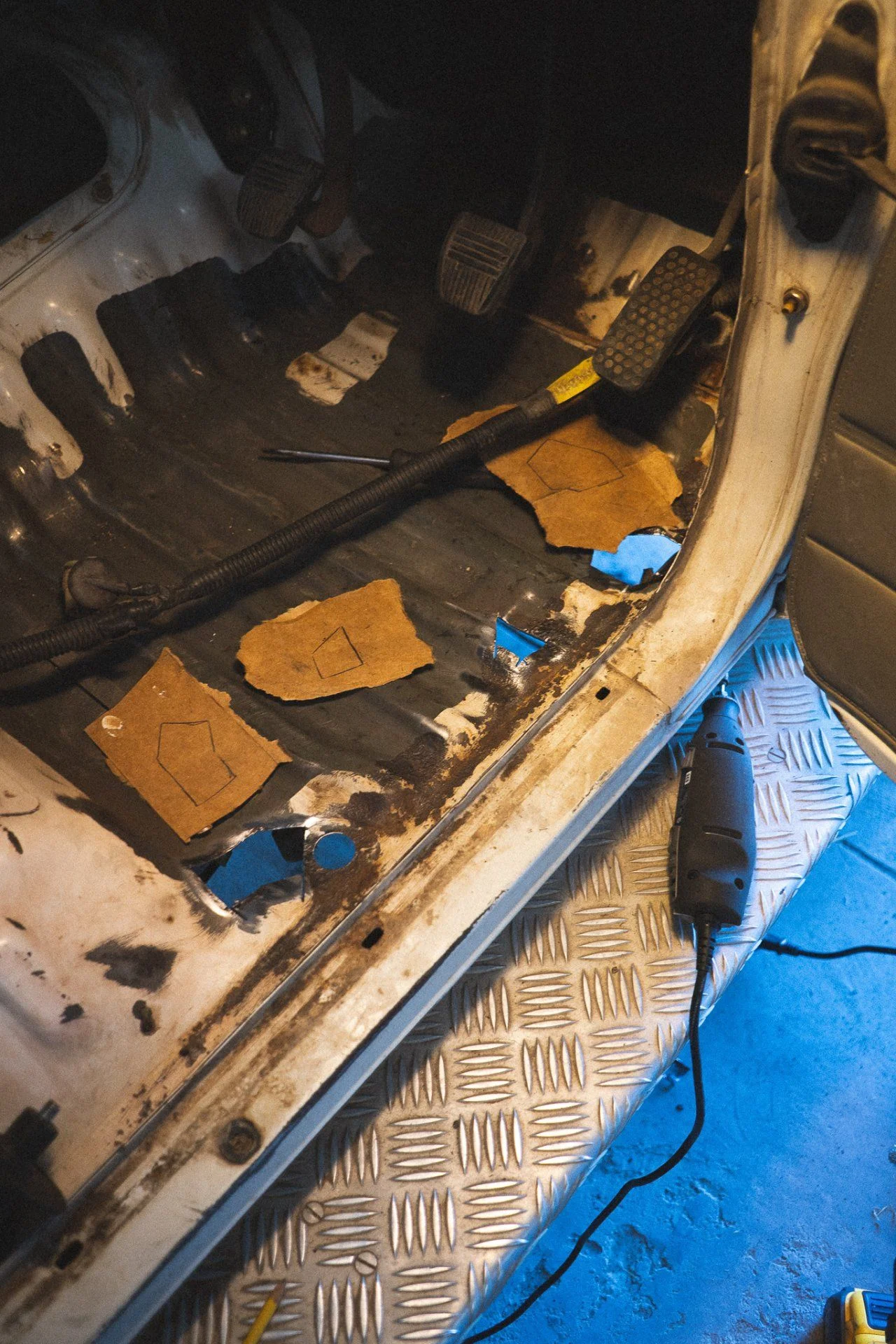

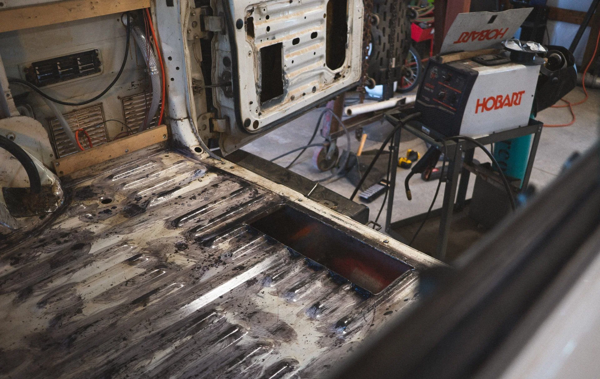

I practiced for about 6 hours over two days before getting started on the cargo area of the Troopy. The fresh 18 gauge sheet metal was easy to melt on its own, but the rusty bits liked to disappear in a flash. Shaping and welding in new sheet metal was fairly straightforward, but the smaller pinholes required a fair bit of finesse.
In general, the cargo area was a simple job. I had plenty of space to work and there wasn't much shaping of the new metal. I also finished welding our "secret compartment in". Whoever initially installed it thought tacking it in and sealing it with silicone was good enough despite a few 1/4" gaps. After everything was patched and cleaned up I threw a coat of Coraseal on all the exposed metal and called it a day.

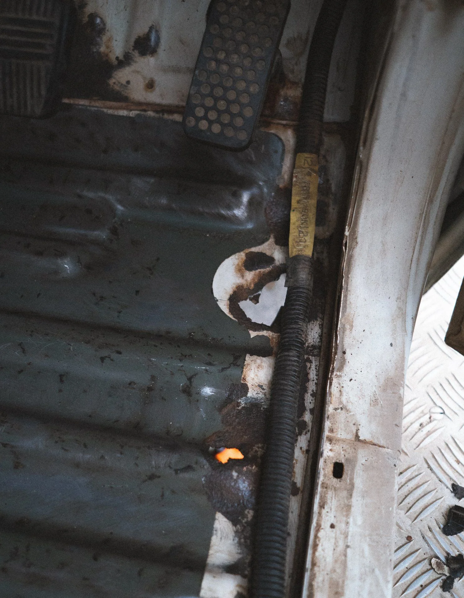

The next day I finished the drivers footwell. It was a little tricky to get everything shapped and lined up properly and welding in such a tight space was a challenge. This is the last rust repair we will do for a few weeks. I need to remove the windows before fixing anything else.

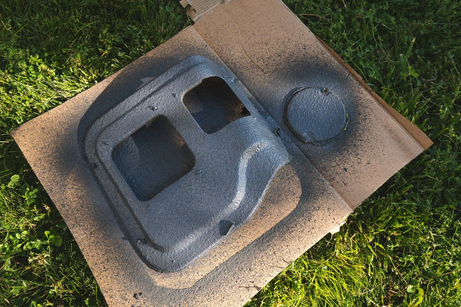

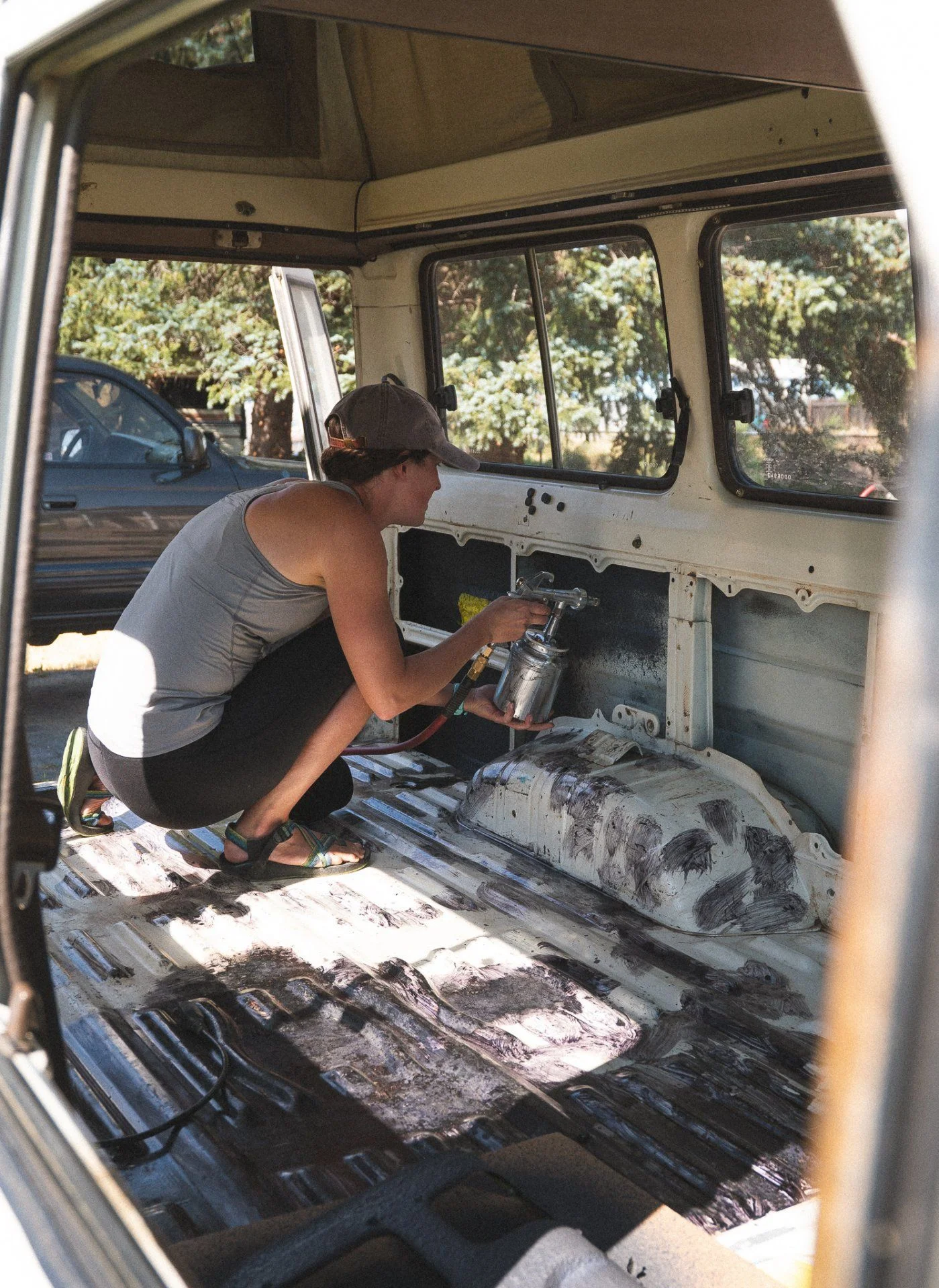

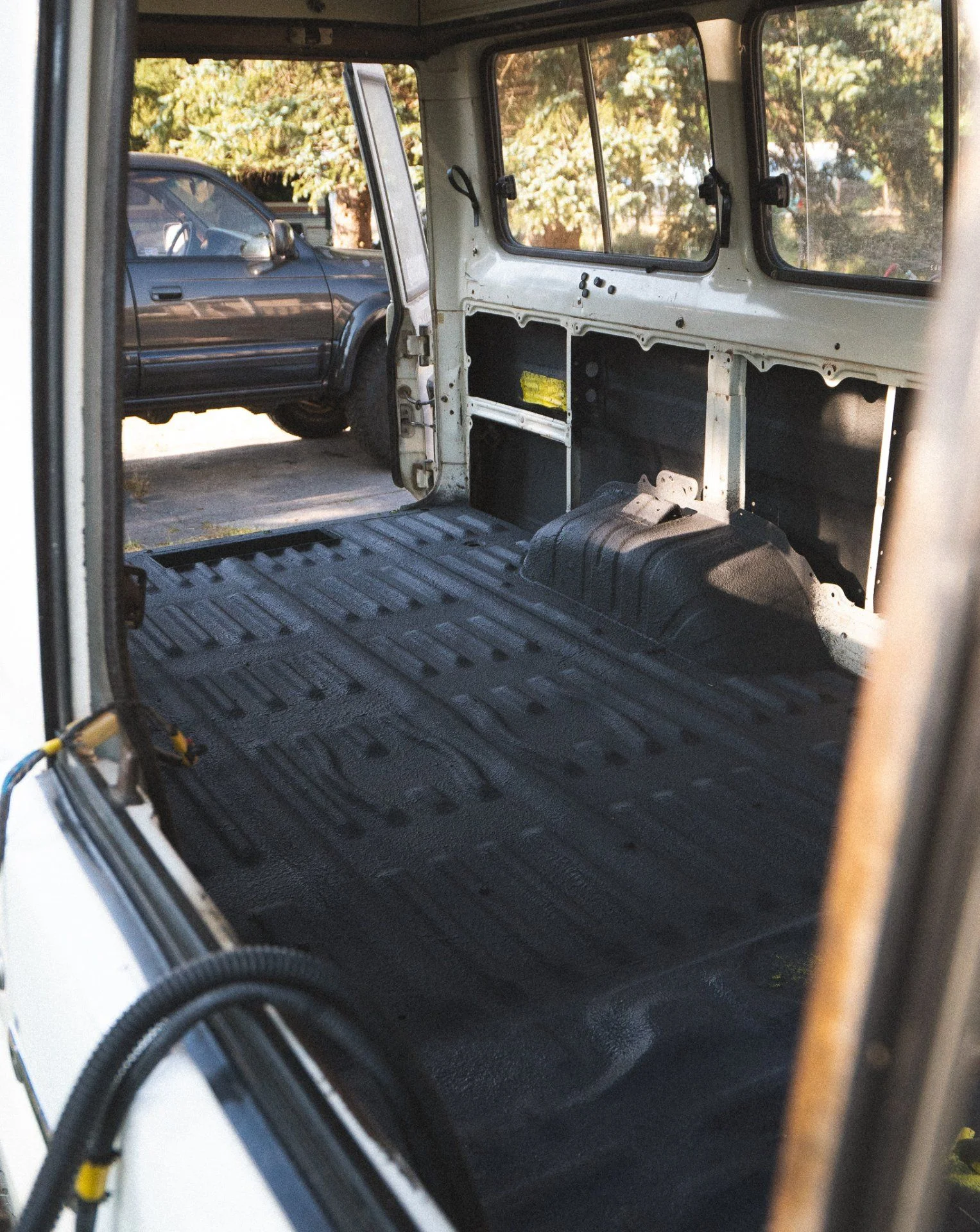

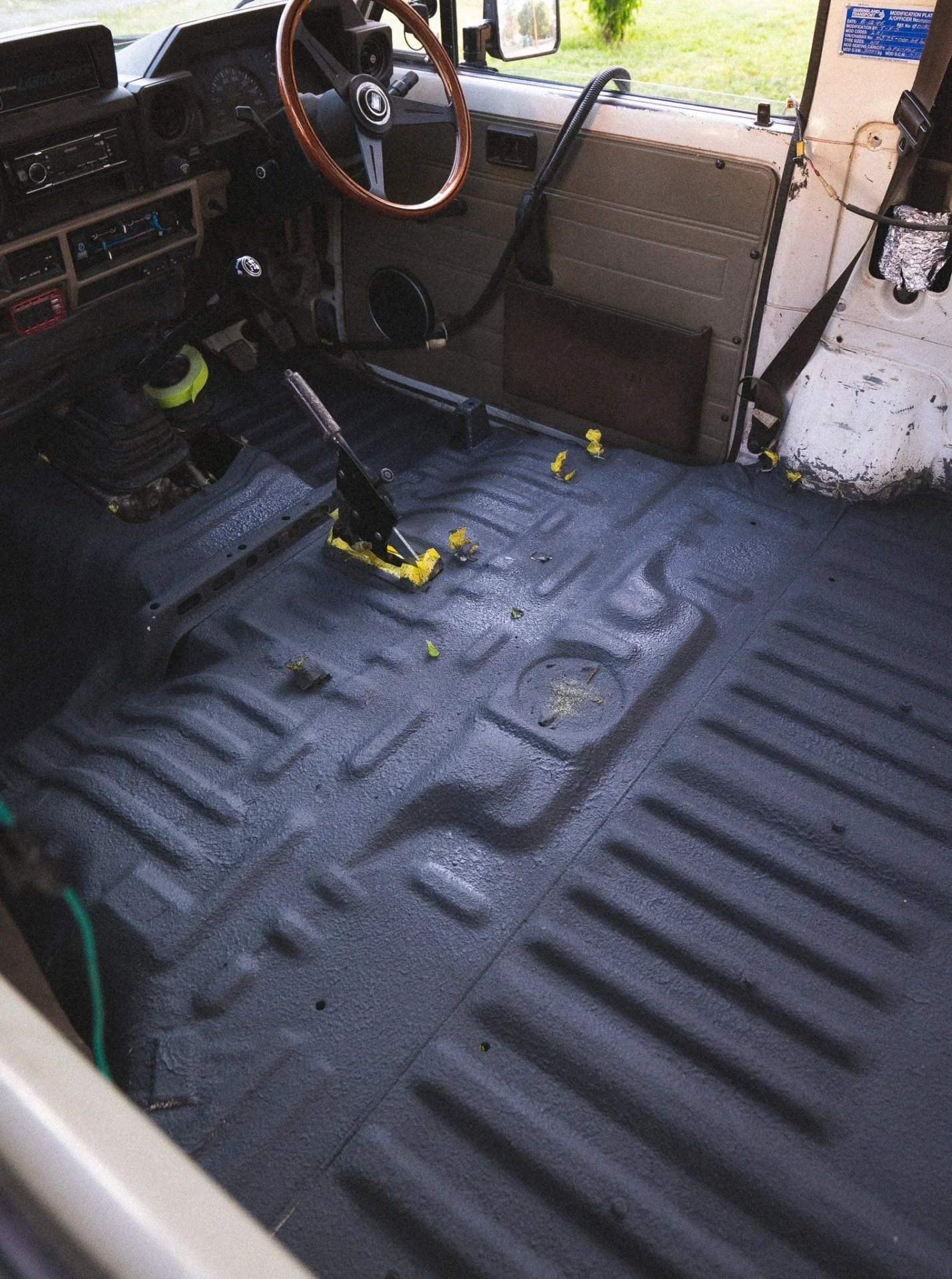

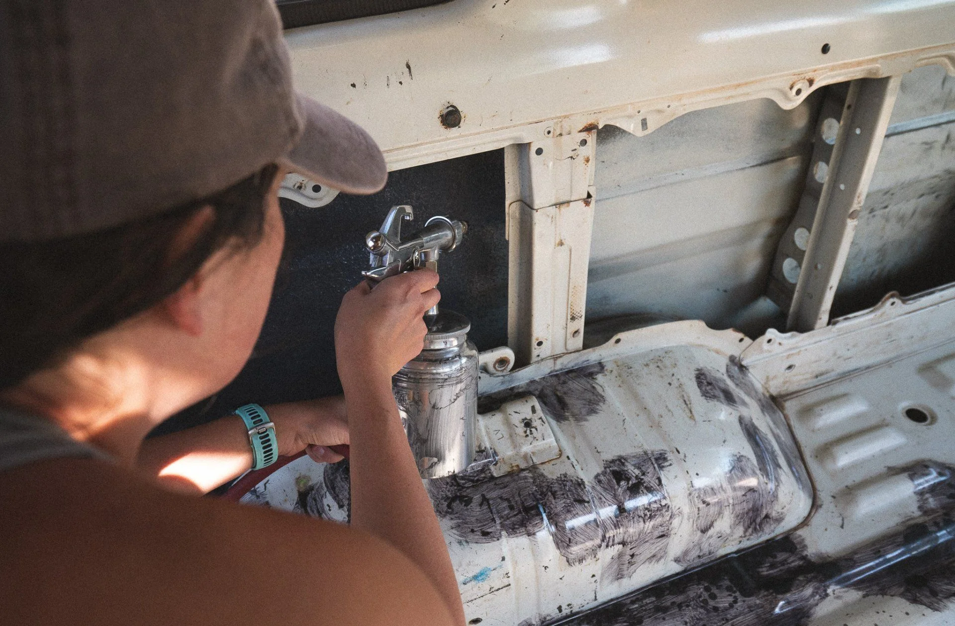

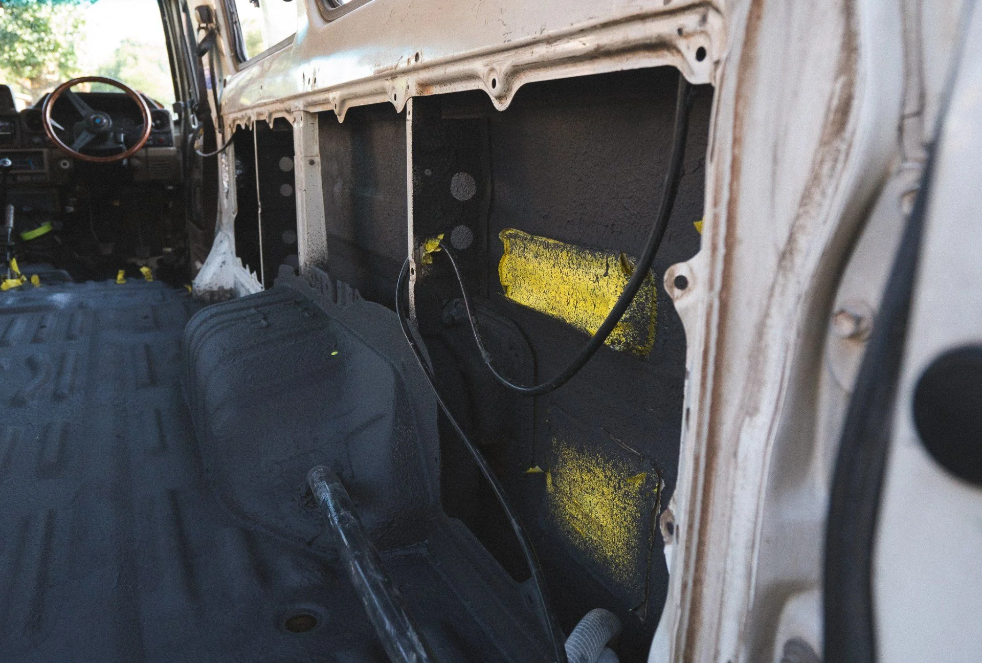

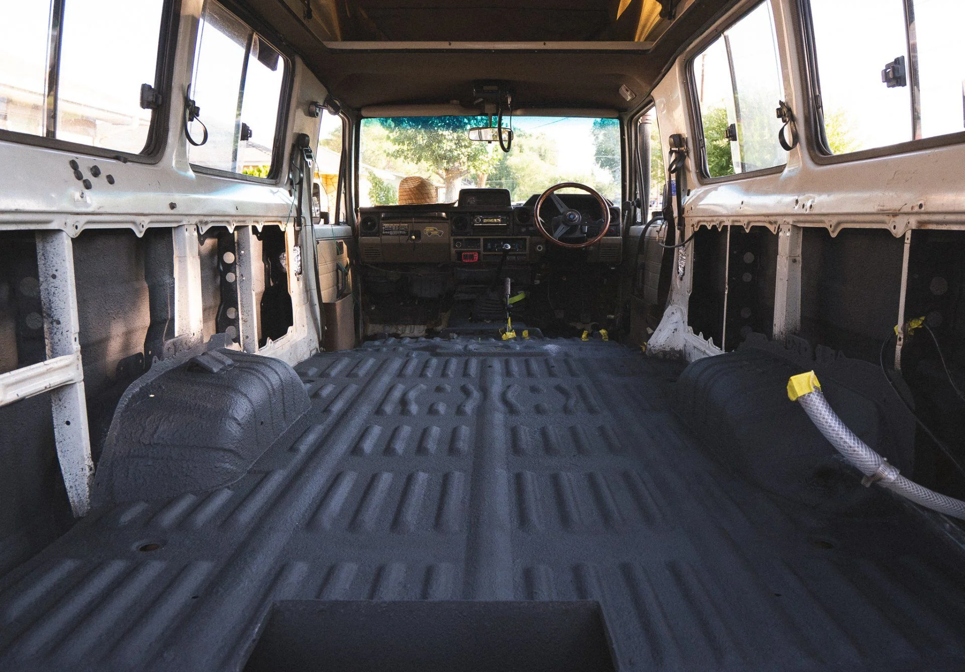

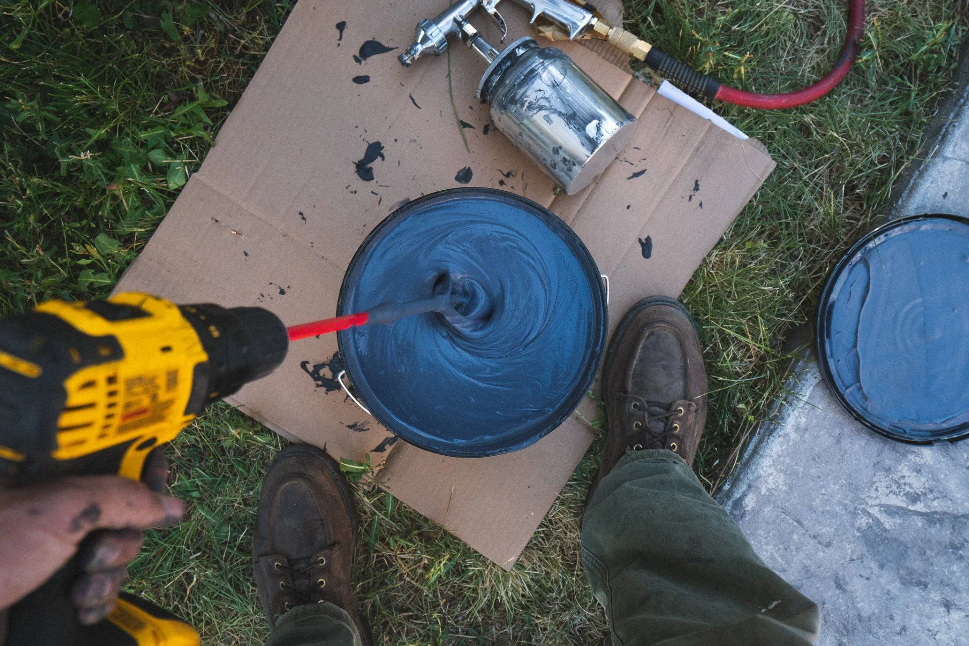

Yesterday we got started on the application of the Lizard Skin sound control. It took awhile to get everything prepped: removing the remaining greasy/oily areas, tapping, and a light sanding of smooth areas. When doing the sound control and ceramic spray, the sound control needs to be sprayed on first and allowed to cure for 24-36hrs. We did the first coat and a second about two hours later.
We tested the spray on the transmission cover and front fuel sender port. I was a little surprised at the spray pattern, it was more of a spitting action than an even spray. It was a pretty easy process and getting the tight spots sprayed wasn't much of an issue.
We are really impressed with the results of the first coat. Feels nice to have a solid looking cargo floor. Despite looking like a bed liner the stuff wouldn't hold up to the abuse of heavy loads scraping on it. I think it would hold up well to standard use under a carpet or soft floor mat. I will finish spraying the underside of the hood this evening and tomorrow we will spray the two ceramic coats. After that, We will be installing Lifeproof flooring. This weekend will be a good test of the product as we drive the length of the Oregon coastal highway. Gonna be a bit of a push to finish step in time.
