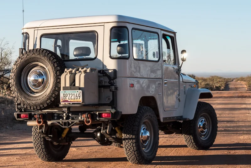

Stout Equipment rear bumper/carrier (sadly no longer made) with welded shackle mounts.
What are you guys doing on the rear?
4+ bumper with integrated recovery points welded on. Sorry if hard to see in this photo:
