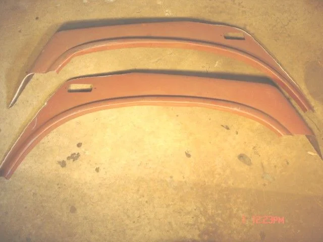

I have most of the front arches still intact. You can have these for shipping.

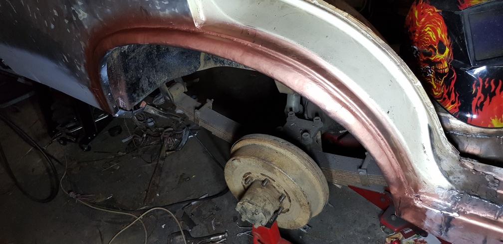

Bringing back a really old thread..., but we still have this problem. Since we aren't lucky enough to get panel replacements for the 55, what are others doing to replace rear wheel well arches? Somewhere I read on Mud there was a quarter panel patch from a utility bed that had an arch that was very similar but I can't locate the thread any longer so, please chime in with ideas. I don't mind buying equipment to make them either if that's what I need to do, but I don't want to re-invent the wheel if I don't have to.
Thanks, I don’t think I would have been able to find that again.
