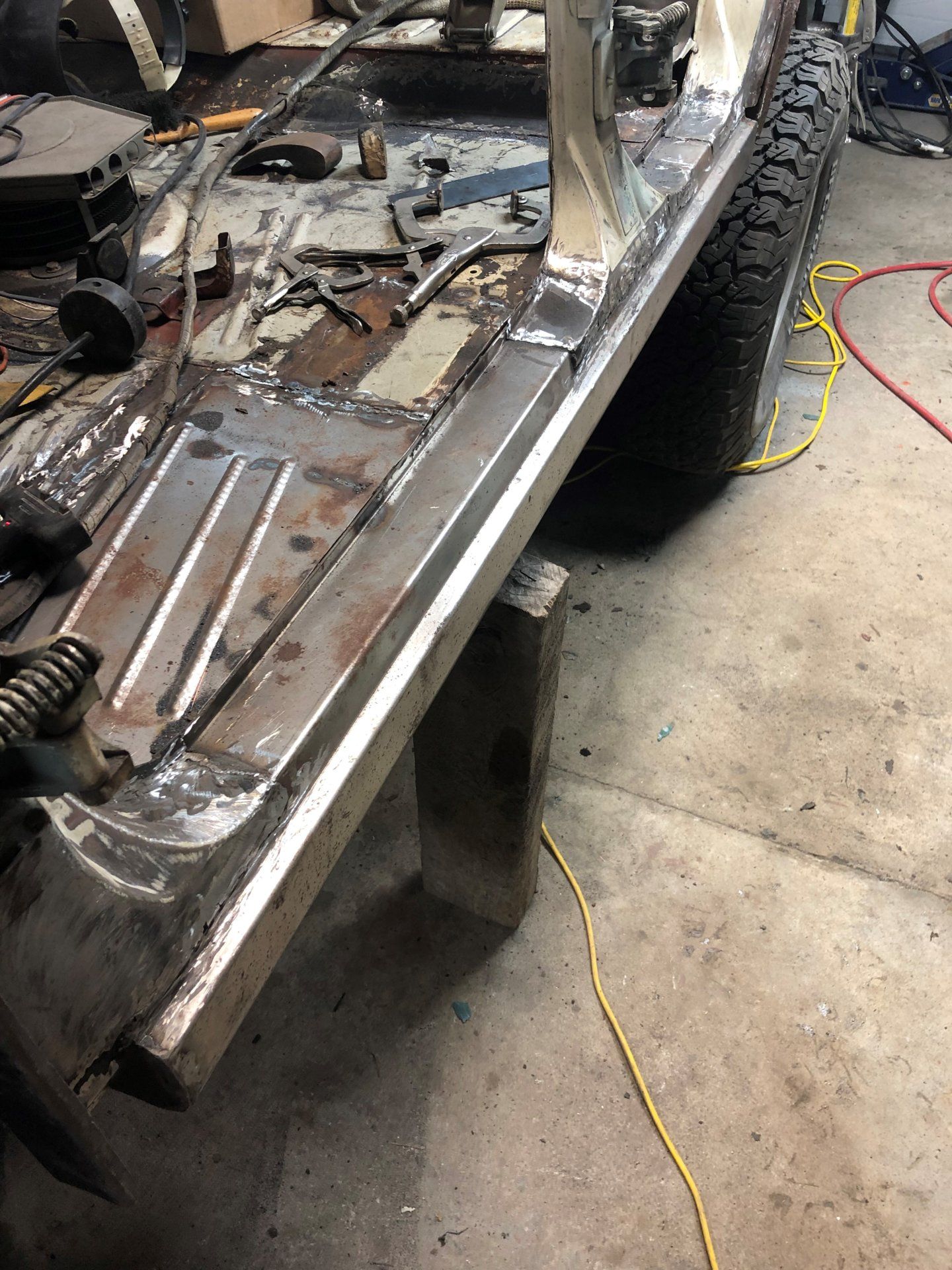

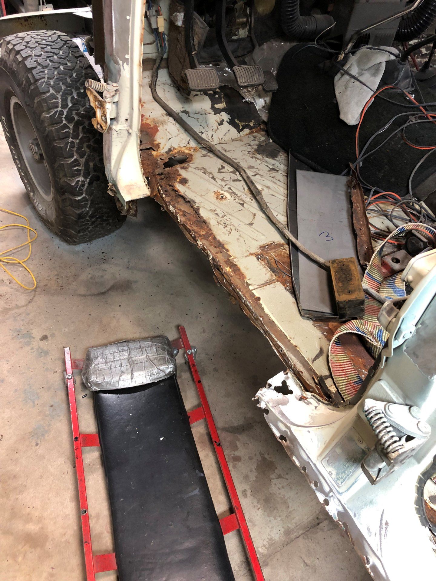

Driver's side rear. If you remember had the dimpled rear corner. Although not rusty figured it was best to take it out. Sorry for the bad angle pictures. Drivers side is tighter to the garage wall, can't step back to get quality shots.
You also see some rear sill work. Not sure if I have better pictures of the rear sill? Will check for another post.
