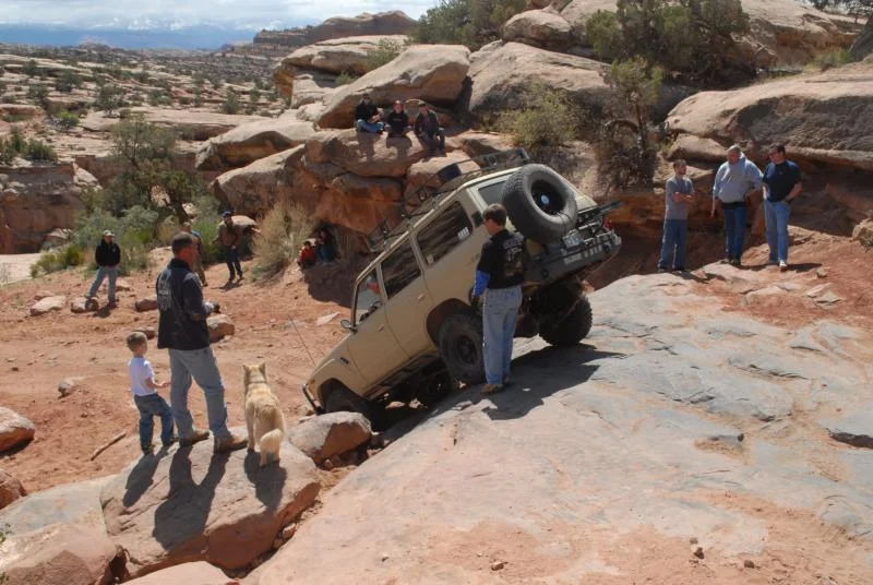

here is the one I just made ... BUT I think I need to lower it about 3 in what does everyone else run ??? lets see some pics
Looks good. Hope this helps.
If you're not concerned about departure angle you could lower it. I think it looks okay where it is though.
Maybe a little easier on the back if it was lower.

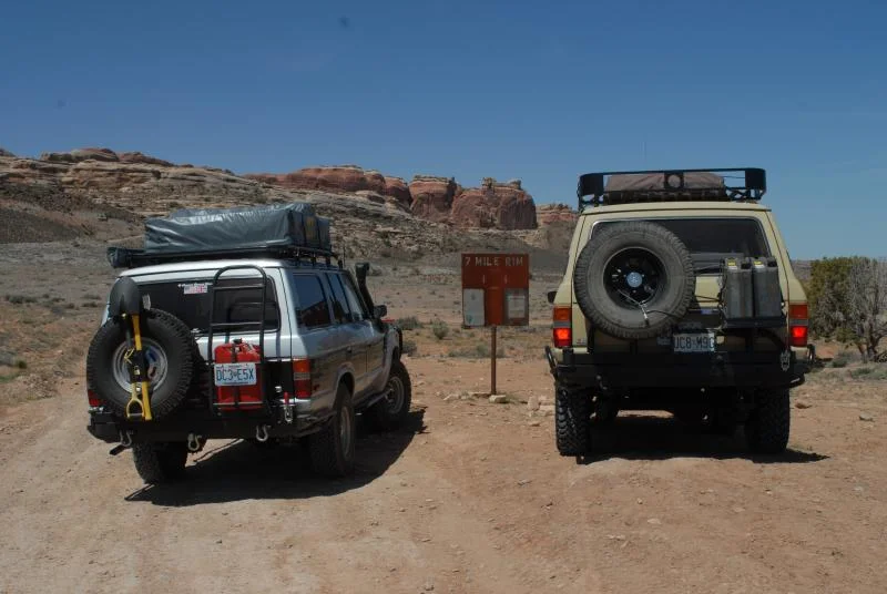

I am (33's). Ex was running 35's and a Alcan (?) lift on his. I didn't have any departure issues with my spare...although I did drag the bottom of my bumper on this little step....
Goodluck on you bumper build. It's a great looking bumper and it's nice to see the other ideas out there.

Hmmm mines on the other side than everyone else's.
You can never be too high lol (Unless you try to drive it into the garage w/o putting the tire down like I did today....).
