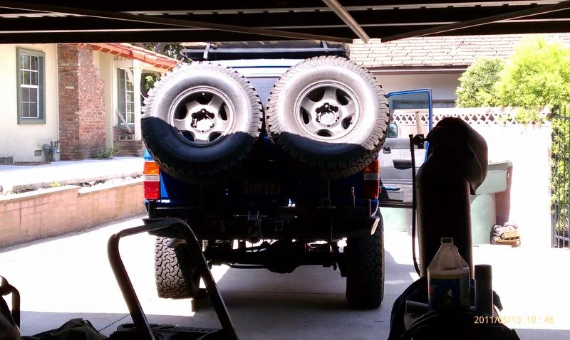

Im with Darwink and Esh. Higher is not bad and even with two wheels on the rear is totally doable..
I went high cause I wanted my signals to stay functional and did not want to move my Lic Plate from the stock location...
