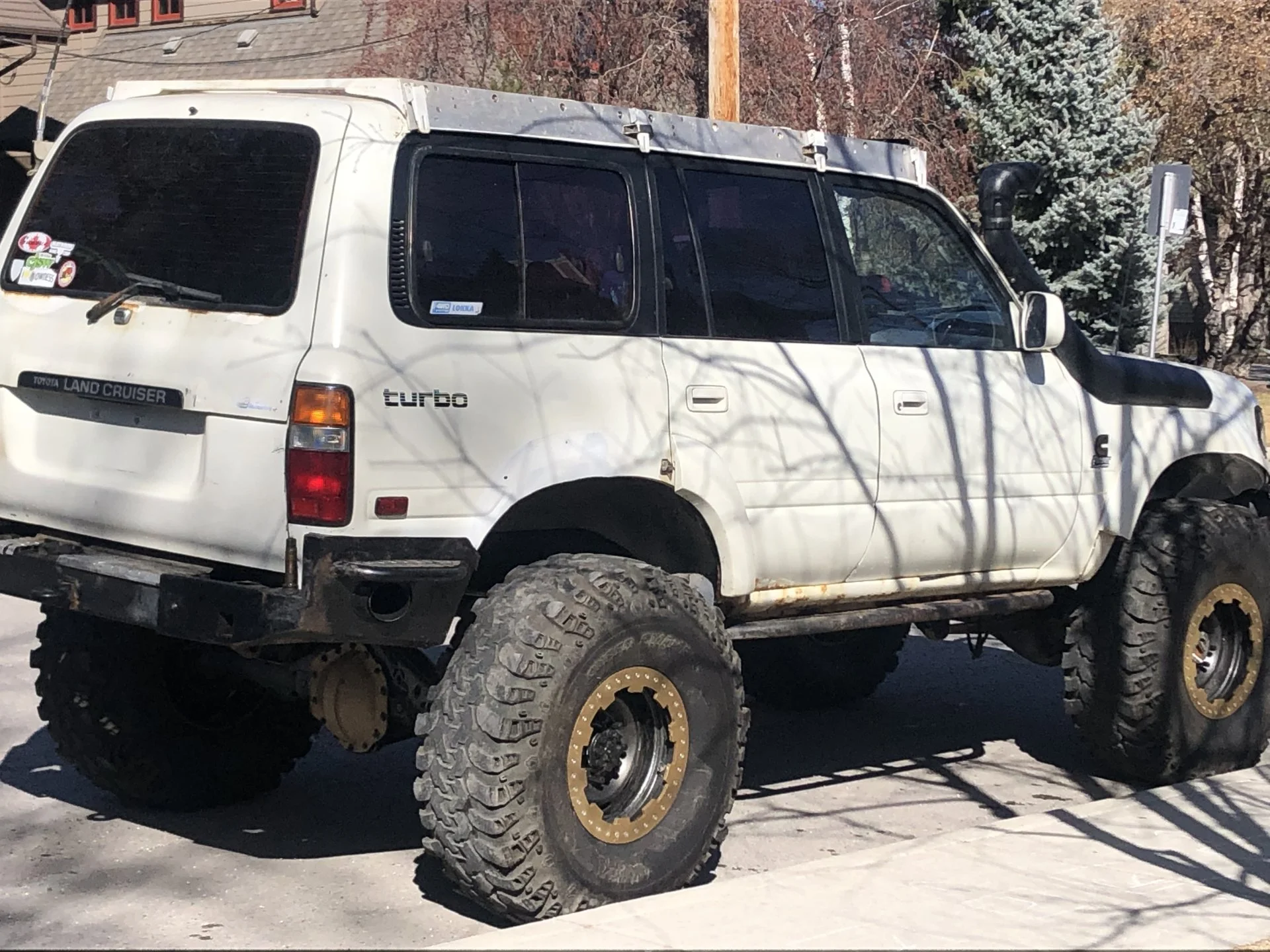

I did one, I’m sure I have some pictures, maybe in my ultra low roof rack build thread or the Cody’s white 80 rebuild thread.
If I did it again, I’d cut out the crossmember and weld in a structure to the frame.

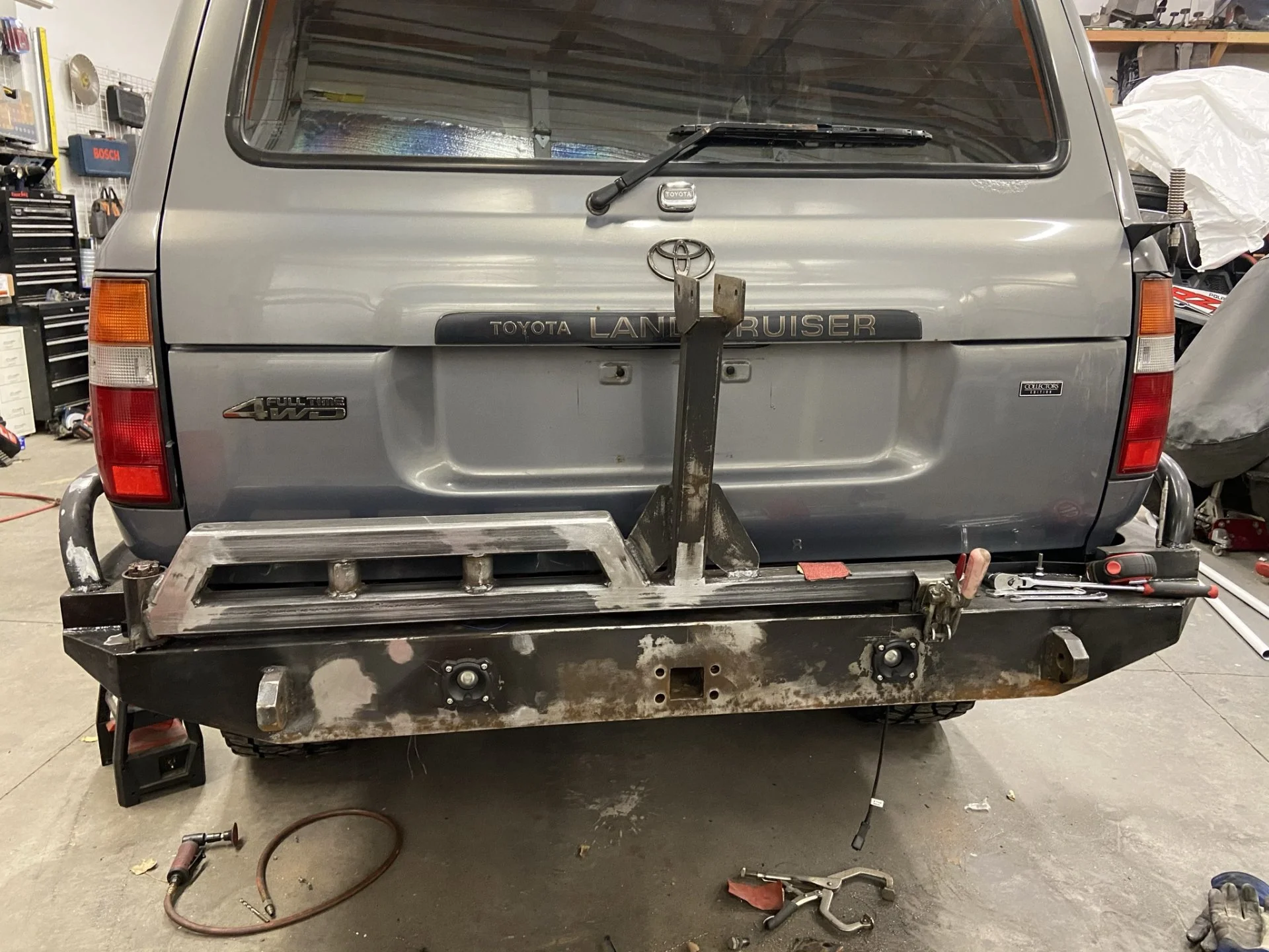

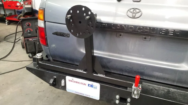

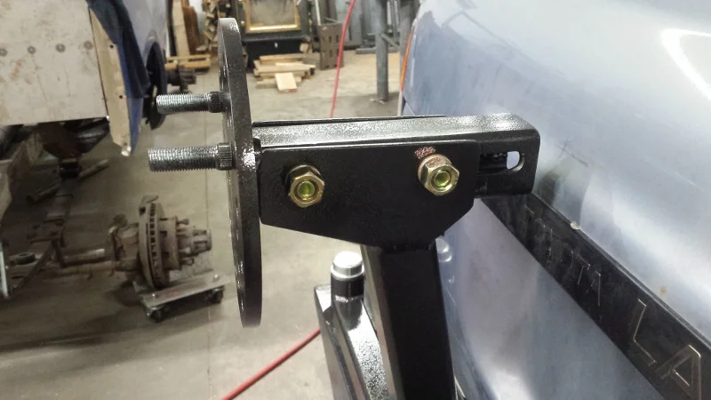

When I did the rear with swingouts I cut a square hole in the factory crossmember and welded in receiver hitch and did some triangle gussets.
Also changed the rear aluminum step on the bumper so it folds up, easier to get at the hitch pin ten climbing under the truck.

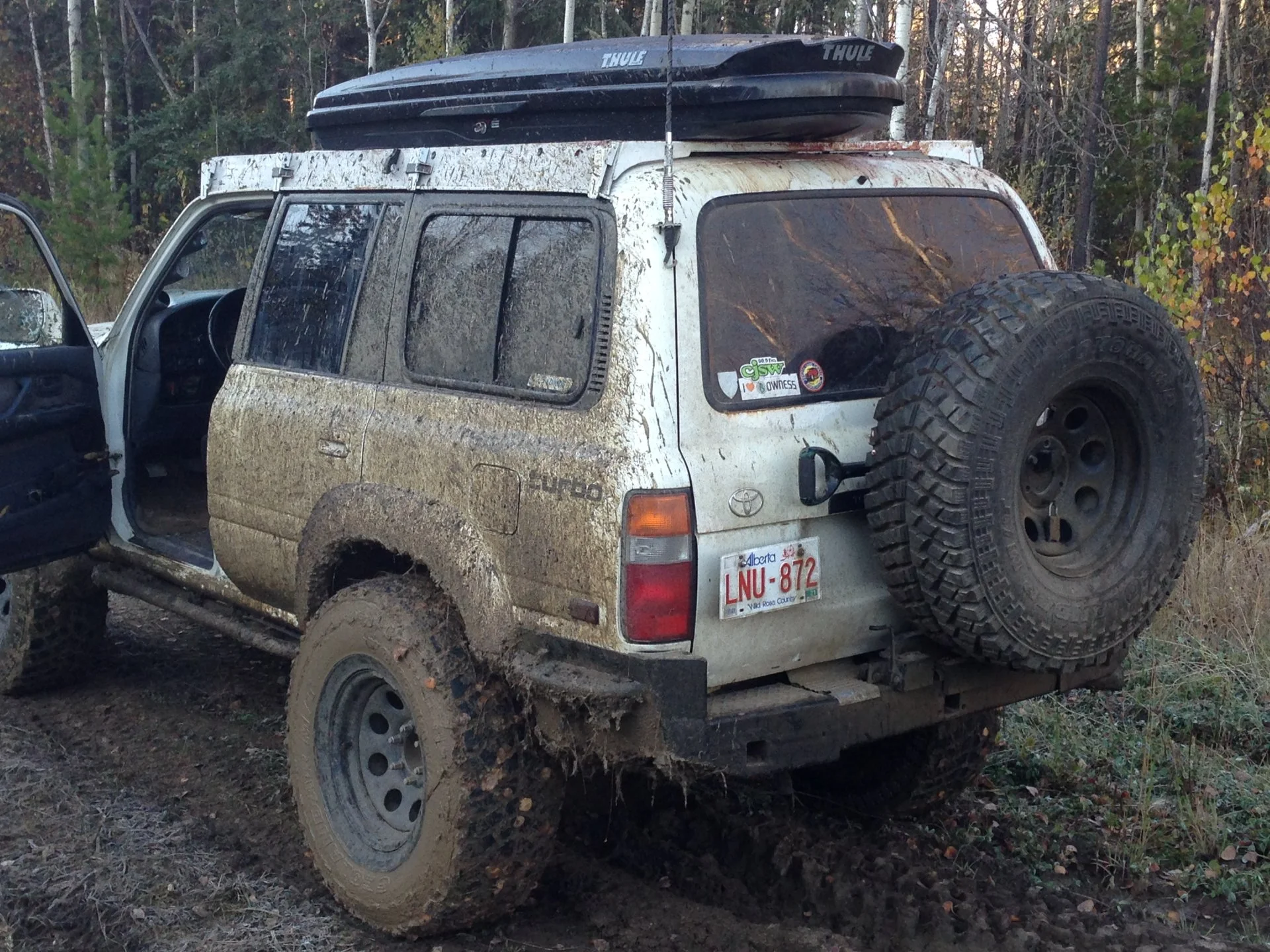

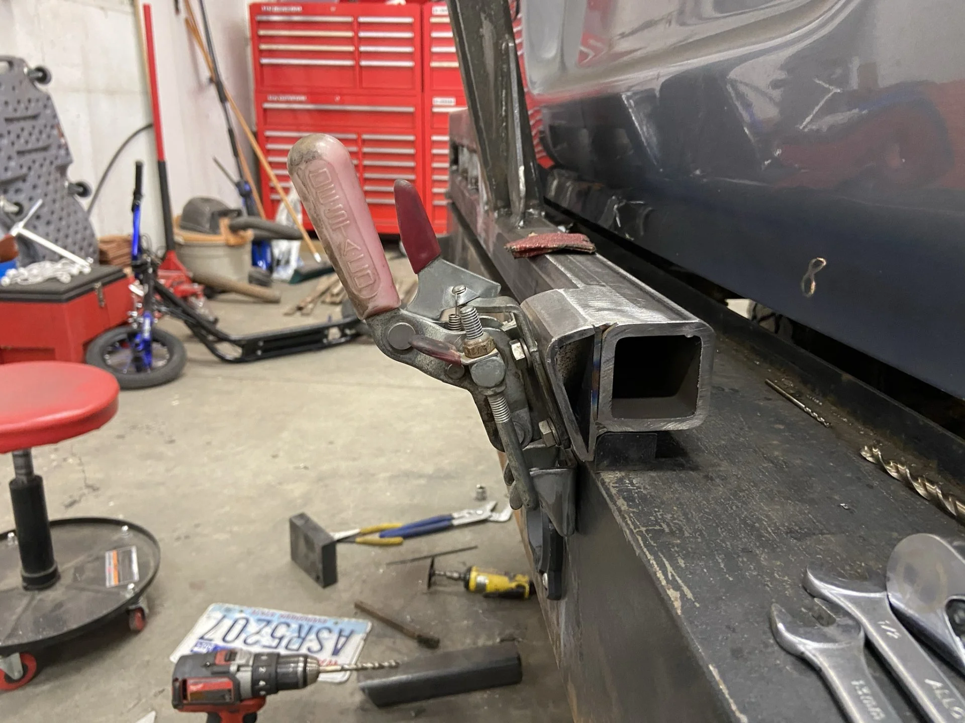

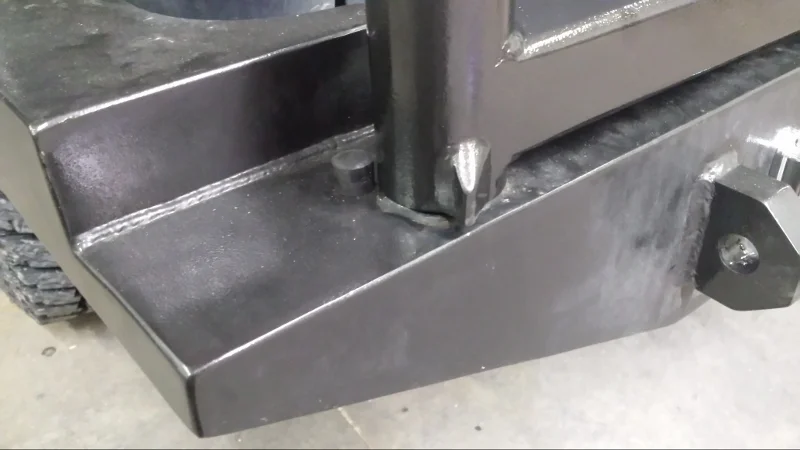

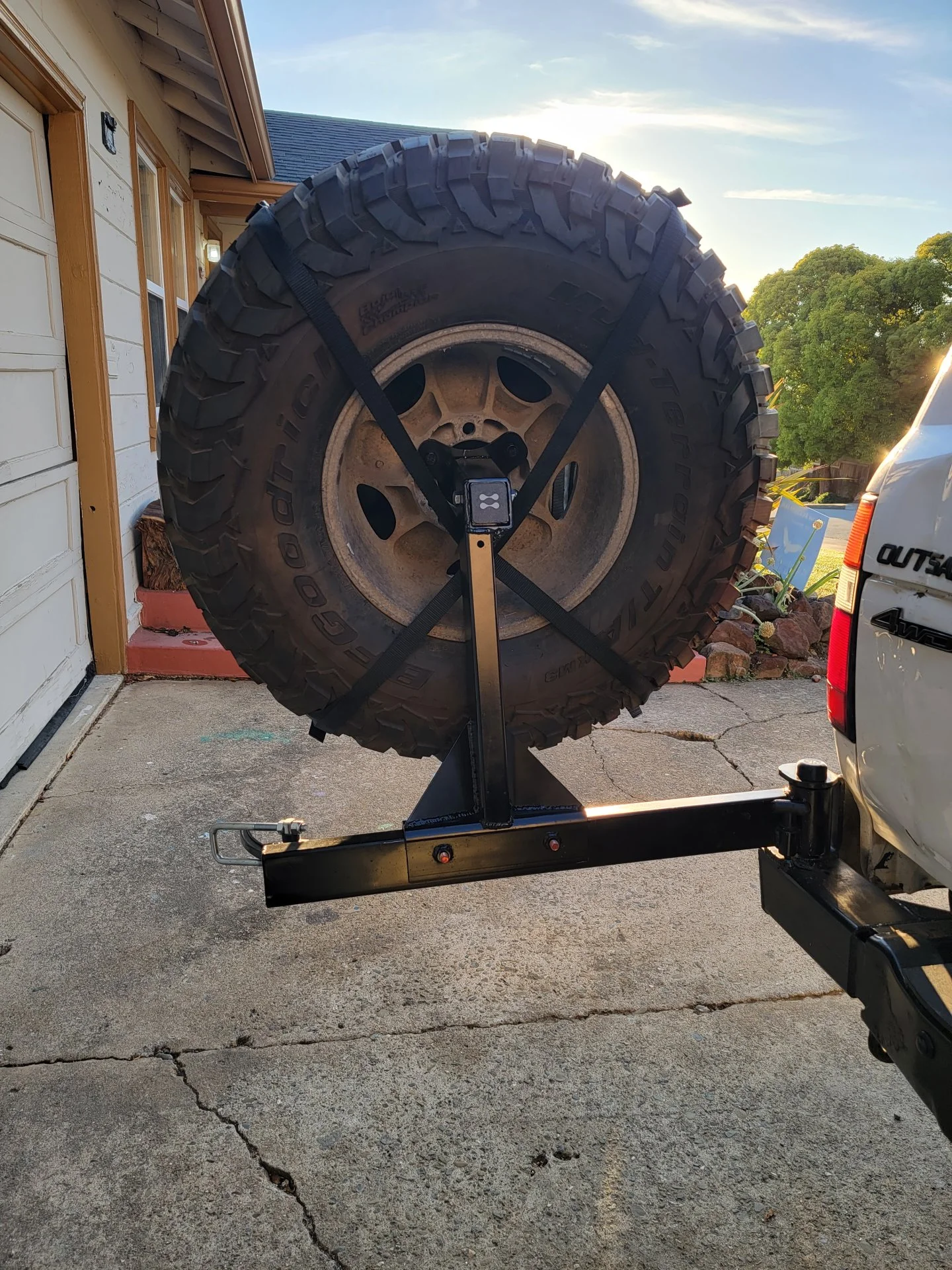

Herre's what I did. Used the spindle mount from Ruffstuff.
More details in the thread linked in my signature or here Custom Rear Plate Bumper - https://forum.ih8mud.com/threads/custom-rear-plate-bumper.873429/
I built it one way the first time and rebuilt it a little later when I decided to center the tire. Either way worked fine and does not move at all. The best thing I did to it was to angle the clamp that holds it closed (last picture). It makes latching and unlatching effortless while still holding the bumper tight.

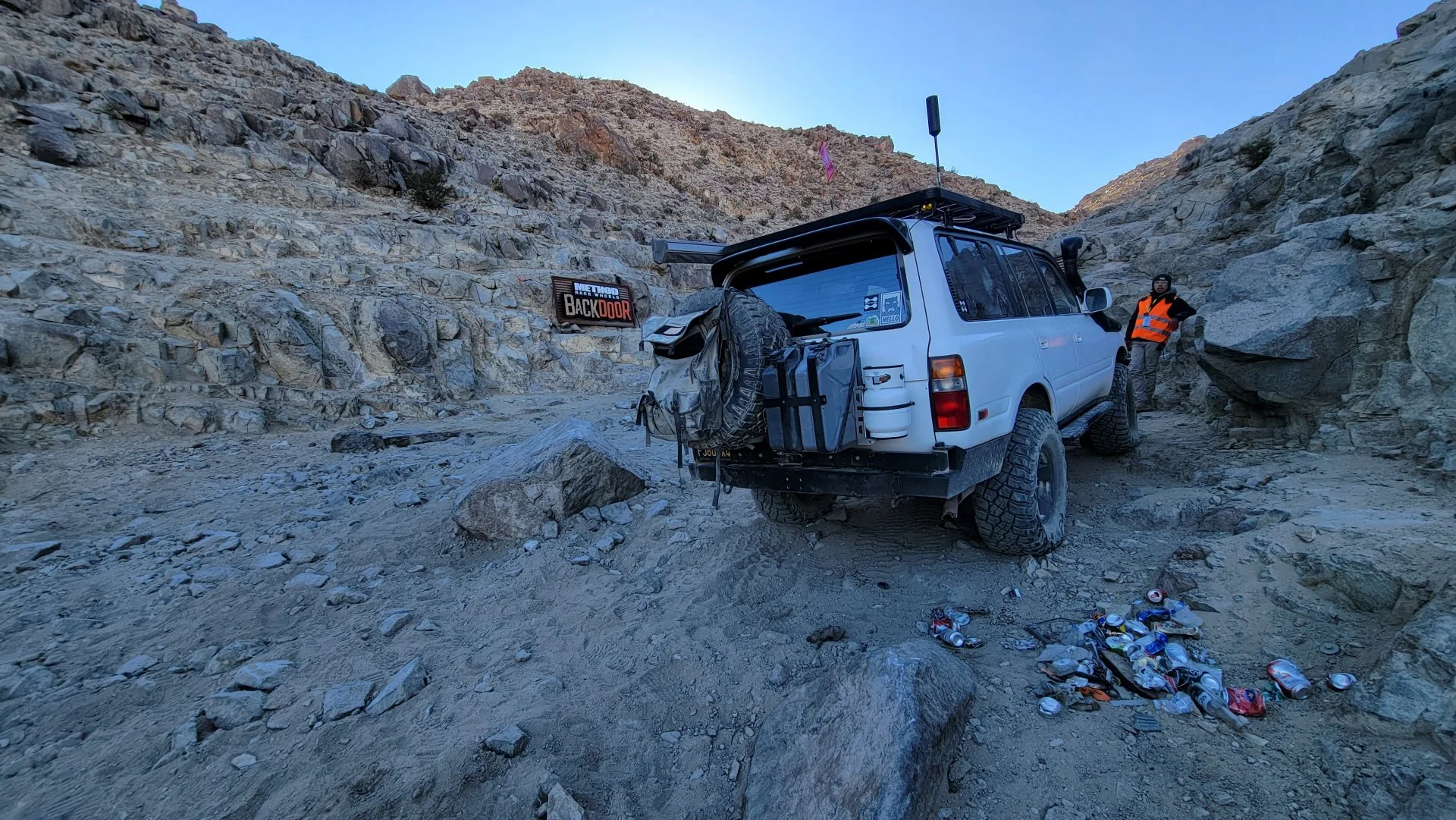

That's all the trash we picked up at Backdoor, we were running recovery for KOH.

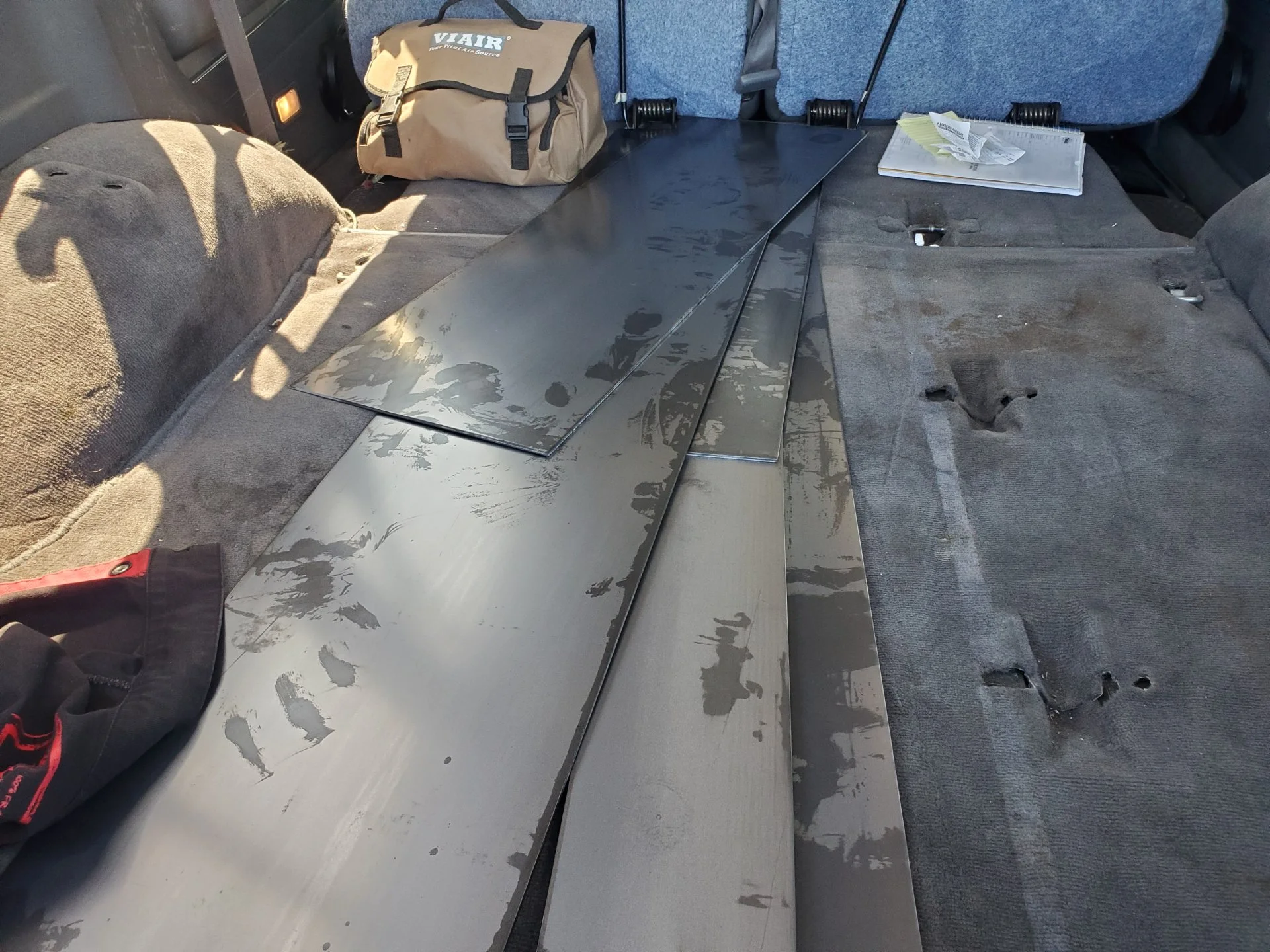

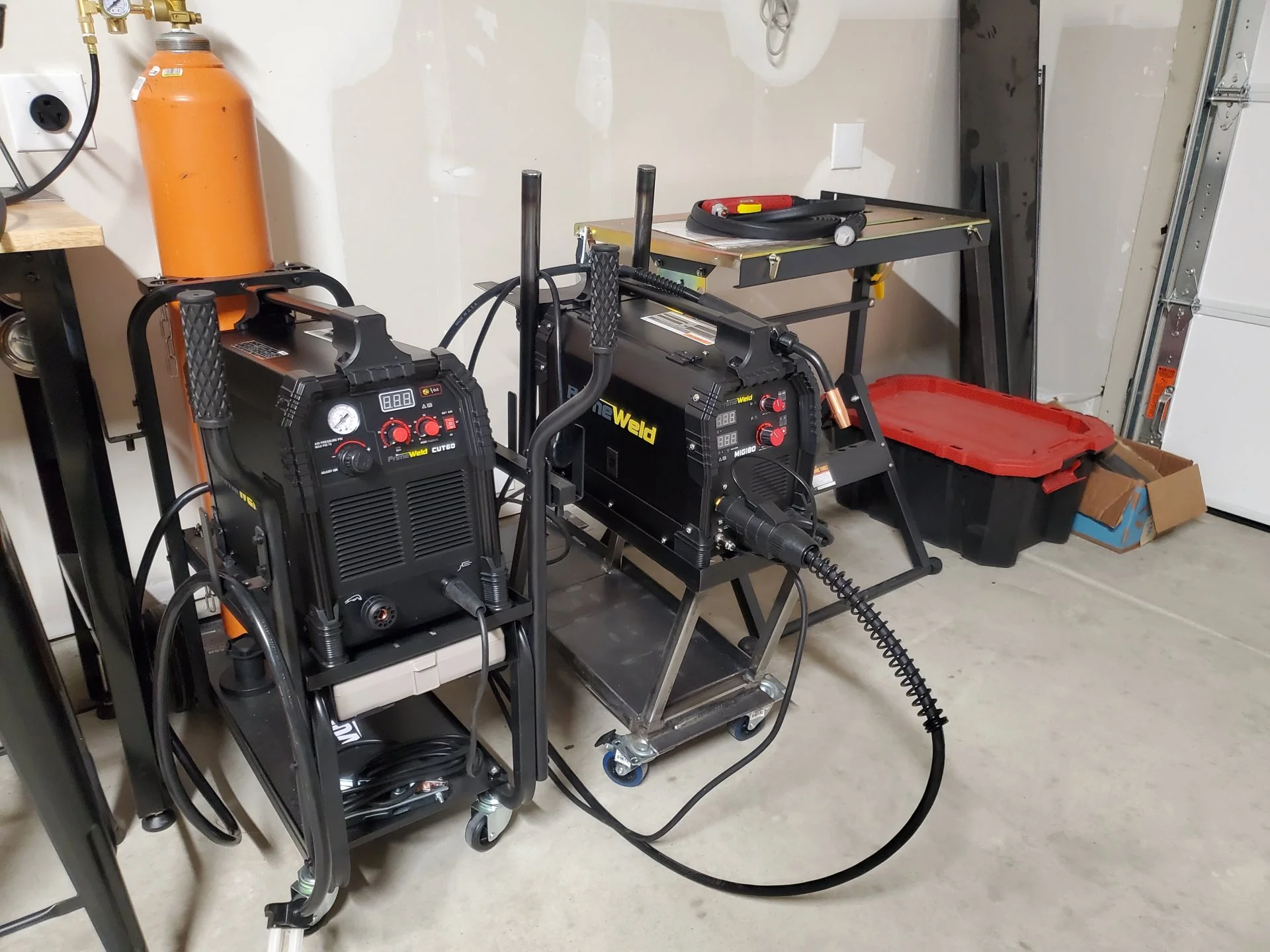

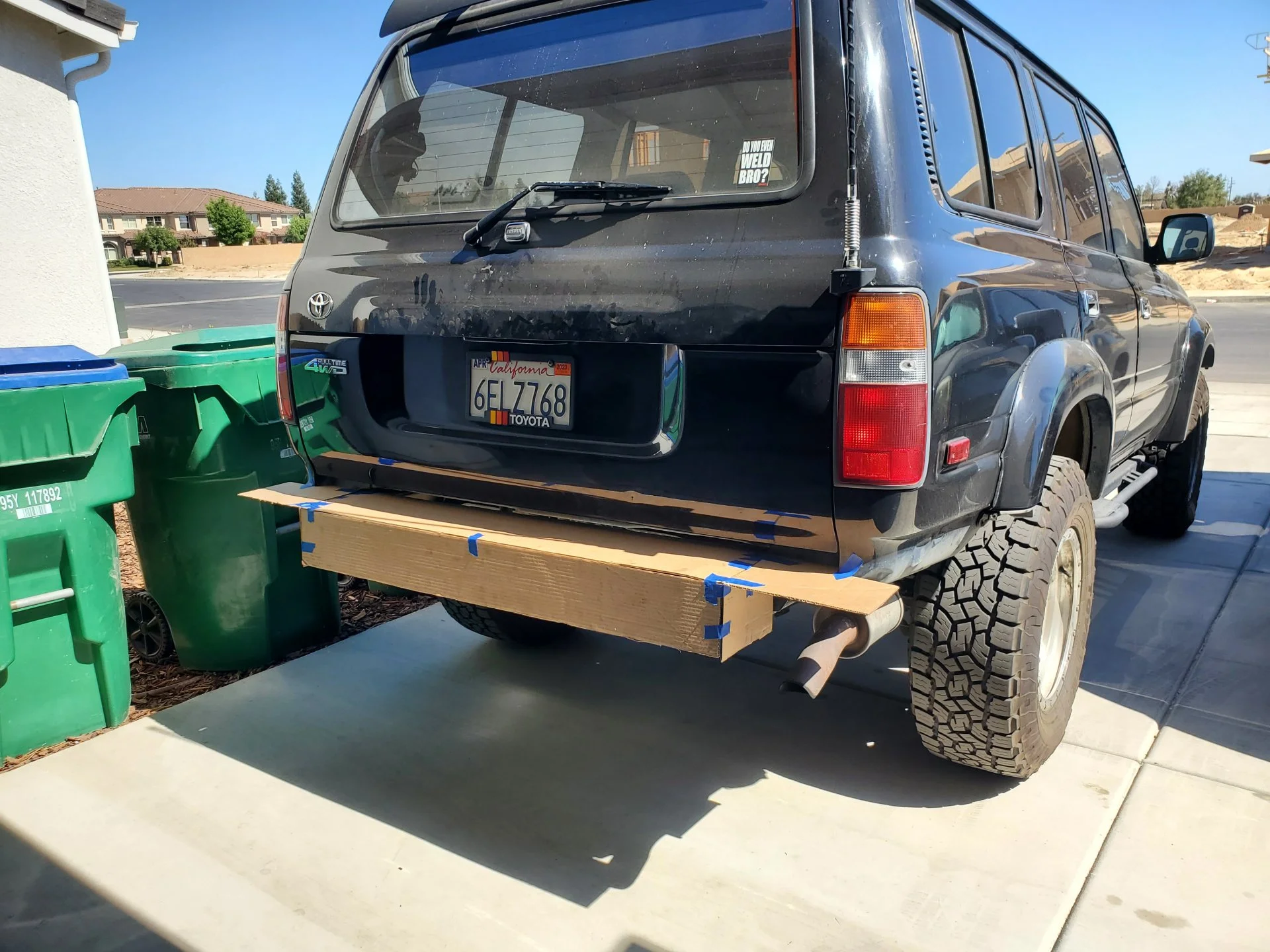

Just bought a welder as well as a plasma cutter. Still need compressed air and some 75/25 (I prefer solid wire) but worst case I'll weld it up at work. Also bought over 15 sq ft of 3/16" steel (not to mention I have a lot extra from other stuff).
Been super hot outside so I spent a short bit making templates. Still got more to do!
