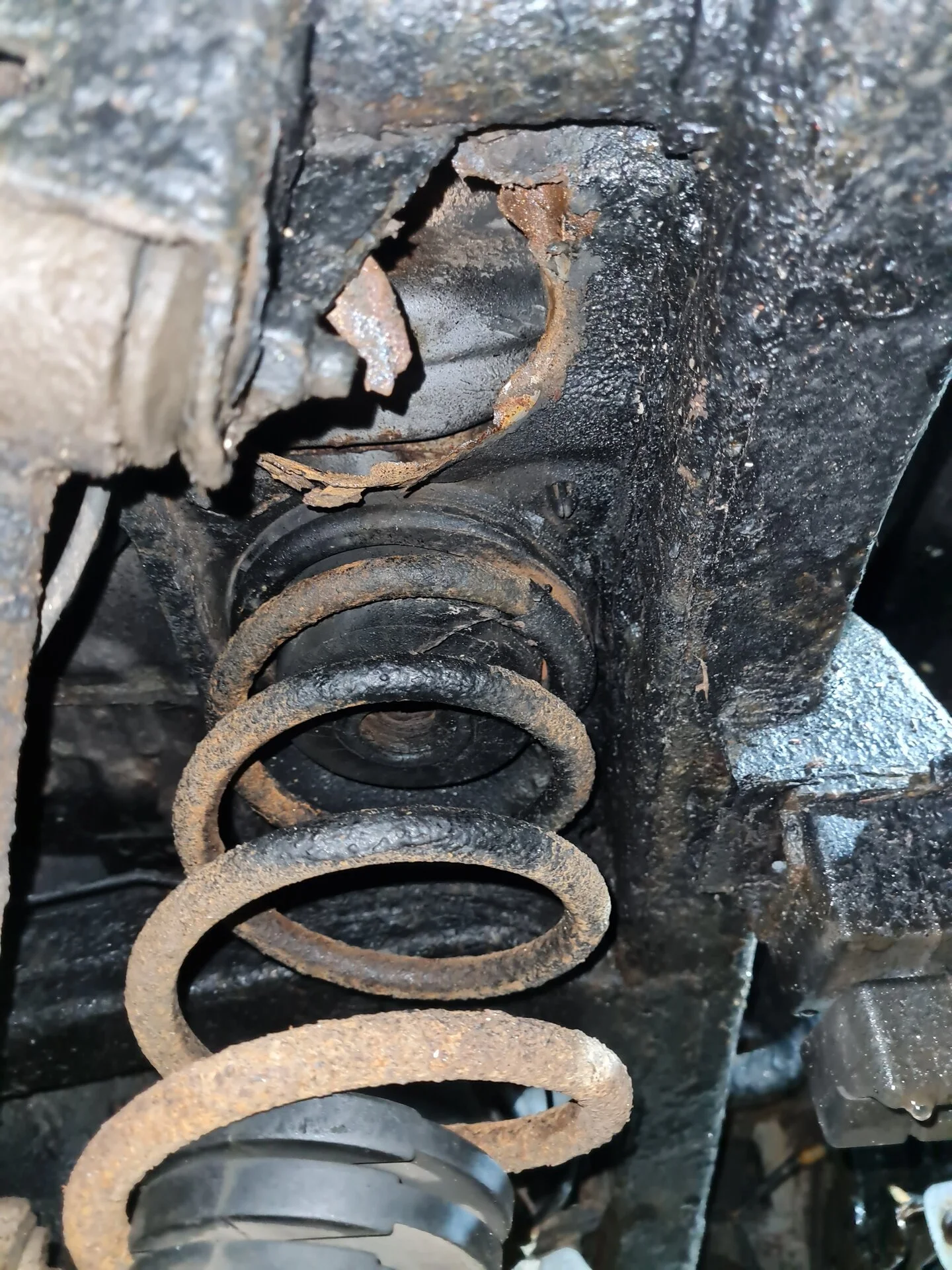

Hi all.
I'm wondering if any UK guys have fabricated or had someone fabricate the rear passenger side spring and shocker chassis mount. It's been pretty rusty anyway but a road bridge on a single track road snapped underneath me last week and either at the time or being recovered its broken away from the chassis. I've contacted several 4x4 retailers and had no joy.
Wondering if someone would even pont me in the right direction. 🤔
From what I See in THE Photo , everything is rusty . A easy fix is to weld a 5 mm hard steel plate ,as base for THE spring. But expect other failures as rust never sleeps !
Do you mean base for the shocker? It's like a dome that's snapped. Yes it's rusty it lived 12 years 12 foot from the sea. Only a few bits that are still needing seen to bit this only happened after a bridge collapsed under me.
