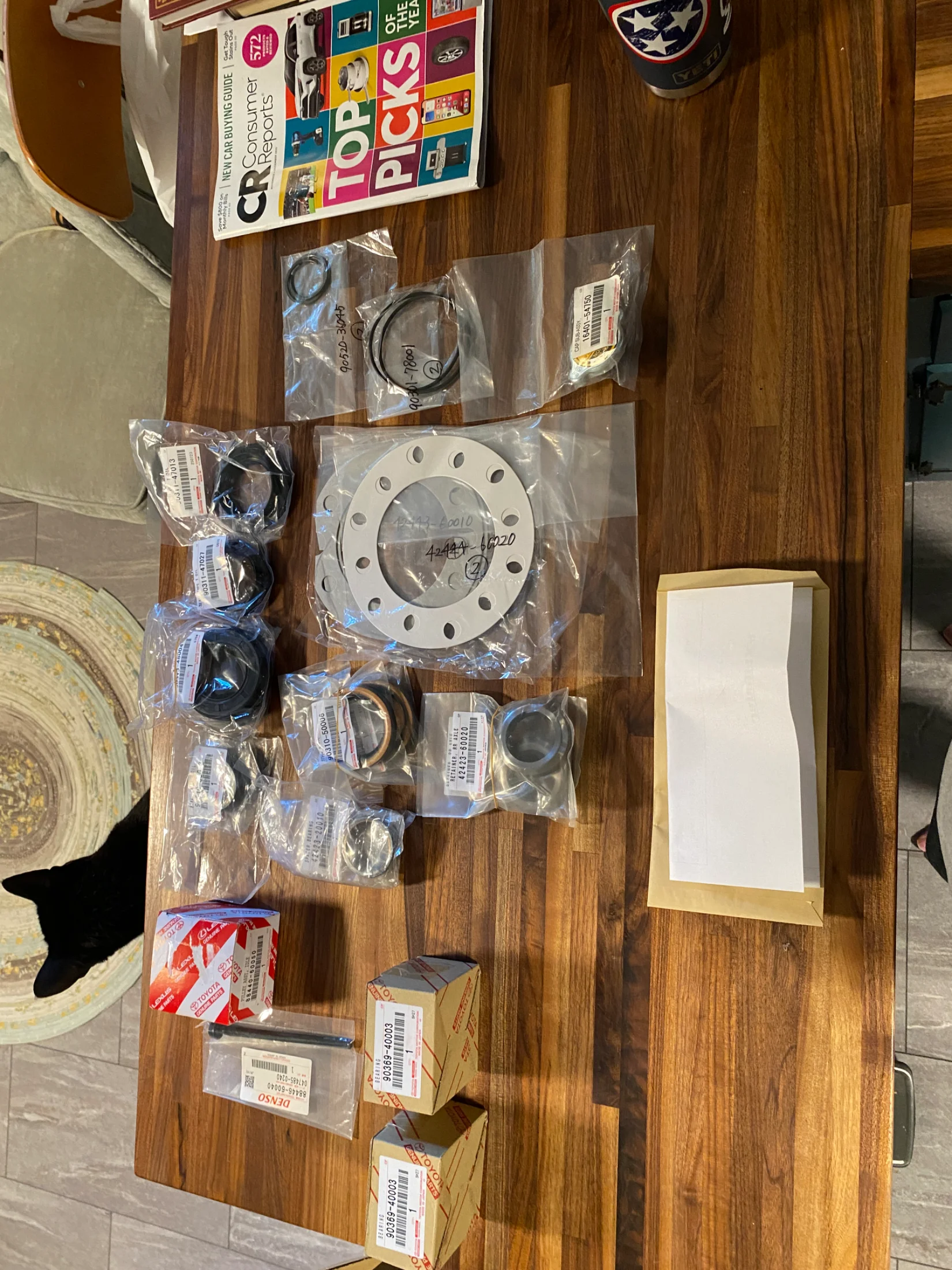

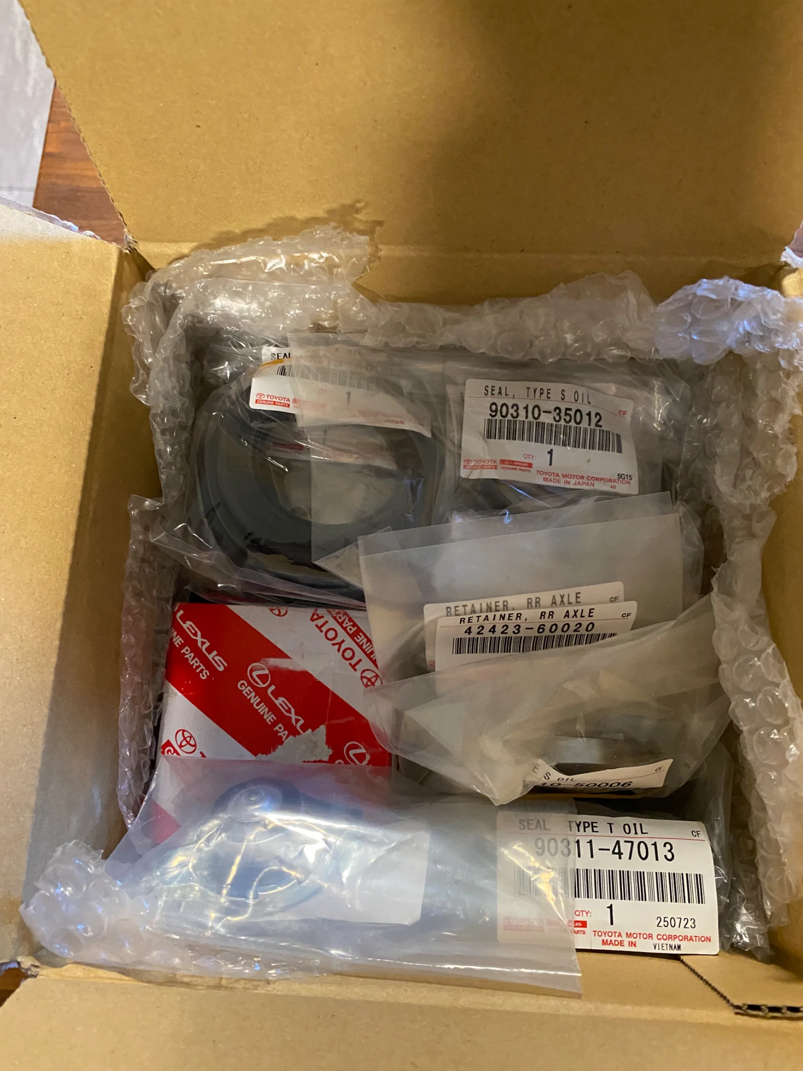

Got some parts for the rear axles today. Went ahead and purchased the bearings to go with the seals. Now I just need to find the time to tear in to it.
