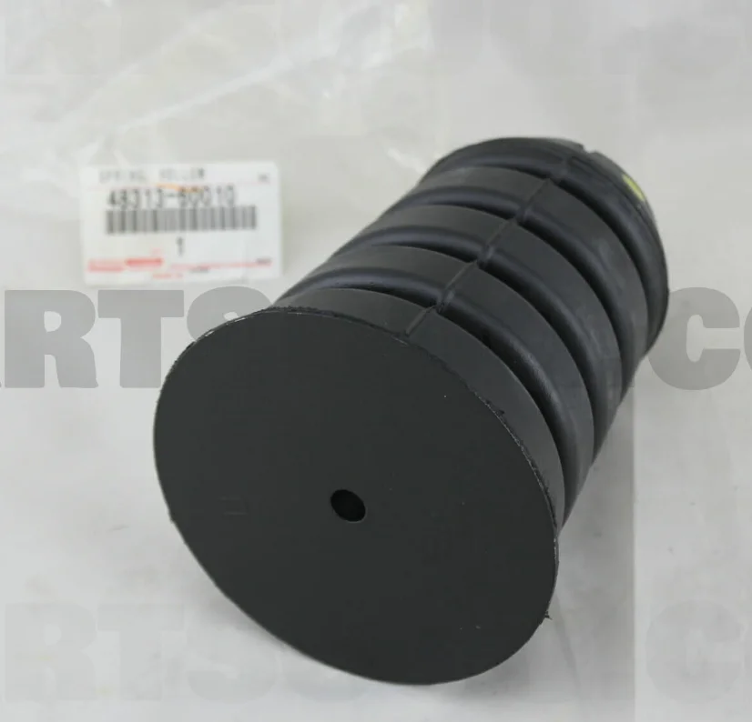

how worried should i be if the rubber isolators that sit inside the rear springs fell out and is just sitting inside the spring at the moment... and how do i fix something like that?
I mean, pull spring, replace, and put back spring?
The question is why did they fall. The upper spring buckets can get rusty, from memory, it is only 2 studs that hold those on.
yeah my lc is a little rusty mostly body but that spot for the spring is my only concern as in structurally concerning.
Looks like it is a single bolt that holds it on.
4831360010 and 9011908834
