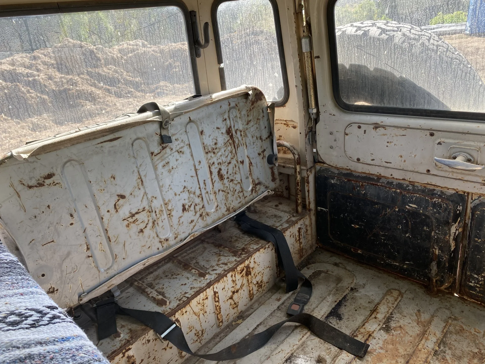

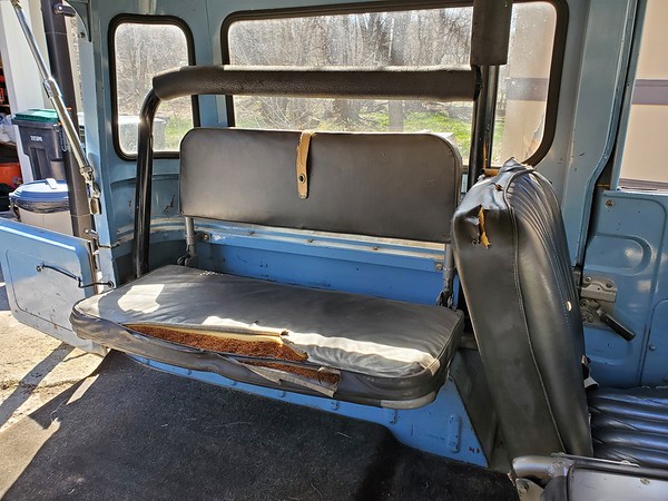

They should be the length of the wheel well. The short seat came on later model 40's that had roll bars, the early trucks no roll bars so the seat frames were longer. Here are what the seats in my '69 look like:

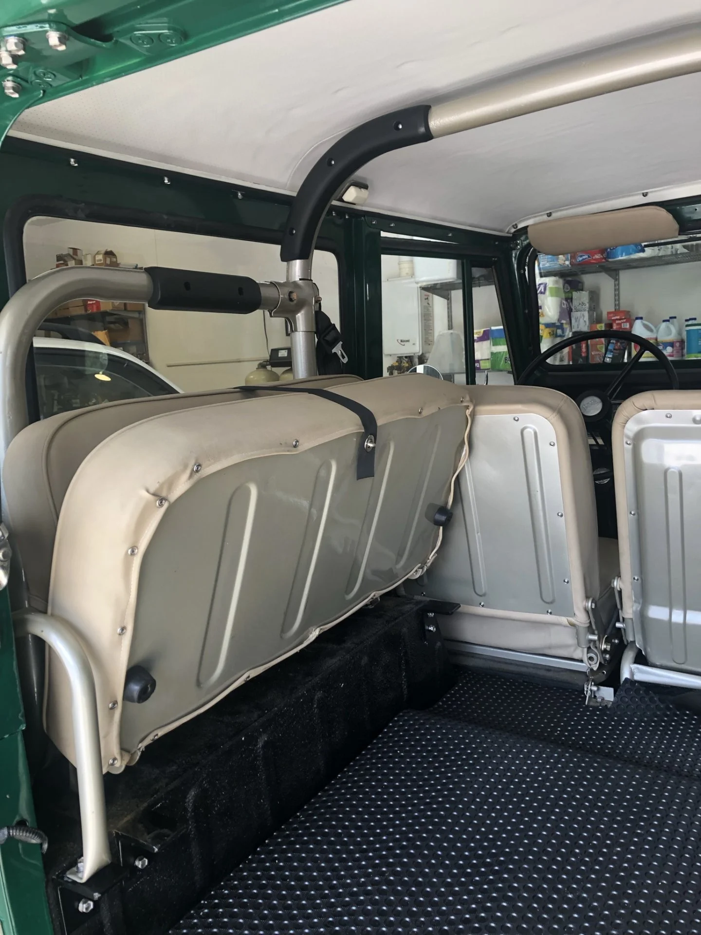

Here's a pic of my 69 setup. PO claimed this is a dealer installed rollbar with the wide jump seats. His buddy was the original owner.. The dealer must have sawn the arm rests off to make the rollbar fit, but its one of the few setups that works with the wide jumpseats. With all the dealer paperwork was included the install instructions from the 60's.
I reupholstered the seats last summer. Still trying to decide if I'll put the rollbar back in.
