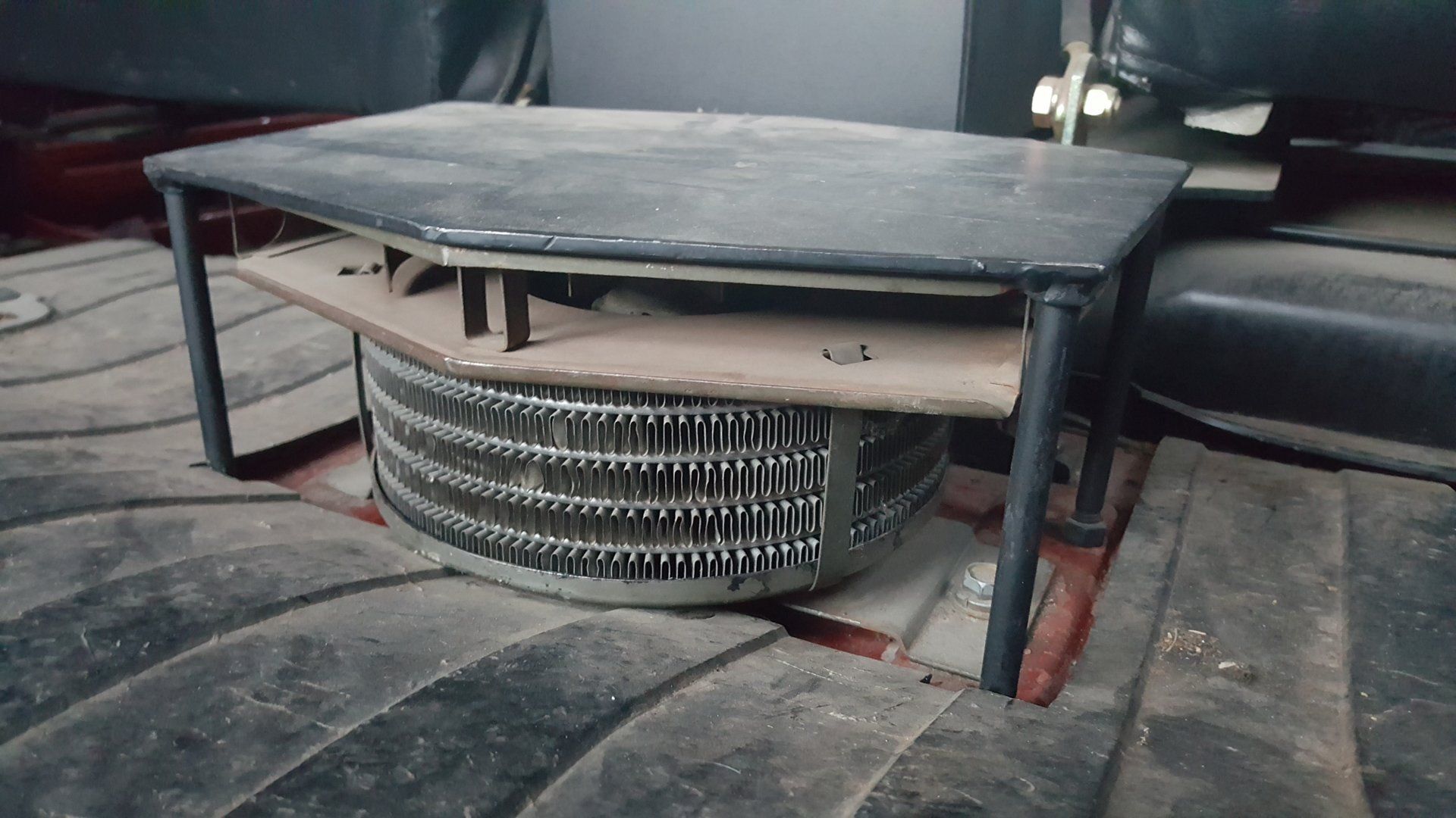

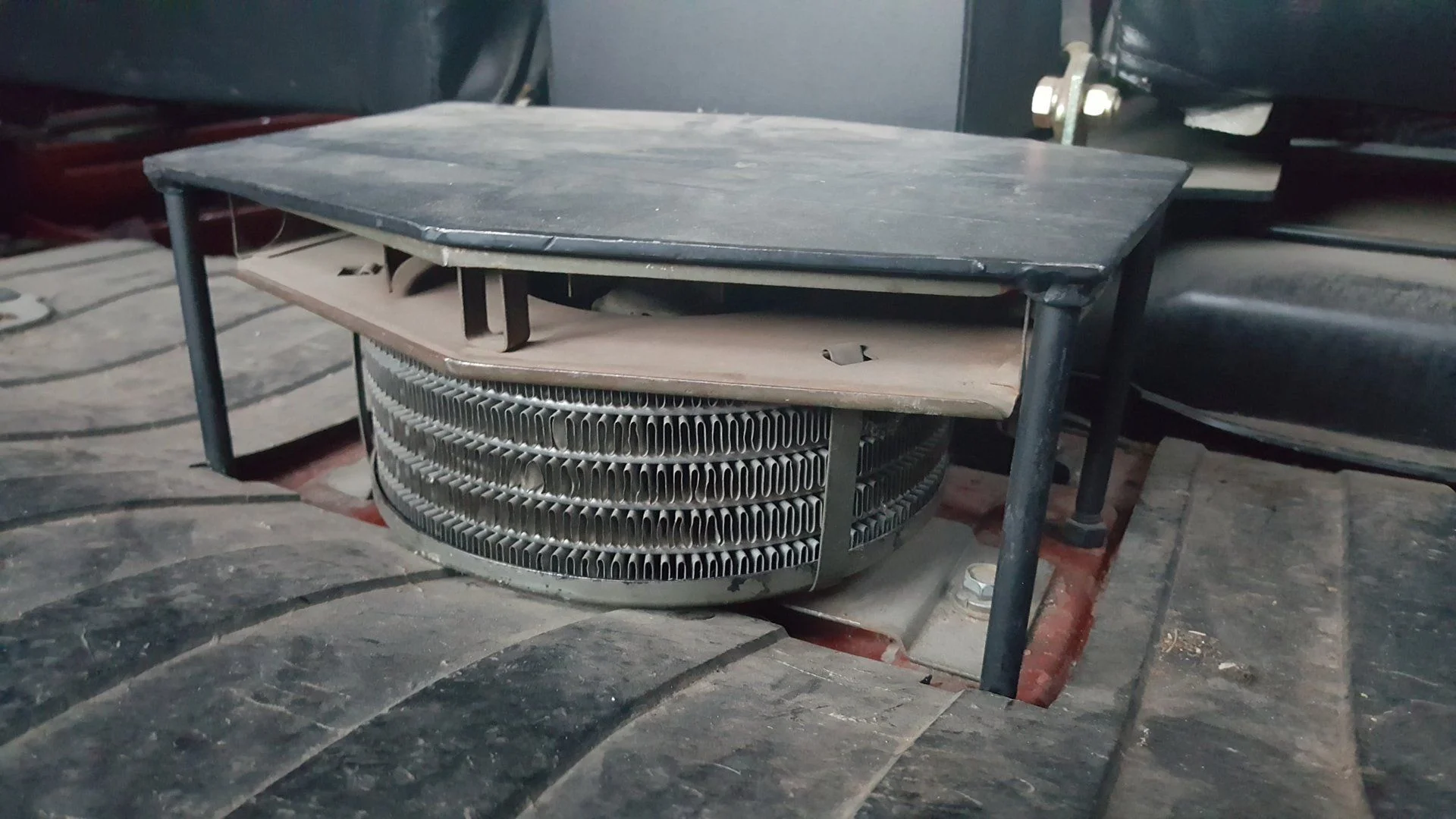

Here is a picture of the rear heater in my '73. As you can see, my Dad made a metal step/cover over that has lasted over 45 years and through 7 kids ( I was/am a big kid :)). I have a CCOT center console (much like a Tuffy) and it works great. Just a thought...

It would be nice to first secure a console, that way the fit parameters would be dictated by it. Just as a thought...maybe the OEM heater could be used. It does have a relatively small footprint which is shallow. Maybe it could fit into the bottom of the console lengthwise. Cut some ports in the rear bottom, maybe install some expanded metal on the inside to prevent large debris from getting inside.
