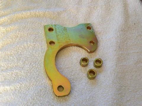

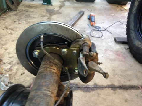

TSM is the company I bought mine from. The kit included the bracket, caliper, SS lines and rotors, I went with upgraded rotors.

Disc's are modified Chevy truck, thicker mounting surface than drums. That with aftermarket wheels required longer studs too.
OK - that's good info for someone. TSM must be the only place to that offers setups for land cruisers.

Check out Sky Manufacturing also for RDB conversions. That who I used...
