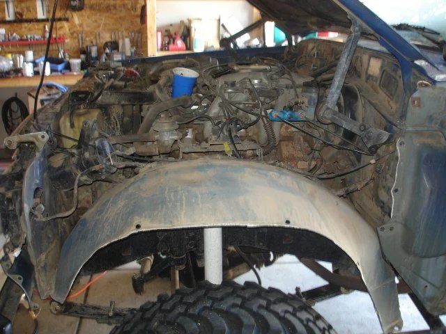

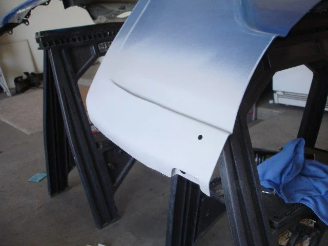

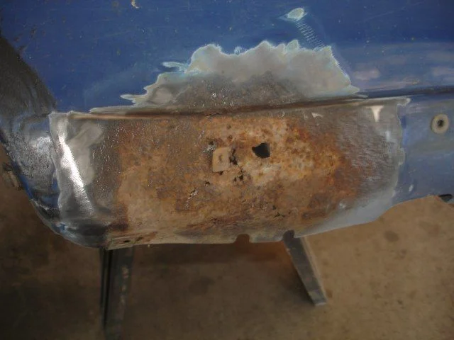

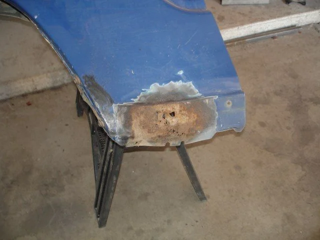

Got the DS all but finished...Still have some more weld filling to do on the rear 1/4, then some bondo and primer, then the liner!
I did have to pull the front fender to get at that pesky rust on the lower corner near the door...
Here's updated pics!
Chicago

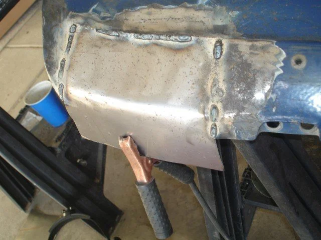

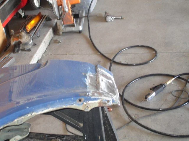

The repair!

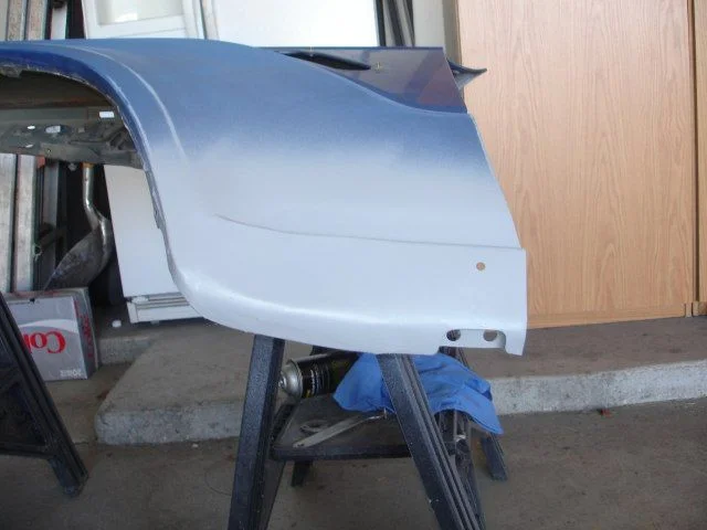

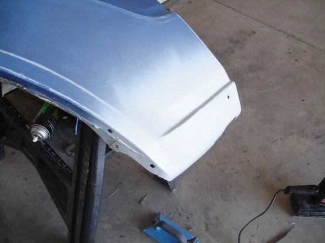

The finish!

Nice progress, Keith! That'll look perfect after some bedliner. You sir, are a quick study.
It doesn't seem you are getting warpage while running somewhat long beads for sheetmetal. That's great heat control you've got. I personally do nothing past a long series of tacks, pausing, and jumping between each area to avoid overheating the panel. Good work.
I see you've taken a liking to the HF air saw, as well, eh? For me, it beats an air grinder and cut-off hands down.
not too shabby... How big of a pain in the butt are those front fenders to pull. I've got some major surgery that needs to be done to mine. I wonder if it will be easier to cut on them off or just leave them on and cut?
Looks good, thats what I plan to do this summer. But why are you bothering with bondo to smooth stuff out when your putting liner over it and probably wont notice a difference?
cause he knows it is there probally.
I would do the same thing.

Thanks Wile E,
I havent noticed the warpage as much of an issue unless the part that Im doing is a small pach, then there is definately warpage in that confined space, but Im surprised what Ive been able to get away with. That 18G you recommended is the SHIZZZZ!
BrokenParts,
The fenders are actually quite easy to get off once you find all the bolts to hold them on...I obviously didnt take off the entire fenderwell cuz I didnt need to.
The bolts on the firewall had eluded me for some time...It took a bit of head scratching to find those. I think there are 5 or 6 there, also there are a couple of 10mm bolts on the valence and around the headlight brackets that stumped me...Id I had it to do over again, Id DEFINATELY remove the fender again. Its saved soooo much head ache and as I mentioned, once you know how the bolts are, its really a SNAP...It only took me an hour to fully reassemble the fender start to finish!

As Cruisinfj60 said...cuz Ill know its there...Ill kick myself if its F'd up looking afterward knowing that I just LAZED OUT and didnt take the extra time to make it look right.
Im a perfectionist of sorts...not to the extreme, but just enough to be anal when necessary.
