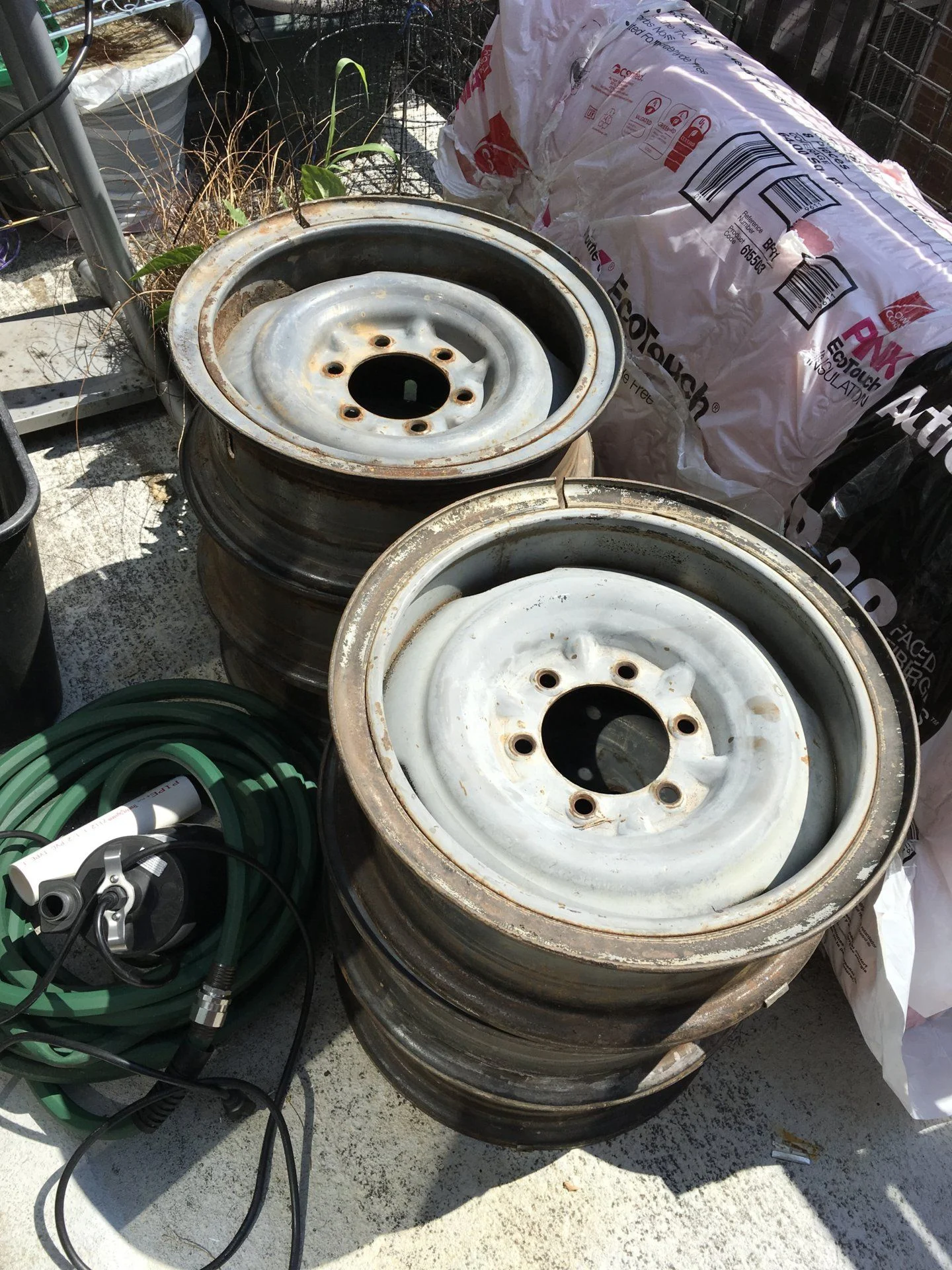

    Josh had a pretty cool HJ45 w/camper pop-top... didn't have a chance to take pictures of the truck as he was understandably wanting to hit the road. Thanks for the suggestions and relieved the issue was a relatively minor/easy fix.
    Since everyone likes pictures; I did receive 16 inch split rims for the FJ45lv (soon to be blasted & powder coated):
