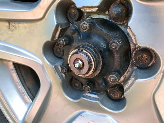

This is what is behind the dust cover on my parts rig. I’m assuming it’s not enough to exactly identify the axle but it does say something.

These installed yet. If so who drilled the rear hubs ?
