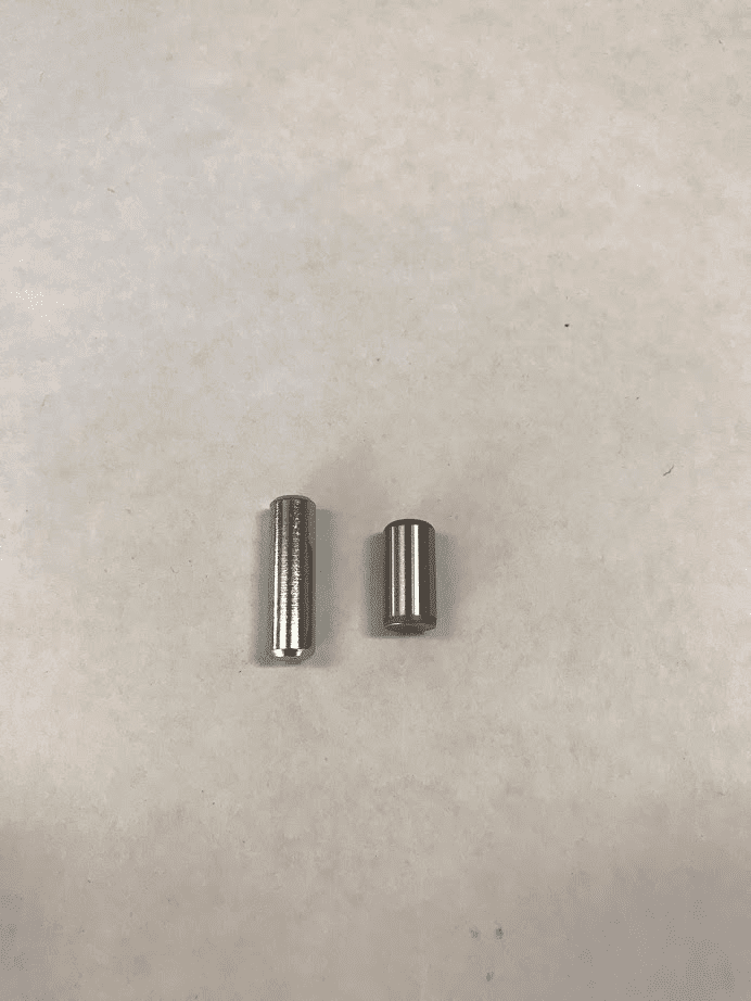

Can you check the length of dowel pins that came with your rear axle set. The ones in my set are 15mm or 5/8"

Sound about right, I measure .75/ in.

It seems to short to me, I was thinking they sent the wrong ones but you seem to have the same ones. Hears a pik stock next to RCV. I well be calling them.
